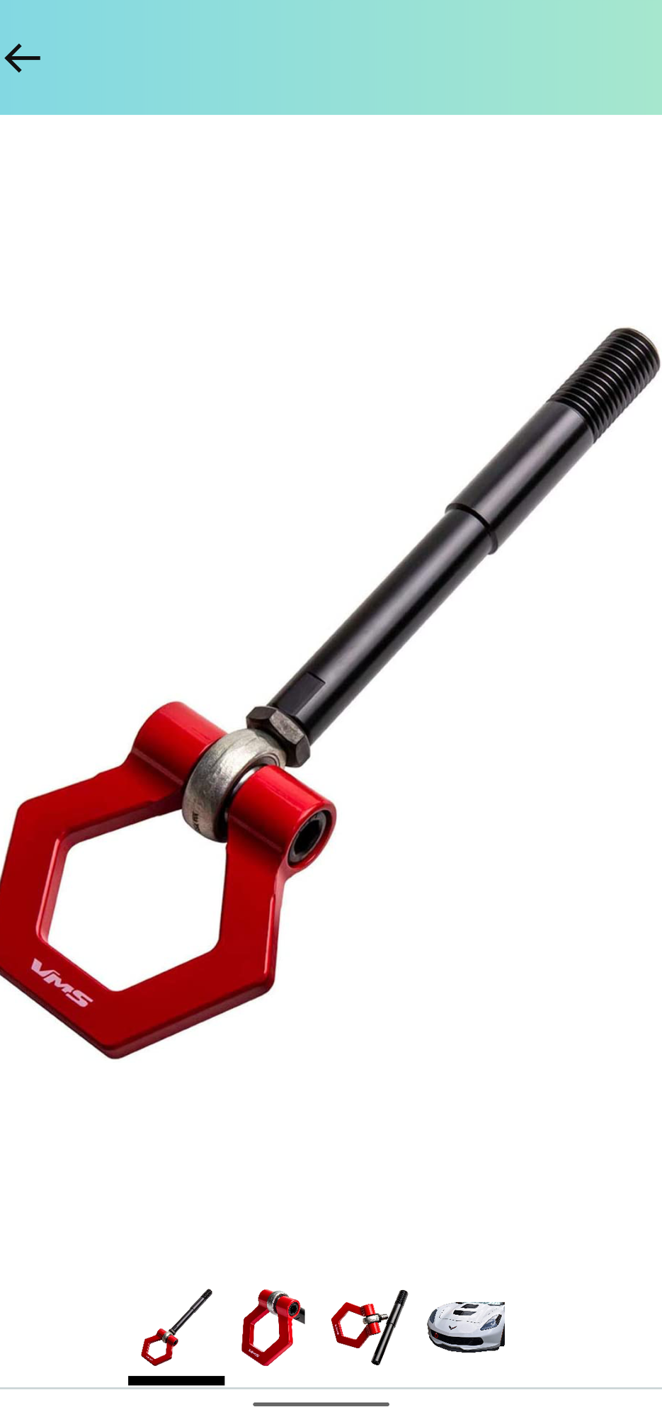

Hi guys.... I have a question. Are the tow hook receiver thread rear it will be fit and works with VMS tow hook ? It doesn't matter front or rear tow hook I just want to confirm about the thread .Any idea ?
Old Apr 9, 2023 | 12:08 PM
squirrelchew's Avatar
squirrelchew
Joined: Sep 2022
Posts: 1,202
Likes: 569
From: MSP
The recovery hook is M20x2.5.

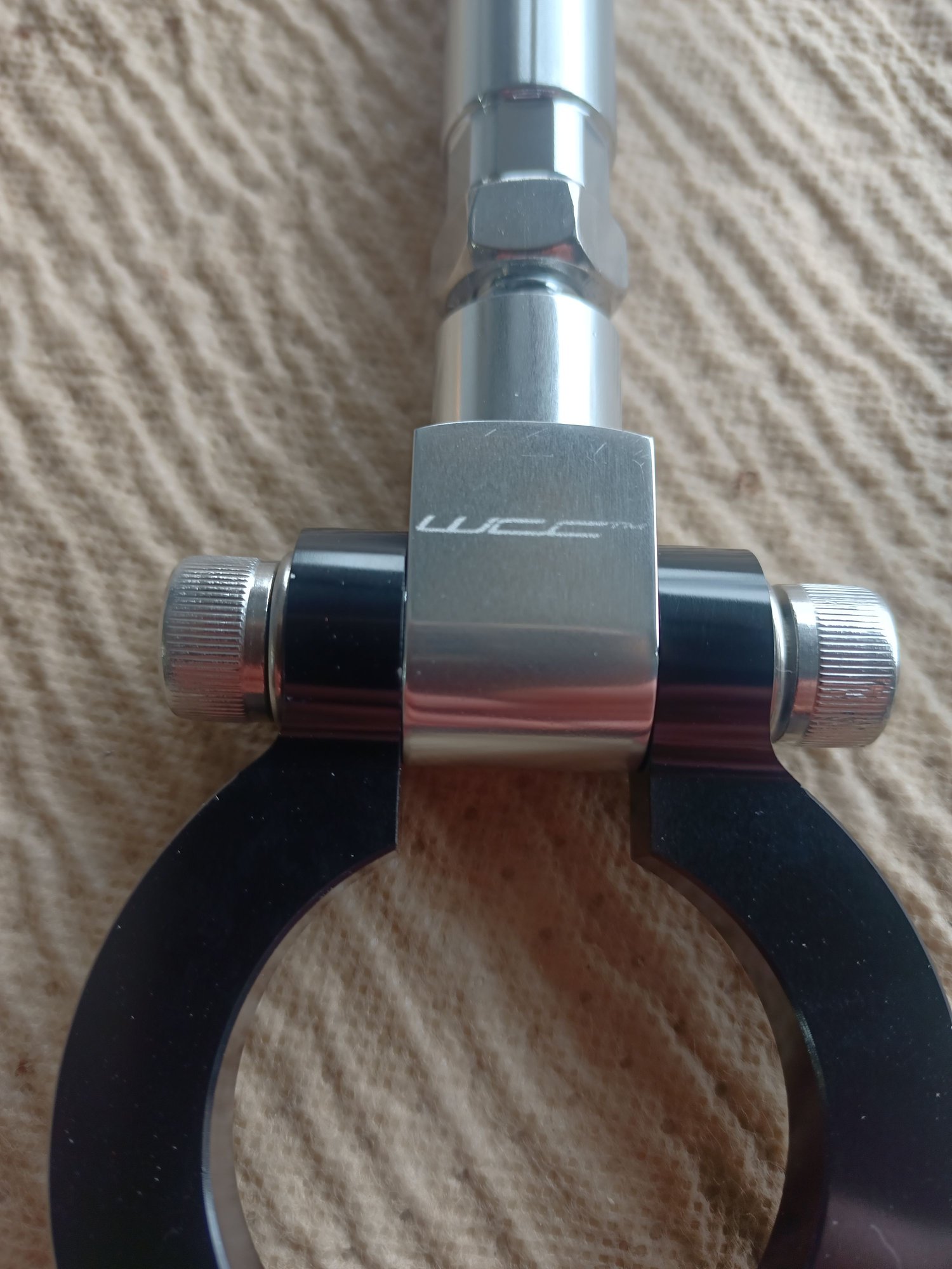

Okay guys so l buy this one from West coast Corvette did anyone owns one of these towhook ? I just want to make sure about the quality

Does the tow hook manufacturer provide a tow rating? I'd be concerned with the bolt shearing.
This is what the OEM tow hook looks like:
Besides being less expensive to create, they don't have bolts and swivel parts and aluminum to break.
that’s the exact ones I had fail. Do not use for anything but looks.
. There some tow hook they look exactly the same those .. those are SR1 performance for wcc can you please tell me from were you buy yours or which brand ? All lknew there is cheap ones broke easy look same as those ..
Old Apr 17, 2023 | 08:39 PM
BrunoTheMellow's Avatar
BrunoTheMellow
Joined: Jan 2015
Posts: 5,692
Likes: 1,451
as I said. I bought that EXACT tow hook for WCC. Those aren’t performance tow hooks, they are cheaply made with a very skinny neck where the swivel threads onto. That is where mine snapped. You may chose to listen or just risk it yourself. Probably would be fine for a little flat towing but trying to winch it onto a trailer and snap, there goes your car.
You are right ...lam going to return this one and lam going to buy heavy duty one ...
