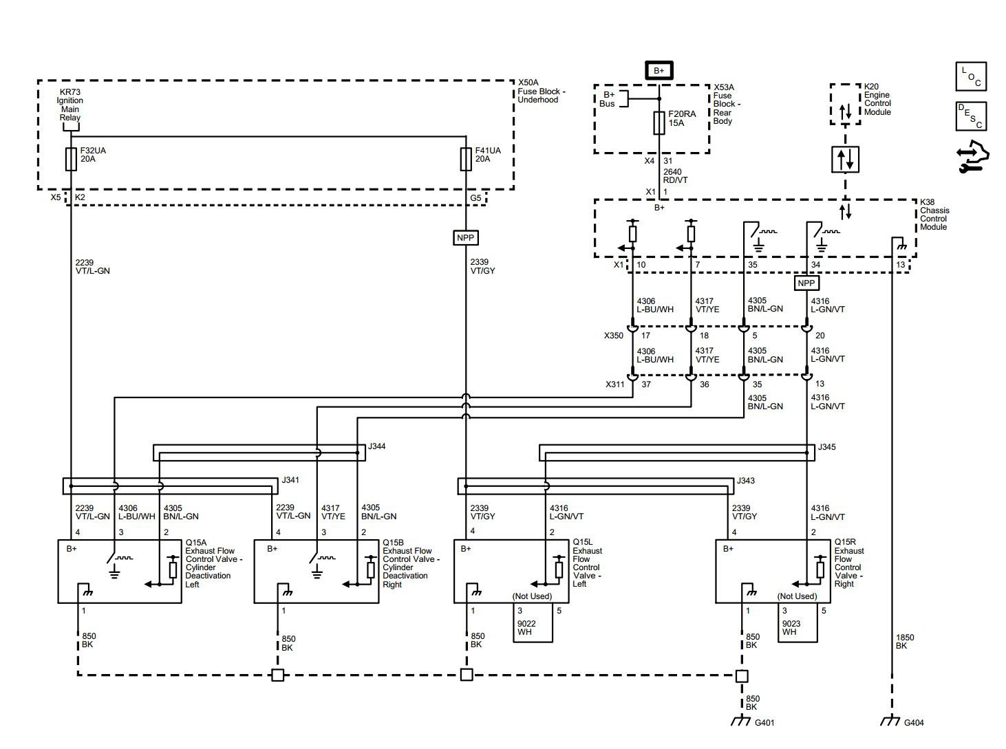

Yep 100% accurate that it's a pulsed signal. See attached wire diagram and you can see the little pulse symbols for the AFM and NPP valves coming out of the chassis control module pins 35 and 34 respectively. Check your connectors X350 and X311. That's where the pulsed signal goes through the connectors. Maybe they are loose. Or possibly that ground G401 on the exhaust flow (NPP) control valves is bad. Or no 12V on pin 4 of the exhaust flow control valves.

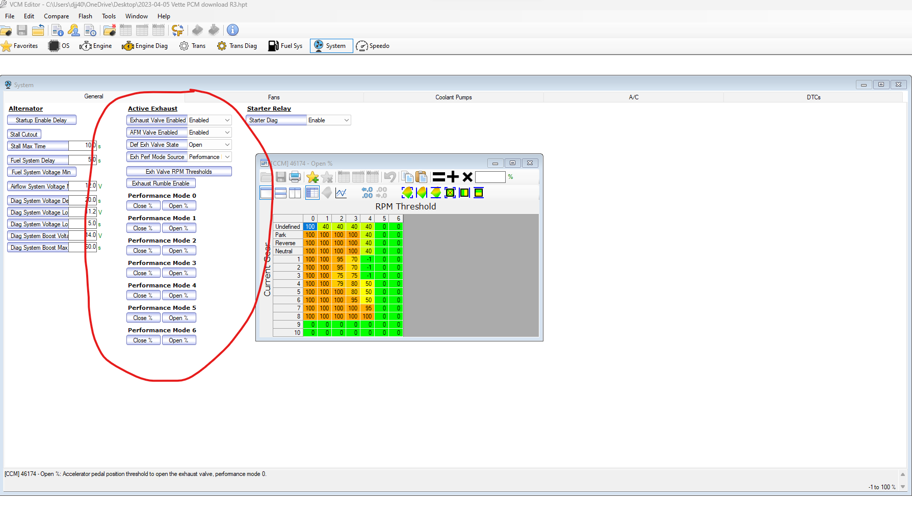

You need to look for someone that has HP Tuners. You can use that to download your calibration and CCM information which is where the NPP programming resides. You'll also need a stock file for your model year to compare against.
It'll look something like this....
