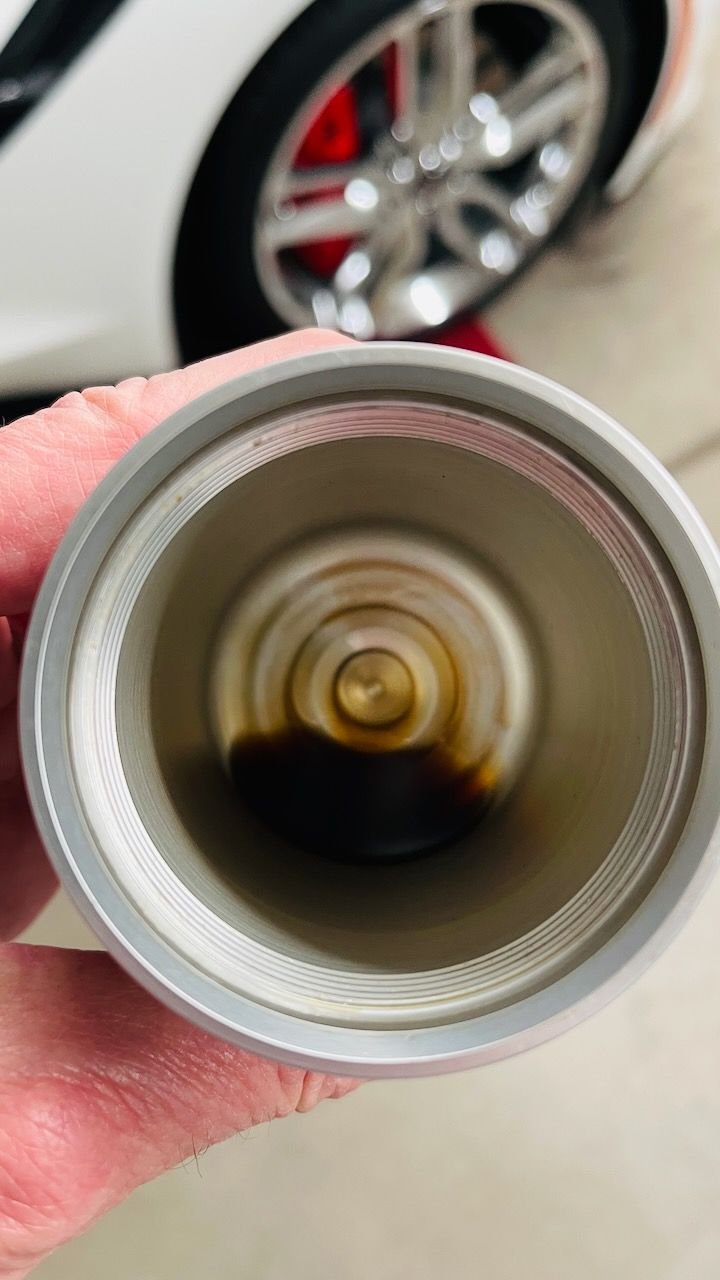

Tons of posts about catch cans, in the end do what you think makes sense. I installed an Elite catch can as I've run them before on other vehicles with success at removing oil from the intake. I drive my car occasionally and below is what had collected in the catch can after about ~400 miles. Not a ton, but I don't want any of it in my intake. And mine is a Z51, normally aspirated.

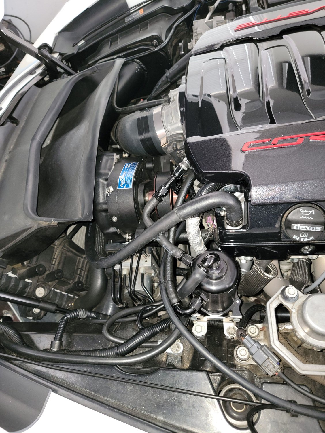

Given the issues some DI engines have with carbon deposits on the backside of valves, I prefer a catch can to take whatever oil vapor I can out of the intake tract.
I installed a Mighty Mouse catch can on my A&A boosted GS because I know what kind of havoc that oil vapor can have on a boosted motor. However, the supercharger draws it's breath through the stock airbox with the supercharger vendor's provided air filter. I didn't consider the dollar value proposition sufficient to replace the stock filter with a "high flow" one otherwise.
My investment in these "solutions" isn't exceeded by the dollars I put to them... so my decision are proffered here as what I felt was best for me.
