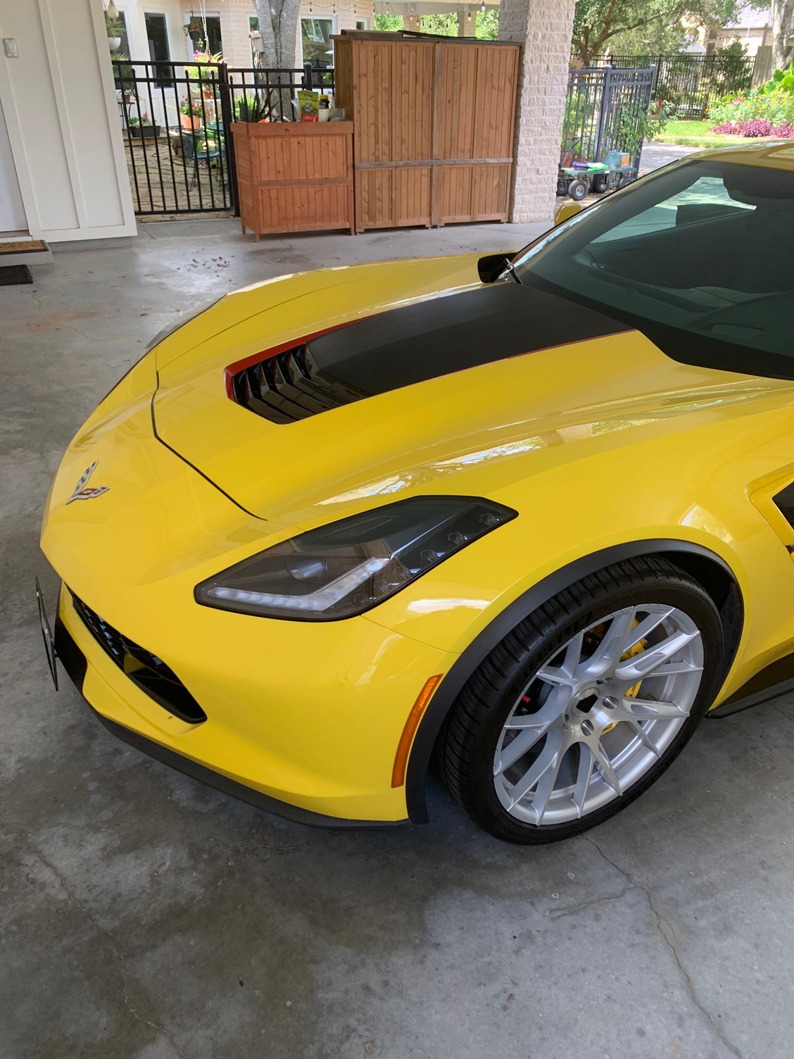

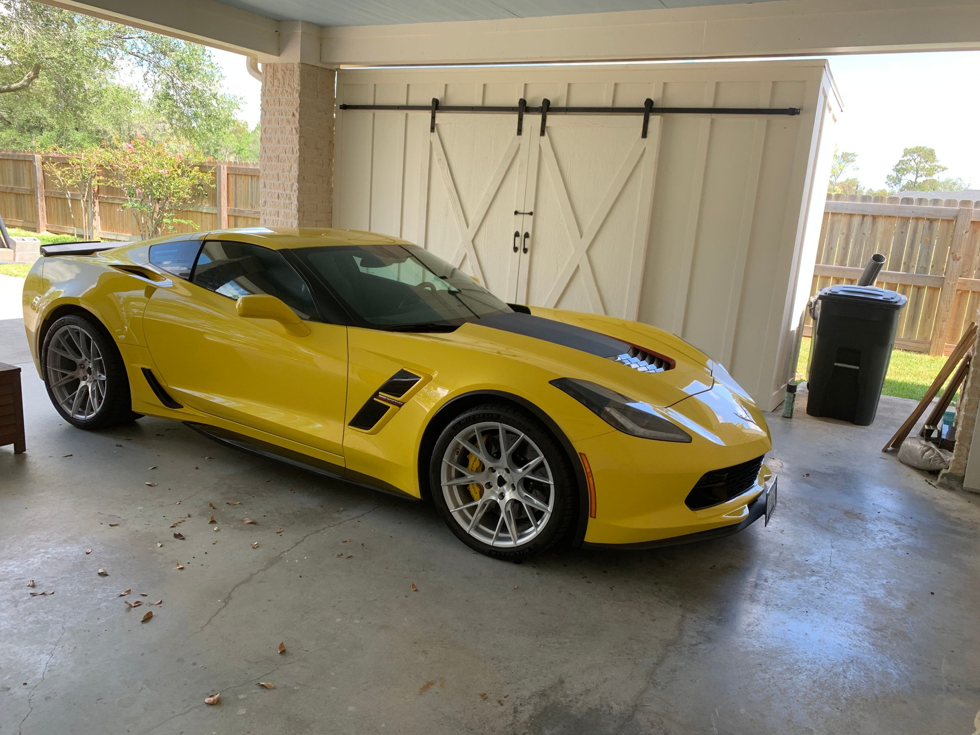

i have blaque diamond brand wheels for my gs. check with them on off-set. see pics
