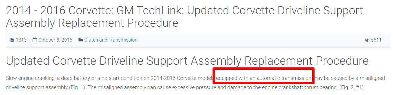

Here's the torque tube replacement procedure. If not done right on automatic transmission cars the engine thrust bearing can be damaged.
https://www.corvetteactioncenter.com...dure-1313.html
GL
Ron
GL
Ron
So it doesn't apply to M7's ?

If you read the article it refers to automatics. It would be a good idea to follow the procedure for M7 as much as possible. I'm guessing a clutch has some "give" that a flex plate does not.
the automatic flywheel has a physical clamp torqued to 96 lb/ft.......
this clamp provides an inflexible connection between the crankshaft and the prop shaft (torque tube)...
when the stub axle is first inserted into the flywheel, it tends to push the crankshaft forward, which causes the thrust bearing wear.
the tsb instructs a test drive, then a re-test of the end play of the crankshaft.... if there is no end play, the clamp must be loosened and the crank shaft pushed reward towards the transmission and re-torqued to 96 lb/ft...
the stub axle (coming from the torque tube) slides in to the plates of the clutch, and is not locked in place.
you will not experience this TSB because the crankshaft and stub axle are allowed to move freely in a "front / back" manner within the clutch plates.
hope this helps!
hope this helps!
It definitely does. Another thread posted the TSB and the way GM worded it leaves quite a bit of ambiguity regarding the matter.
if you say so, but if you read the article, it specifically says "vehicles with an automatic transmission"
but you're more than welcome to worry about it if you really want.....
I'm looking at the TSB PDF, not the 'article' and it has this verbiage for the models it applies to:
2014-2016 Chevrolet Corvette
Built with an 6.2L, LT1, LT4 engine and auto or manual transmission with crank shaft end play concern
and in the 'condition/concern' section:
Corvette Only
Customers may have a Corvette that exhibits one of the following conditions:
1. Customers may have a Corvette that exhibits one of the following conditions:
2. Auto transmission it could be a vibration on takeoff or clunk noise.
The colon at the end of the first bullet indicates the second bullet is related, but they're using bullets with the same cardinal values which should indicate that they 'equal' i.e. two different conditions. More likely it's a poorly written/formatted (and proofread) text - the first bullet is just reiterating the line above it. It shouldn't even be bulleted.
So no, I'm not going to worry about it, but I am annoyed at the ambiguity of the TSB.
