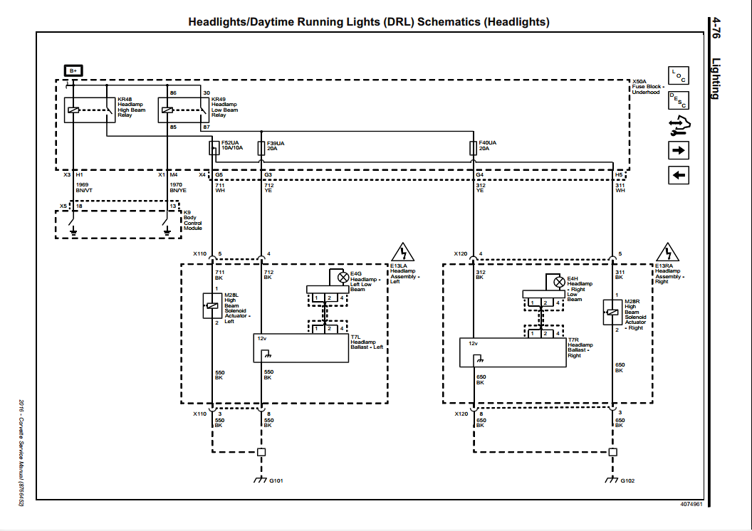

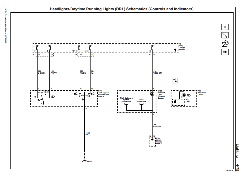

No, it doesn't have separate sensors for each light. There is only one sensor on top of the dash and it sends a signal to the BCM which then sends a turn on signal to the headlight relay in the underhood electrical center which then connects each headlight fuse with B+ power which turns the lights on. The headlight switch feeds signals to the BCM that let it know which operational mode the lights are in. Choosing manual or automatic doesn't affect the way the lights are turned on by the BCM.
