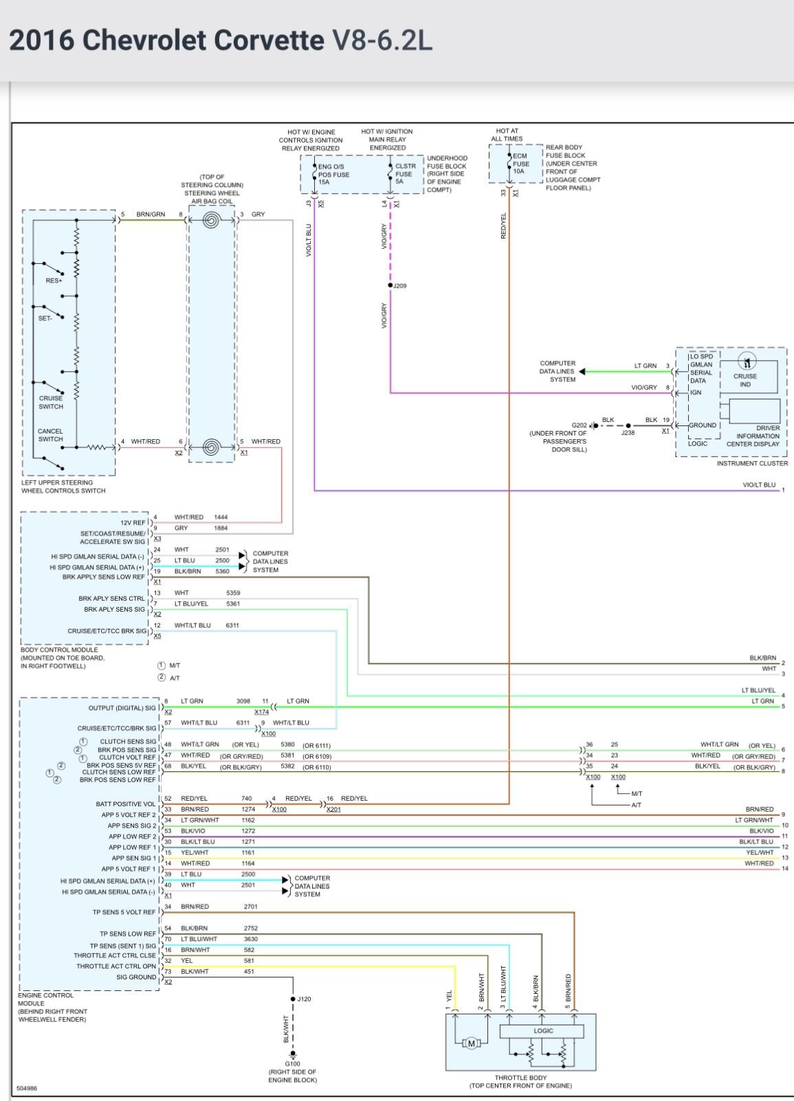

Here is the wiring diagram for your 2016…if you want to let a pro handle this Cody’s (Cody Gaddie) Auto Diagnostics is your guy…he’s in Tucson and he does mobile diagnostics…there are MANY things that will inhibit the CC from working and having an OE level scan tool would help to see if there are any DTC’s stored and also help in checking the CC inputs.
