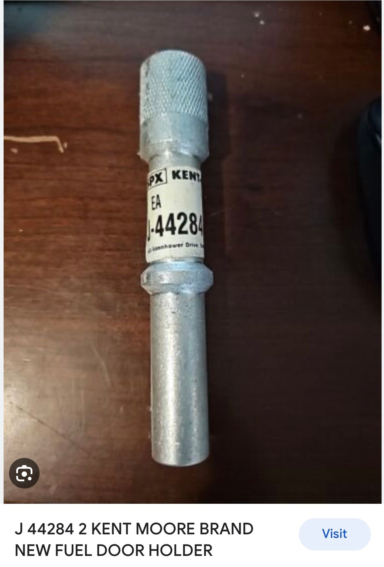

A P0455 is a “Large Leak Detected” in the EVAP system and the dealer if FULL of you know what !!…it can be an actual leak or a faulty EVAP fuel tank pressure sensor or even a faulty vent valve not closing…the EVAP system is also covered under a Federal or California Emissions Warranty depending on which sticker you have on your car…more EVAP parts are covered under California Emissions…I believe the warranty is 8years/80,000 miles but your owners manual should tell you…info below from Alldata for a P0455 for a 2017…read the “note”…the Dealership should have the tool..it is pictured below…they should also have a smoke machine that is needed to find these leaks.
