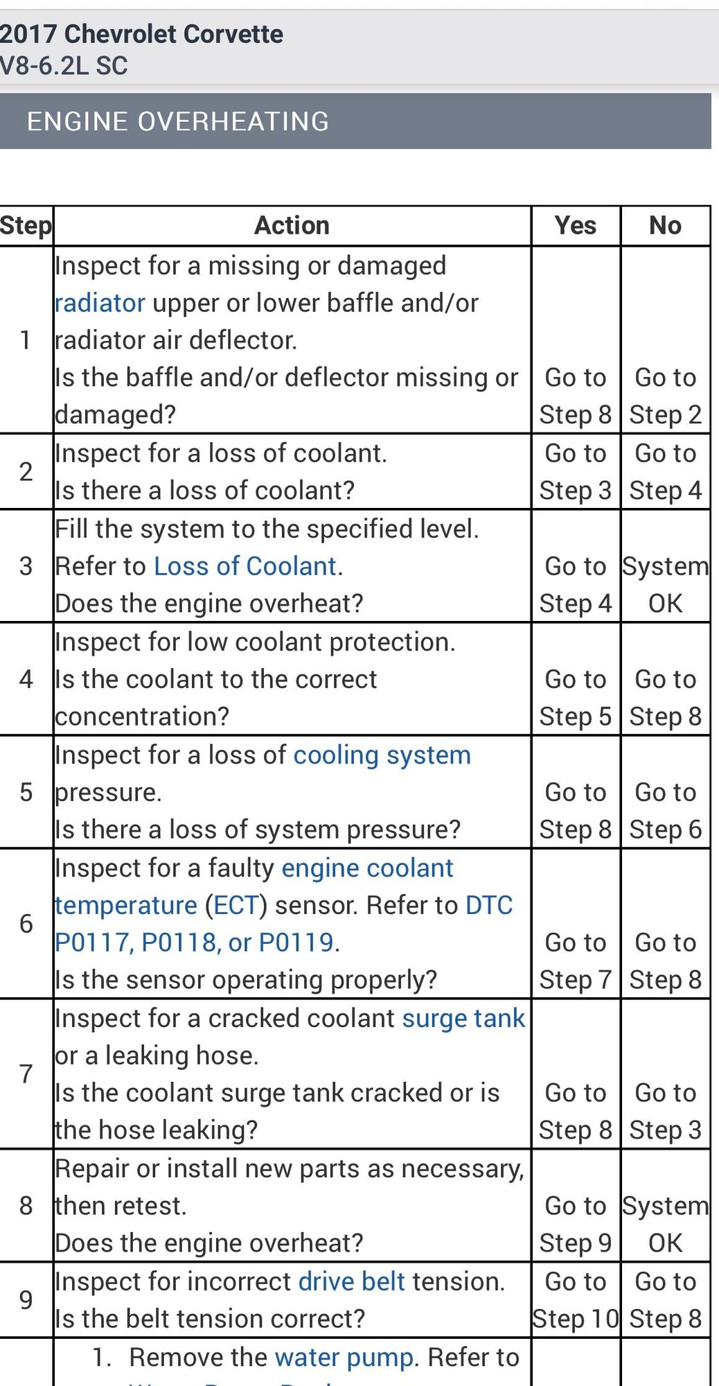

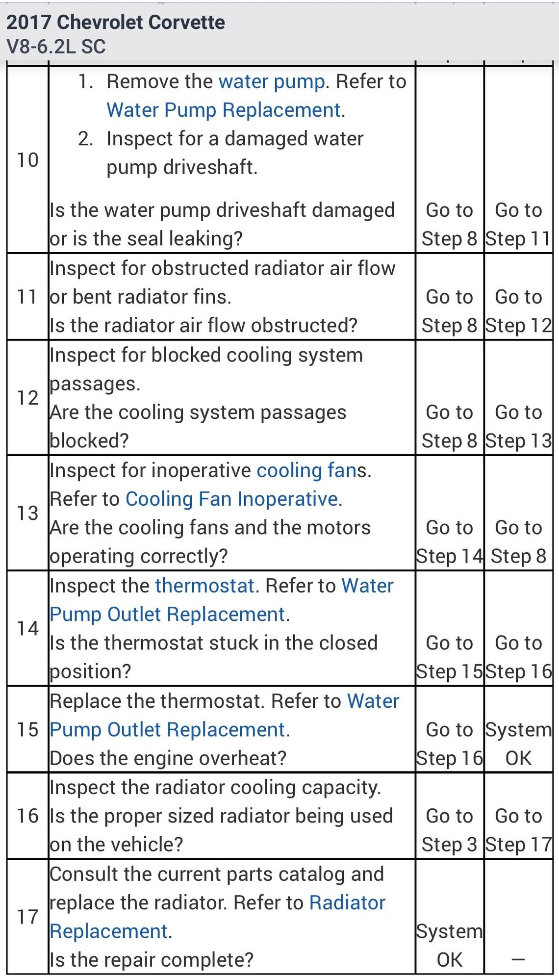

It’s a good idea to fill out your profile so we know what we’re dealing with…no magic bullet when it comes to overheating…here’s something from Alldata for a 2017.
