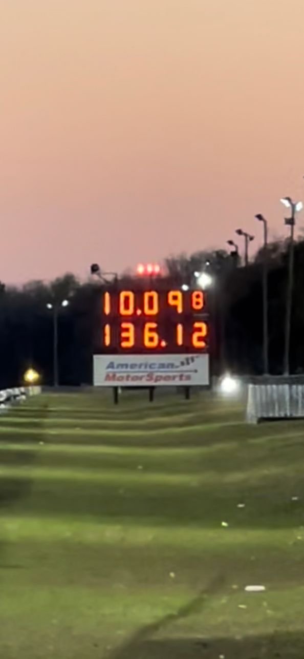

I have made 640 rwhp with down pipes and cat delete . Car runs 10.0 @136 mph with no flex fuel & no meth . Like those people in the know responded if youre making less than 800RWHP headers are not worth it . I’ve easily beating C7s with headers and similar mods . As far as sound , sound is a component of heat energy . My car is loud AF ! And like many others have reported the stock manifolds combined with down pipes flow really really well. Time slips dont lie ( and it won last year index class 10.0 at cadillac attack with an auto 8 speed and I also ran this with a stock trans and converter ( chris crawford tune )

I have made 640 rwhp with down pipes and cat delete . Car runs 10.0 @136 mph with no flex fuel & no meth.
That is quite impressive. What do you mean by down pipes? You eliminated all 4 cats but still run the stock exhaust manifolds and mufflers?
I assume you’re running slicks or drag radials and maybe skinny tires up front? I am able to get a similar ET on stock wheels and tires but I’m trapping 143 to 144. I’ve already lost an axle on stock setup but dread losing a diff.
