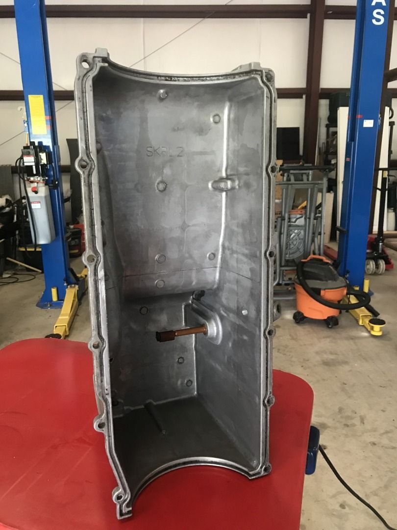

Internal oil pan before
Internal oil pan after
