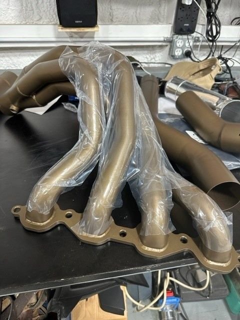

I had a set of header/x pipe on my C6, I got tons of complements on the sound. I've got a new set for my C7 I just got back from the ceramic coater. Goes on next month (with the A&A kit).

My job is done. I was going to do a write up on the whole project, but the headers were fine. They went in fine, fit fine. They don't seal 100%, I might try to adjust it a little more. I was going to put a few heat cycles on it then re-tighten. A&A kit just tuned on Tuesday, so it's still very new.
As for the coatings- This time I went for a "burnt bronze" color vs the classic "shiny silver". The gal at the coating place had both in the highest temp range. They do two coats on the outside, one coat on the inside. On my C6, I also had Speed Engineering headers and x-pipe. I did the silver then.
Comparison-
The burnt bronze gave it a more custom and personally I think more of a classier look.
The downside is- if you scratch the burnt bronze, and they scratch VERY easily- it sticks out like a sore thumb. When you scratch the silver, it just looks like a scuff.
The standard ceramic coating is pretty darn soft. I've had a couple other projects that used it, and it's soft, not like you'd imagine a "ceramic" surface to feel like.

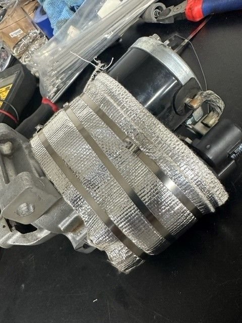

What I did was- wrap the headers with several small pieces of "crash tape". Make sure you use small pieces to make it easy to take off each one once its up in place. I got a roll to protect the fenders, etc. Worked perfectly. Wrap up the bottom of the headers, push 'em up from the bottom, wiggle in place- once the couple bolts are in to hold it up- peel off the tape. It's a life saver. Before it was time, I wiggled up the passenger side to see fitment and put a few scratches in the coating.
With a good ceramic coating (not some gimmick) you shouldn't have to wrap the headers. You're just asking for problems. They retain water, possibility of coming loose after a while, etc.
I also put a small starter wrap on- probably not needed after I had it all together. The stock heat shield looks like it does a pretty good job. If you have any questions, reach out. All this is still pretty fresh in my mind (since I stressed about it for months).

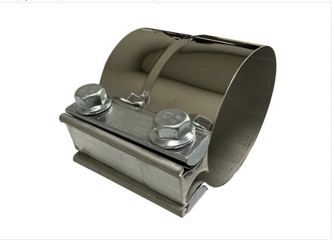

Just curious if the Corsa Bank Clamps worked for you and eliminate the minor leaks? I just ordered the SE x-pipe and also going to order these clamps to use instead of the clamps that come with the X-Pipe. My question is you mentioned that you ordered the 2.75" clamps, did those work well or would you recommend getting the 3" clamps? here is a pic of the clamp...

The Speed Engineering xpipe is 3 inch piping I believe. However the rear sections are 2.75”. Are you getting a 3 to 2.75 inch stepped clamp?

according to the website for the 2.75" lap clamp, the smaller side is 2.75" and the larger pipe is 2.87", on the 3" lap clamp the smaller pipe is 3.00" and the larger is 3.15".

I don’t think either would work. If the xpipe is 3” OD at the outlet and axle pipes are 2.75” OD at the inlet then you’d need a clamp either ID of those two measures.

Speed Engineering confirmed the outlet pipe outside diameter is 3.0". This is probably why we're all having loose connections with the clamp not sealing. You're stuffing a 2.75" outside diameter axle pipe into most likely a 2.875" inside diameter of the x-pipe. I think I'm going to try a 3" ID to 2.75" ID clamp and see if I get better results. Most likely I'll have to cut an inch or two of the axle pipe to keep my tips tucked under the bumper.
Maybe this....
Amazon.com: Peastorm 2.75 to 3 Inch Exhaust Adapter, 2.75" ID to 3" ID Exhaust Reducer Connector Pipe with Clamp : Automotive Amazon.com: Peastorm 2.75 to 3 Inch Exhaust Adapter, 2.75" ID to 3" ID Exhaust Reducer Connector Pipe with Clamp : Automotive
