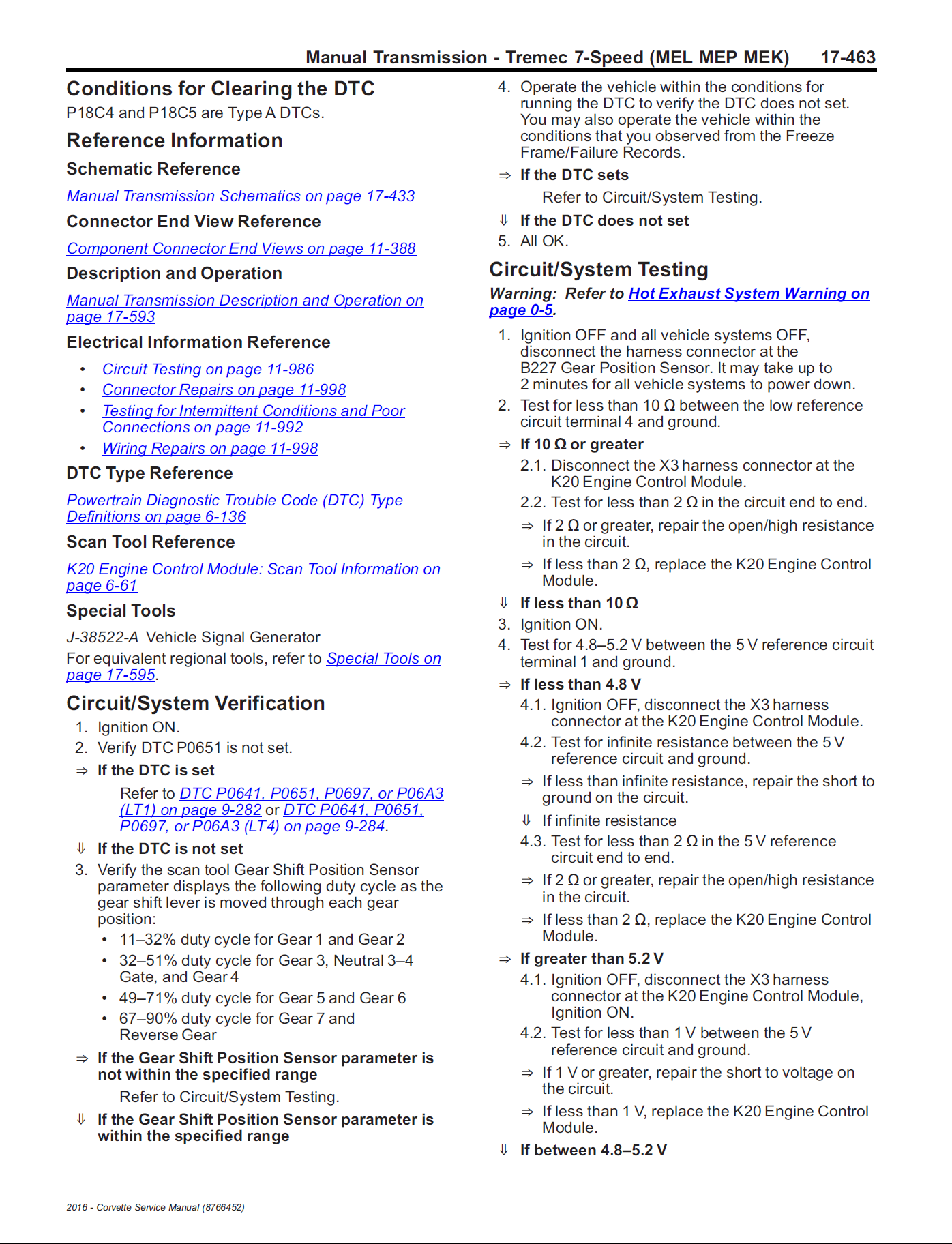

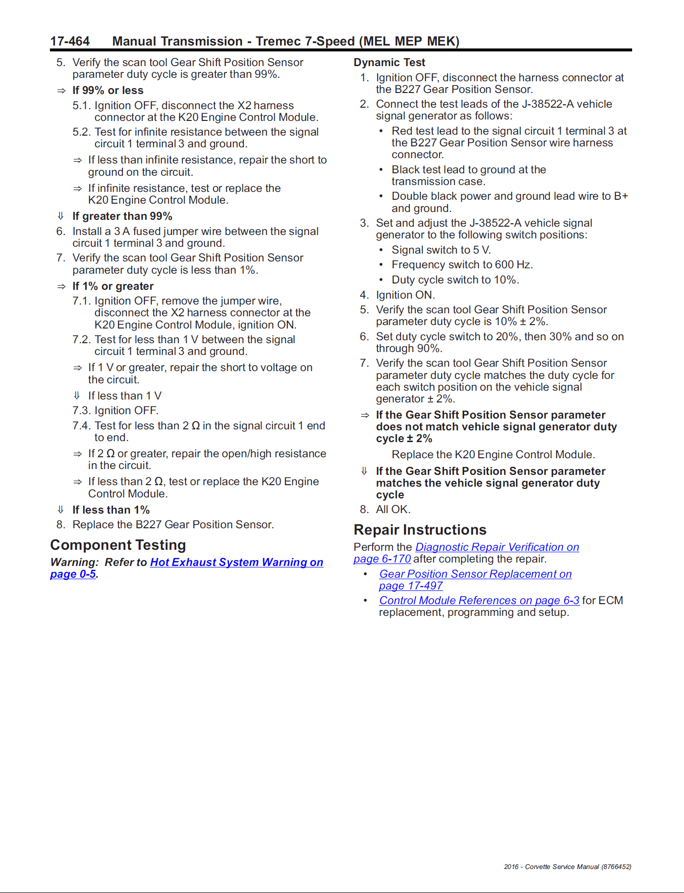

Since the problem is intermittent the first thing I would do is disconnect the sensor and spray contact cleaner in both halves of the connector (harness side and sensor side). The problem could be with the sensor or at the other end of the wiring harness at the ECM (bad ECM or poor connection) but I suspect the transmission end is where the connections have a chance to be more exposed to dirt and moisture. When diagnosing electrical faults the first thing you need to do is ensure all electrical connections are clean and making good contact including ground connections.
The diagnostic table for P18C4 shows that you are concerned about Gear Position Signal 1 being shorted to ground so also check for damage to the wiring.

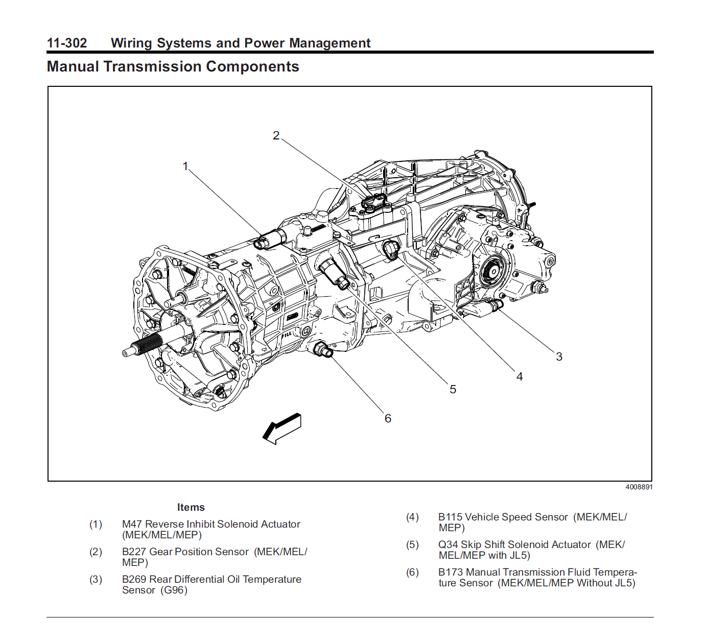

I have access to a 2 post lift. So I ended up being able to fit my hand up there and was able to remove the connector to the gear position sensor. I verified that the connector was in good condition. So I proceeded to check for power and ground and found that source voltages were good and ground was good. Which at that point I went ahead called it as the gear position sensor was bad.
The sensor is extremely difficult to get to and my forearms were all banged up after I replaced the sensor but it was better than dropping the whole rear subframe and trans. It’s totally possible to get it replaced with the right tools in about an hour or two (also 2 post lift helped a ton). The sensor has 4 8mm bolts that hold it down. You also have to replace the gasket that is underneath the sensor as well. Once you get the bolts out, the sensor will be pretty snug to the transmission. I ended up using a medium size snap on pick to pry the sensor up. After I did that, I heard the pressure release from the top of the transmission and I was able to remove the sensor.
Installing was a bit tricky, but I just put the 2 bolts through the front two holes of the sensor with the gasket mated as well and was able to carefully bolt it up to the transmission.
Once it was all done I deleted the code and everything started working again! I didn’t reprogram sensor like the post stated. Everything was working great after the install.
Just a heads up the sensor is on back order with no ETA everywhere. I got really lucky and found 1 available on Rockauto after checking the site everyday. I also called several dealerships and everyone said it was on back order with no ETA.

^^^^^^ Wow - Thats some great info! I just dont see how you could have possibly got in there. My hands aren't so large and no matter how hard I tried I couldnt hardly touch it let alone unplug or get a wrench on it.
I wonder if the dimensions are different on the Z06 or what?...I know the trans is a different part number than a Z51 but are the cases identical? Hmmm

That’s a good point, not sure if they are the same dimensions.
It is a tight fit and I think that maybe removing the mufflers then you should have a little bit more room. I ended up using a 90 degree pick to unlatch the connector with one hand and used my other hand to pull up on the connector, almost like hugging the transmission. I used a 1/4” flex head ratchet and a stubby 8mm socket to remove the bolts for the sensor.
