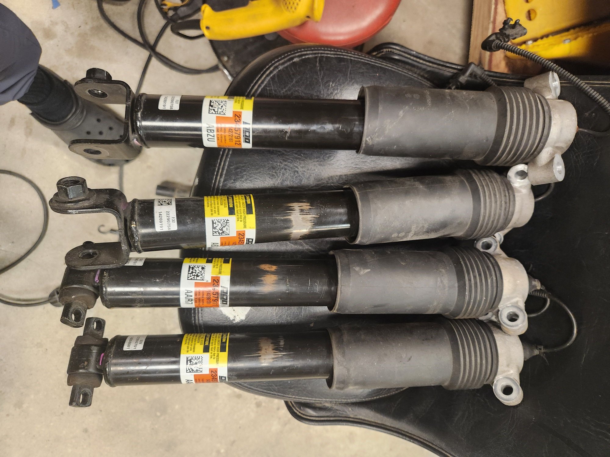

I have a set of front and rear shocks off my 2015 Z51 also have the stock sway bar end links. Will sell all for 1,200.00 plus shipping. I live in Fort Walton Beach Florida. PM me if interested
