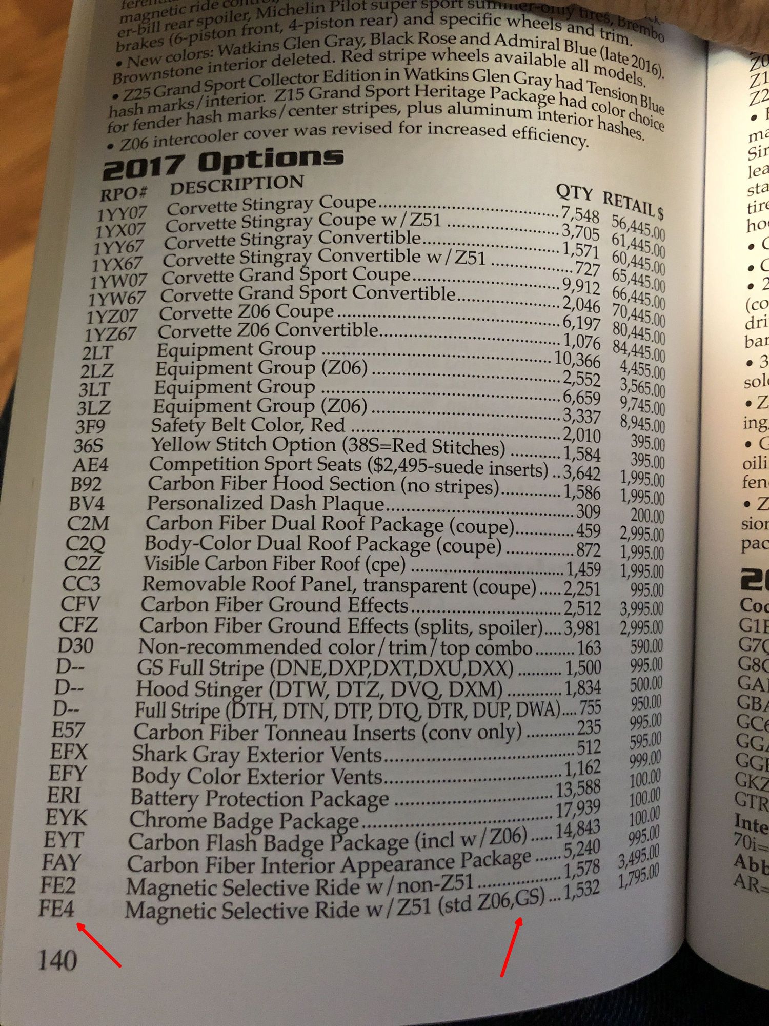

Stingray mag ride is FE4, GS is FE6, Z06 is FE7 suspension.
OP has a 2017 GS - with FE6.
Ron
Ron
FE4 was standard on Grand Sport models per the Corvette Black Book.
However, I suspect their information is incomplete. They don't list FE6 or FE7 at all.
Old Jun 23, 2023 | 10:54 PM
RonC7's Avatar
RonC7
Joined: Dec 2012
Posts: 3,858
Likes: 1,863
From: St. Louis Metro East IL
The GMVIS report and service parts label on my previous 2014 Z51 with mag ride lists FE4. The build sheet and service parts label on my current 2019 GS lists FE6. I suspect the service parts labels, GMVIS, and build sheets are more accurate than a handbook.
Ron
