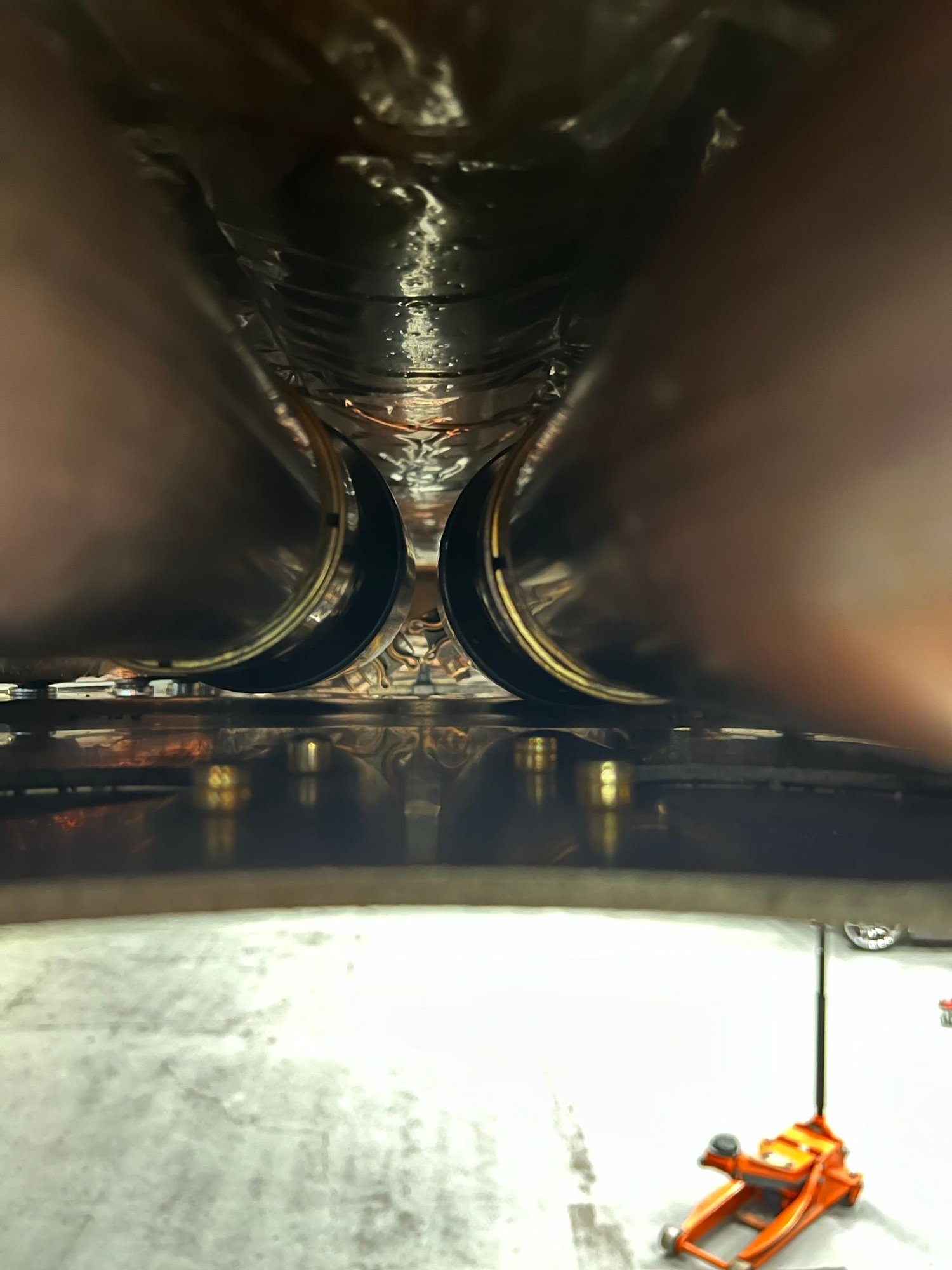

Some pics are below.

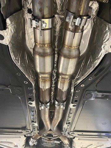

The first one shows the new cats that replaced the crap the shop installed. These are GESI G-Sport Gen 2 cats
View looking aft and you can see the driver's side cat is low/resting on the tunnel plate

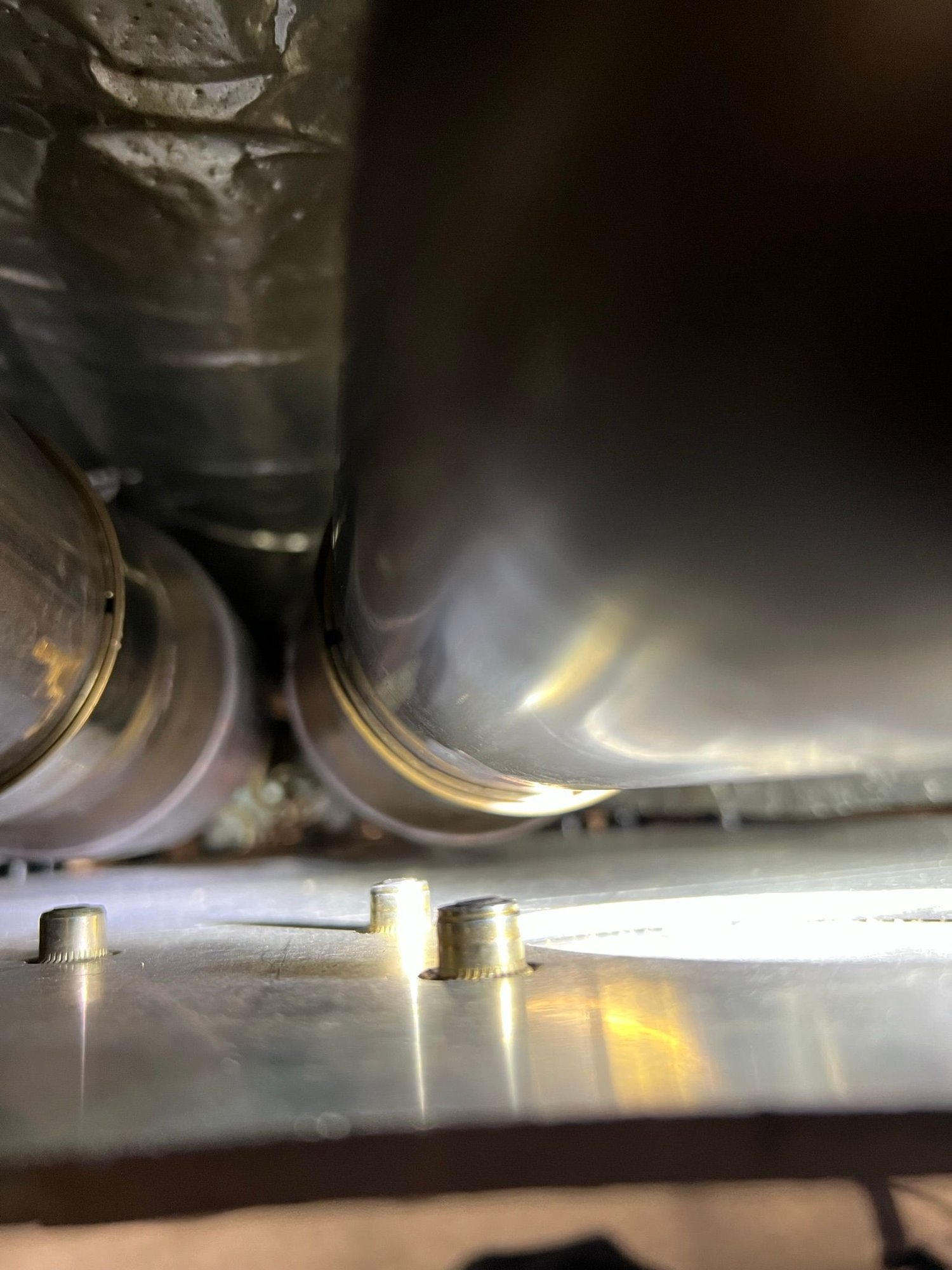

Note the witness mark on the driver's side cat towards the back. Added spacers but it still intermittently bangs on the tunnel plate

With the plate off it doesn't rattle, and there's a witness mark on the bottom of the cat that matches a corresponding witness mark on the tunnel plate It's definitely the driver's side bullet cat hitting the plate.

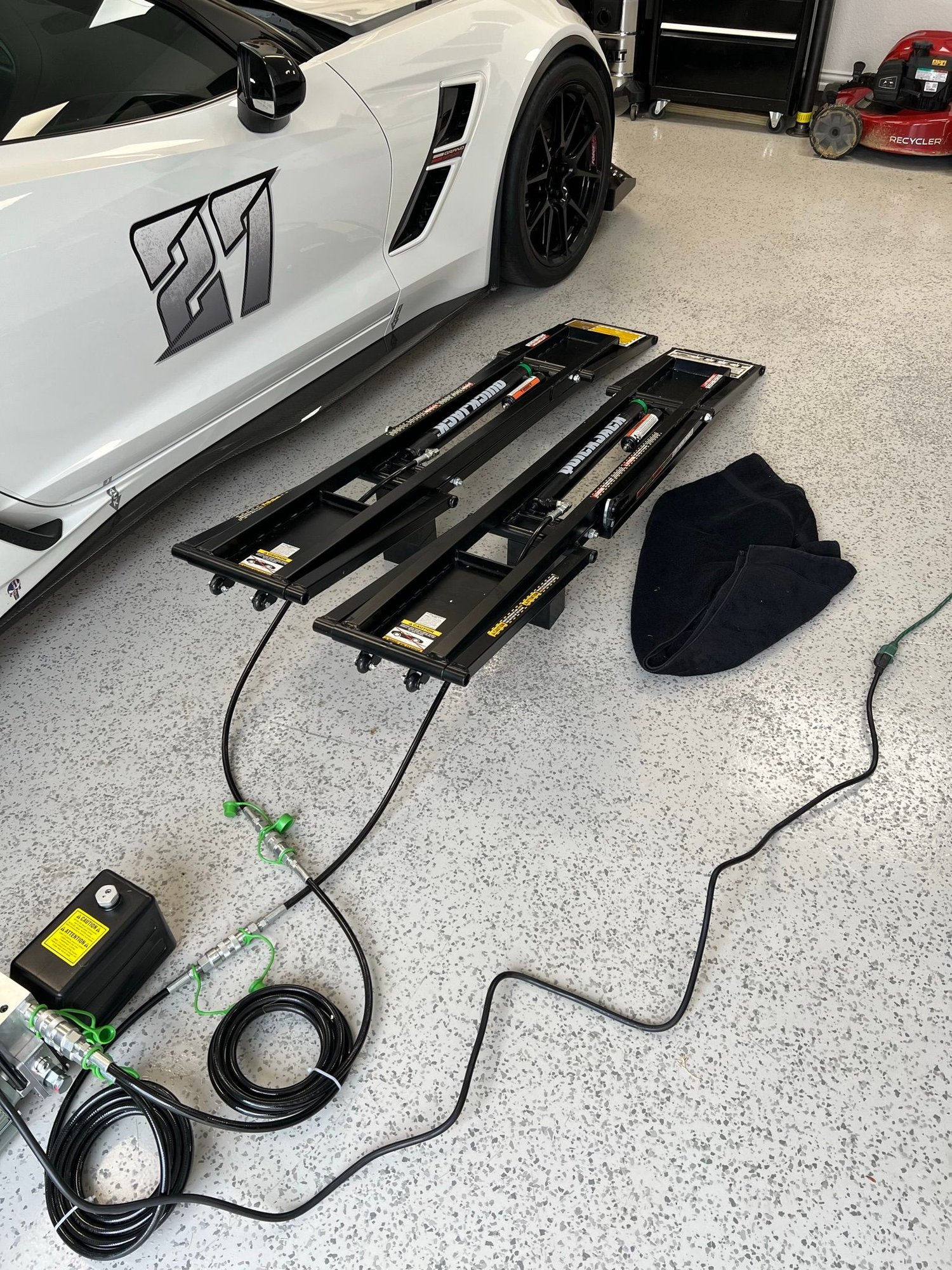

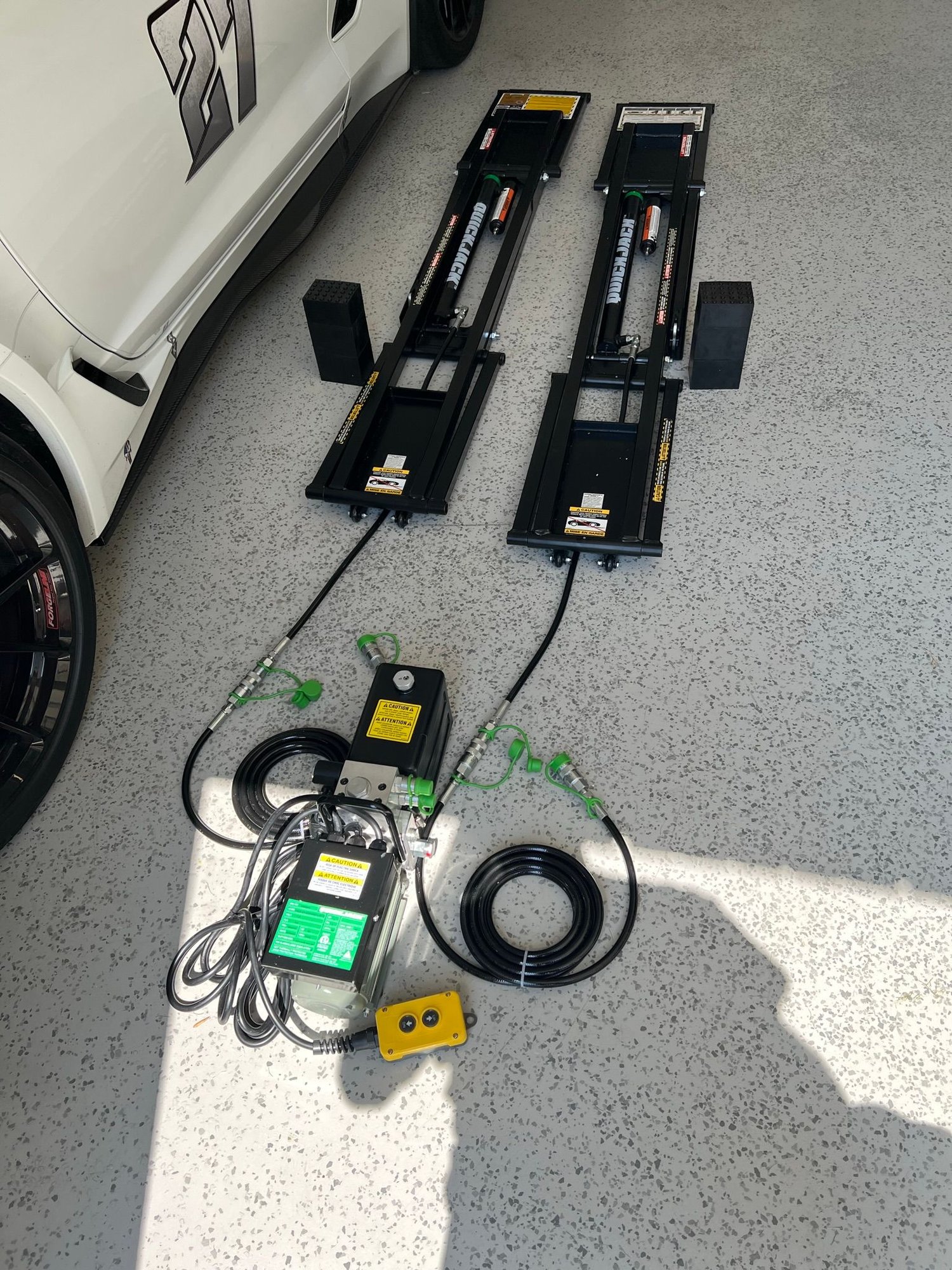

Figured I'd close this one out...

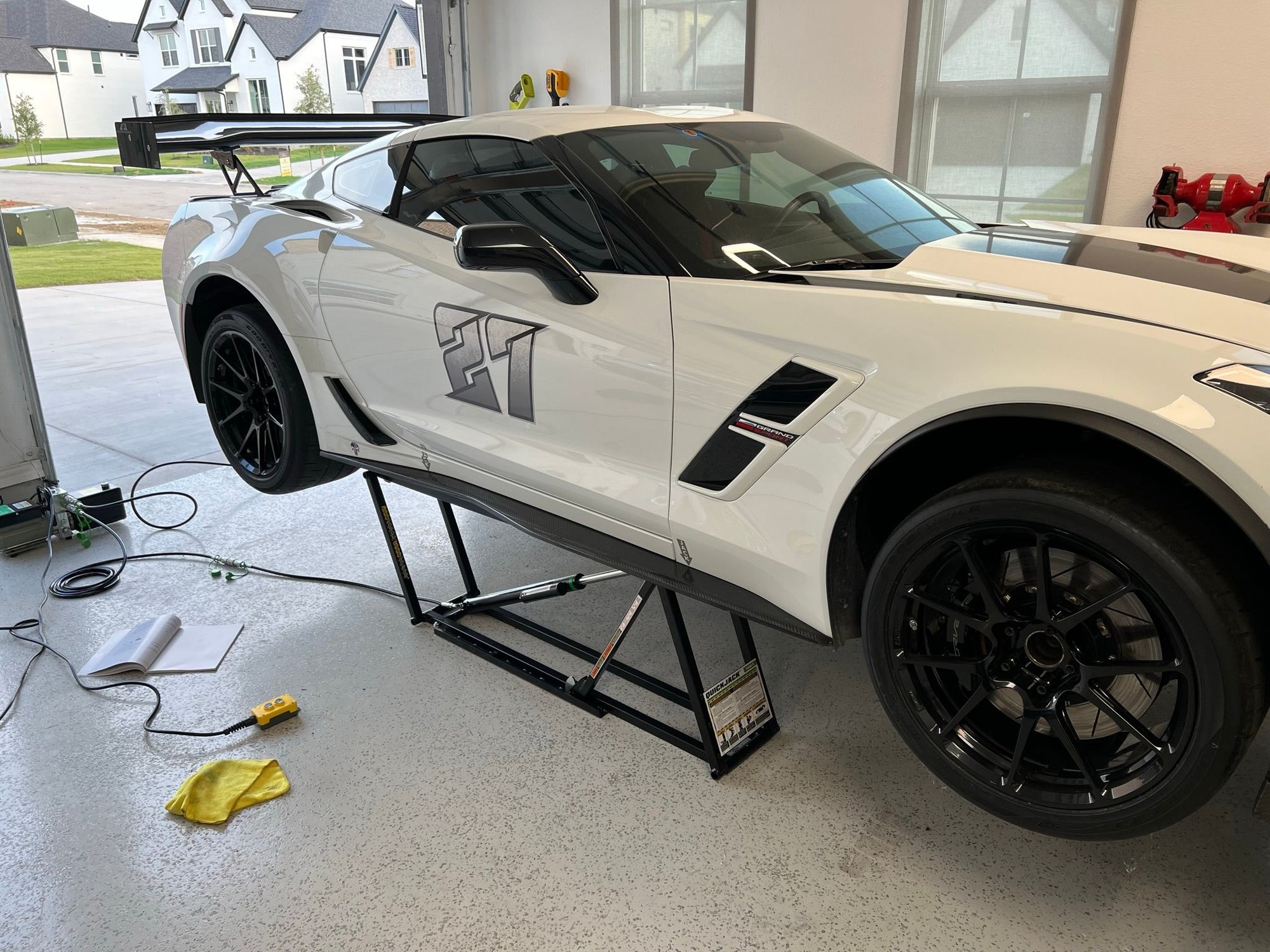

Got my QuickJack assembled and operational

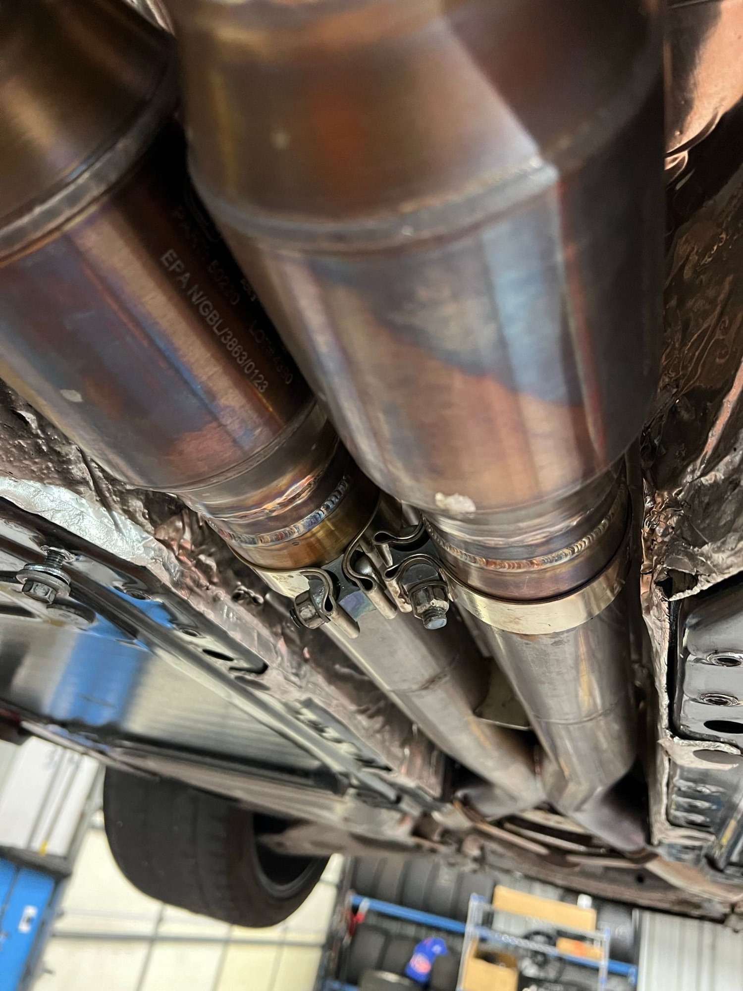

Pretty quick process for the cat
- Loosened the driver's side header
- Removed the tunnel plate (24 bolts )
- Loosened all the exhaust clamps
- Used my floor jack to gently push the cat upwards.
Unfortunately I only gained about 1/8". Sooooo, I reinstalled the tunnel plate with some machined 1/4" aluminum spacers. I took it for a drive today and so far so good. We'll see if anything shifts around. If that happens, I have 3/8" and 1/2" spacers I can use.
