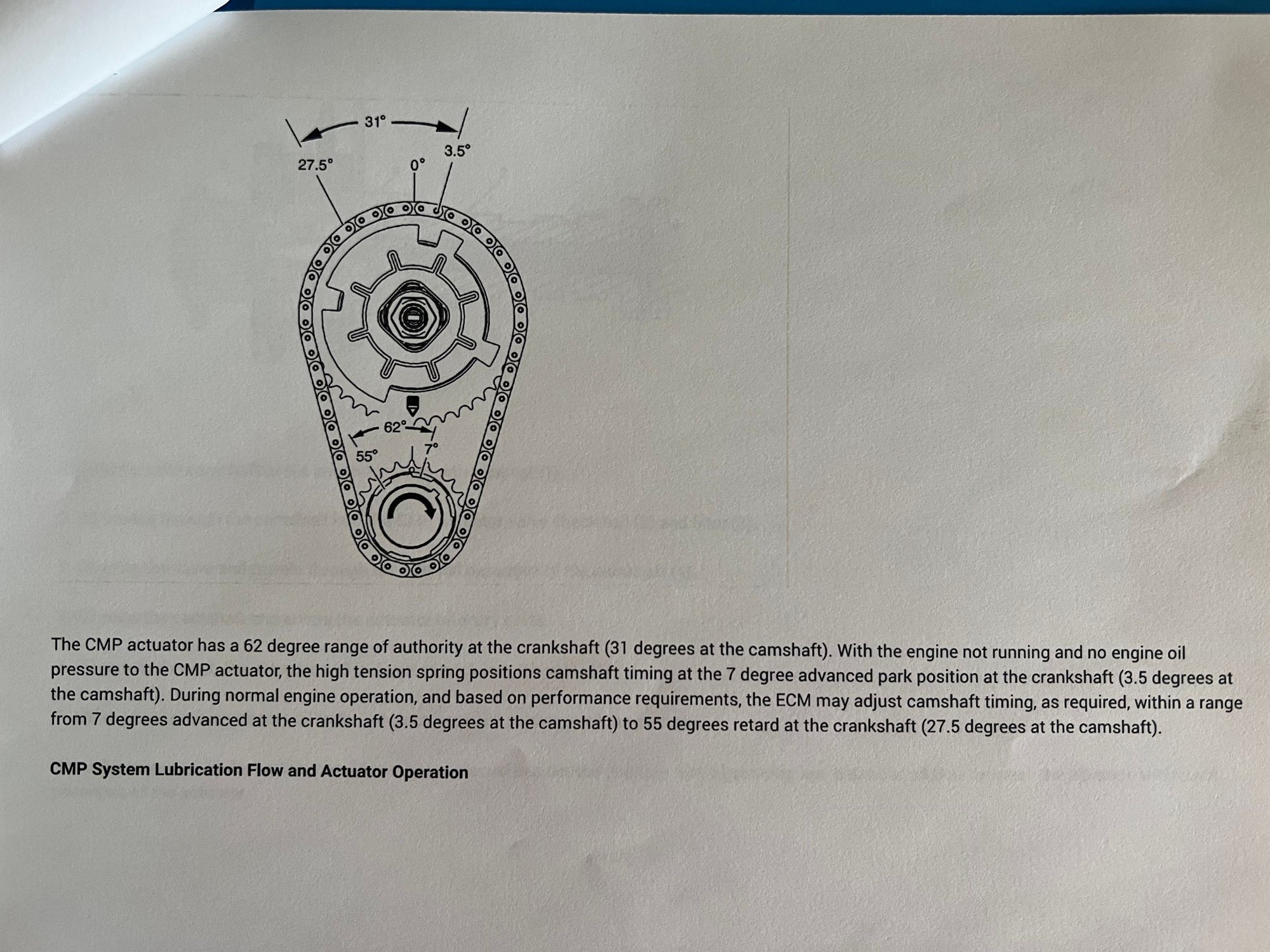

Hi, I did some searching both on the forum and using the google machine and can't seem to find an answer. Does anyone have the technicals on the VVT on the LT1.
I'm just trying to find out the stock cam specs, when and by how much the actuator advances and if drive mode affects it. This is more out of my curiosity and knowing about how the car reacts.
Any info or source for info is appreciated.

Hope this helps !!

That does actually. Thanks, so it sounds like there is more ECM magic and way more adjustability than I thought.

You can tune the ECU to change the cam movement. I do it often on the LT1's. The biggest changes that can be made are part throttle drive-ability, which reduces fuel economy but makes part throttle feel way better. Your not going to find a bunch of hidden power or anything by trying to change the WOT cam movement on the stock cam.
