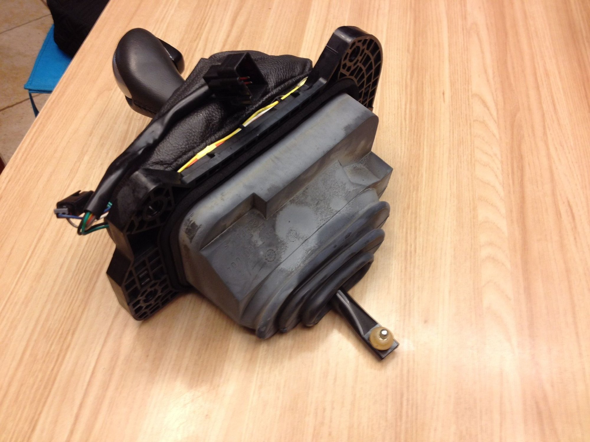

I frankly prefer the reliability of the M6 and M7s over the vette autos. The C6 A4 and A6 shift cables breaking and shifter modules (stuck in Park) were notorious for failing over time leaving you potentially stranded. My A6 failed fortunately on both issues while at home.
I haven’t heard of the A6 having those issues, that’s good to know! Especially since the c7s are all out of warranty now!
Here is what the split in half front shifter cable plastic grommet looks like still on the bottom of the shifter module rod pin.
