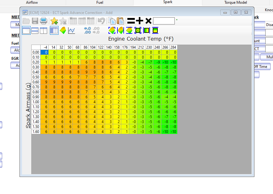

Here's what the base timing modifier looks like based on coolant temp for a 2019 Z06. I'll assume it's fairly similar across years...
now keep in mind that there are multipliers, other base modifiers, the actual base timing, etc. In other words....simply lowering the temp a handful of degrees may or may not do anything and it's likely to be un-noticeable even if it is doing something. At 205*, you might be pulling a degree or a degree and a half of timing.
