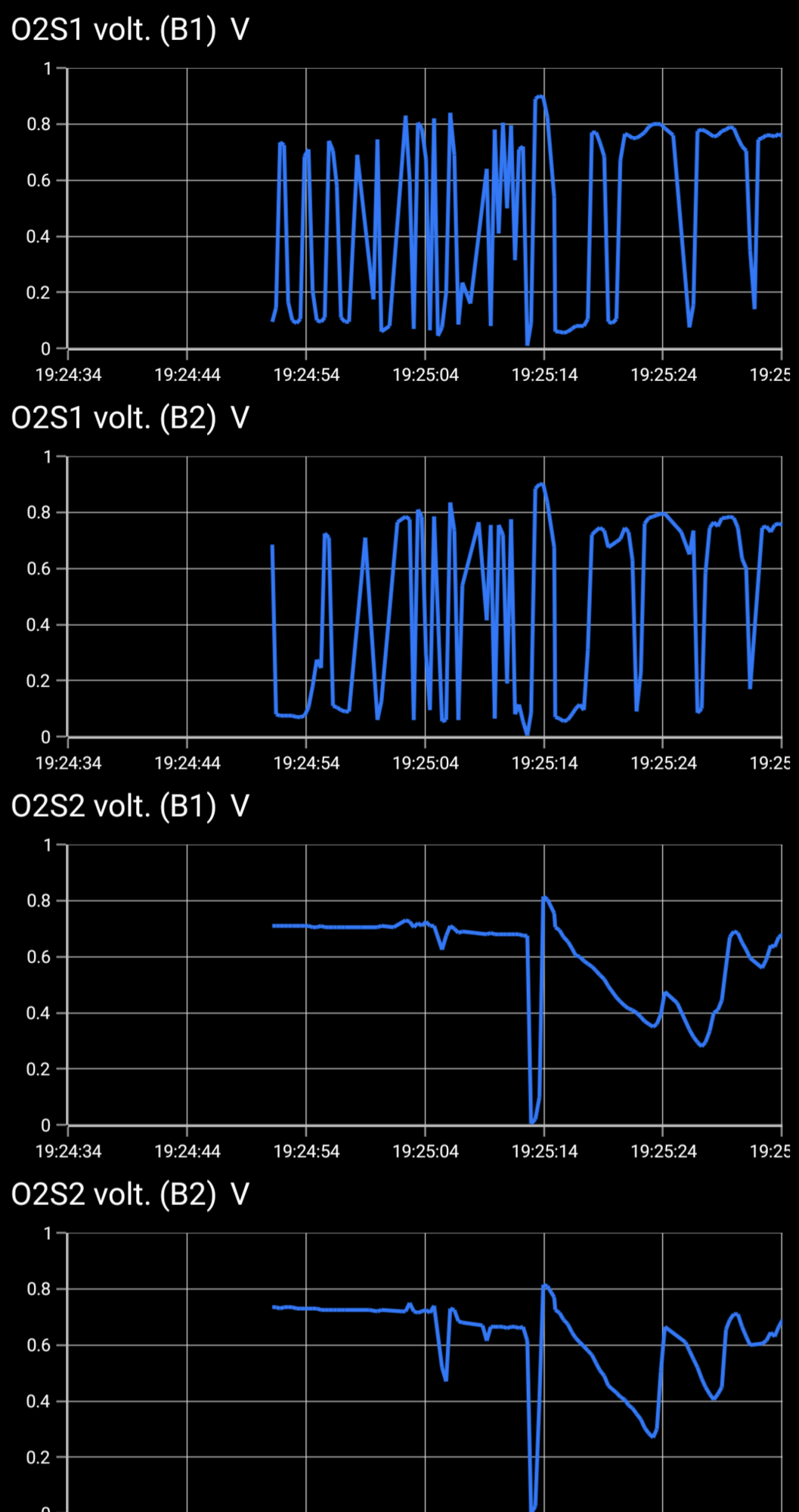

If your App can graph the O2 sensors look at how the B1 sensor oscillates between rich and lean…it should go from 200 mv’s (lean)-800mv (rich)…this “lazy” O2 may just be bad…a video so you can see what I’m talking about.

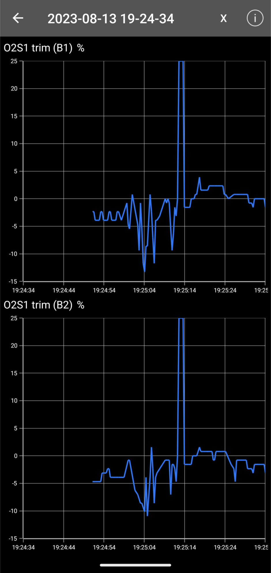

Thanks for the advice. Not sure if this captured what you were talking about. My graphs are very different than on the video, maybe because I cannot do them by phase, or maybe I just haven’t figured out how with the Car Scanner app. Probably two hours of driving now and no CEL.

It’s hard to analyze your O2 sensor waveforms with a phone APP…the next step up would be a factory scan tool and the best way is a DSO (Digital Storage Oscilloscope)…you can see how different the right side of your upstream O2 sensors capture is different from the left…and funny you only had a code for B1…B2 looks similar…with a factory or aftermarket scan tool I can look at Mode 6 data and actually see your lean-rich and rich-lean switch rates…it looks like that big spike in your fuel trim may be DFCO (decel fuel cut off) which when you are cruising and then let your foot off the gas some of your fuel injectors are cut off…don’t know for sure by looking at yours…without having more info I’d replace the O2 sensor.

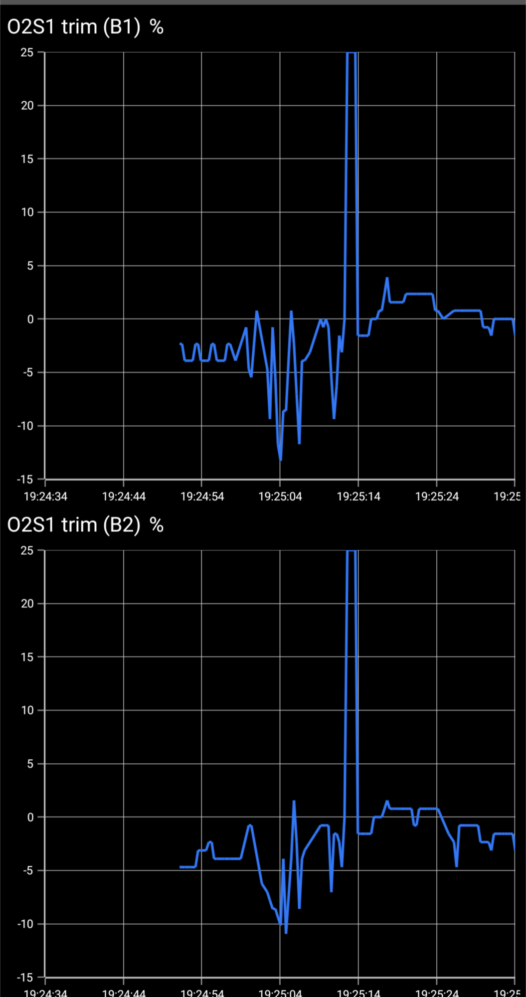

Does this help? Same timeframe as last. Would RPM and speed help?

No, that’s fine…I wouldn’t worry about that spike in fuel trims either..I don’t know if that is long or short term fuel trims I am looking at either.
