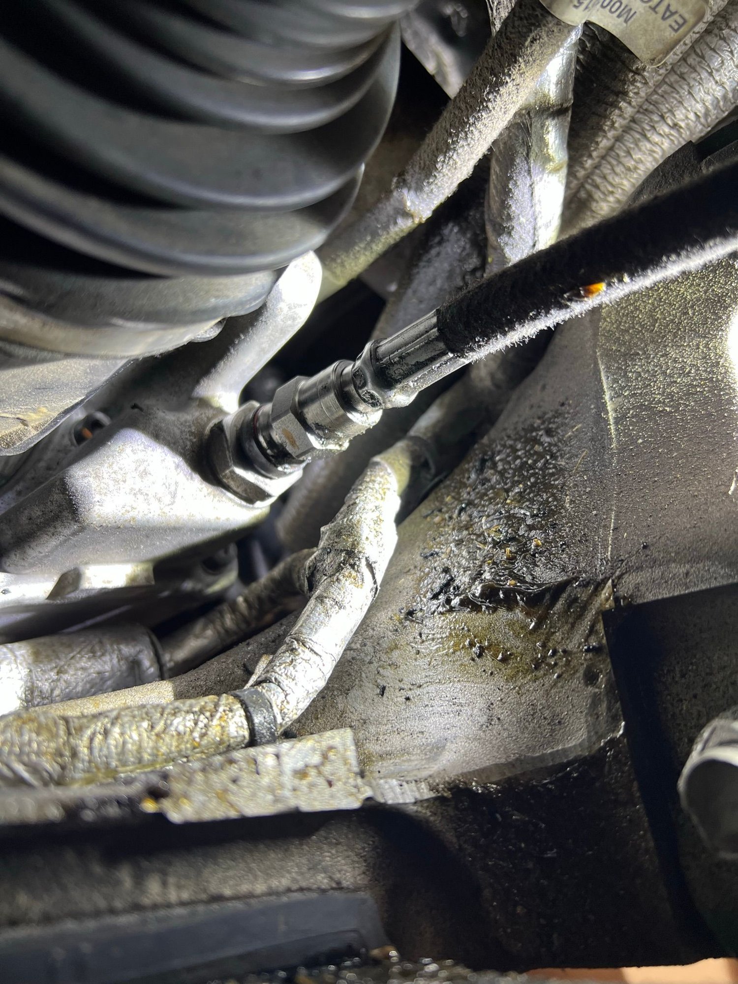

Anyway....post track day inspection has revealed I have a leaky rear diff pump hose. At first I thought I split the boot on the axle but it's try as a bone and the (now clean) fitting in the pic below was covered in gunk. Of course the airflow made sure to decorate other adjacent areas as well. What really sucks is that you have to buy these things as an assembly to the tune of almost $300 with tax.
Anyone seen them cheaper? The part number is 24265567 and I've searched all the usual low price suspects.
Looks like they have a retaining clip to secure them, so that should be a joy. Any tips or advice?

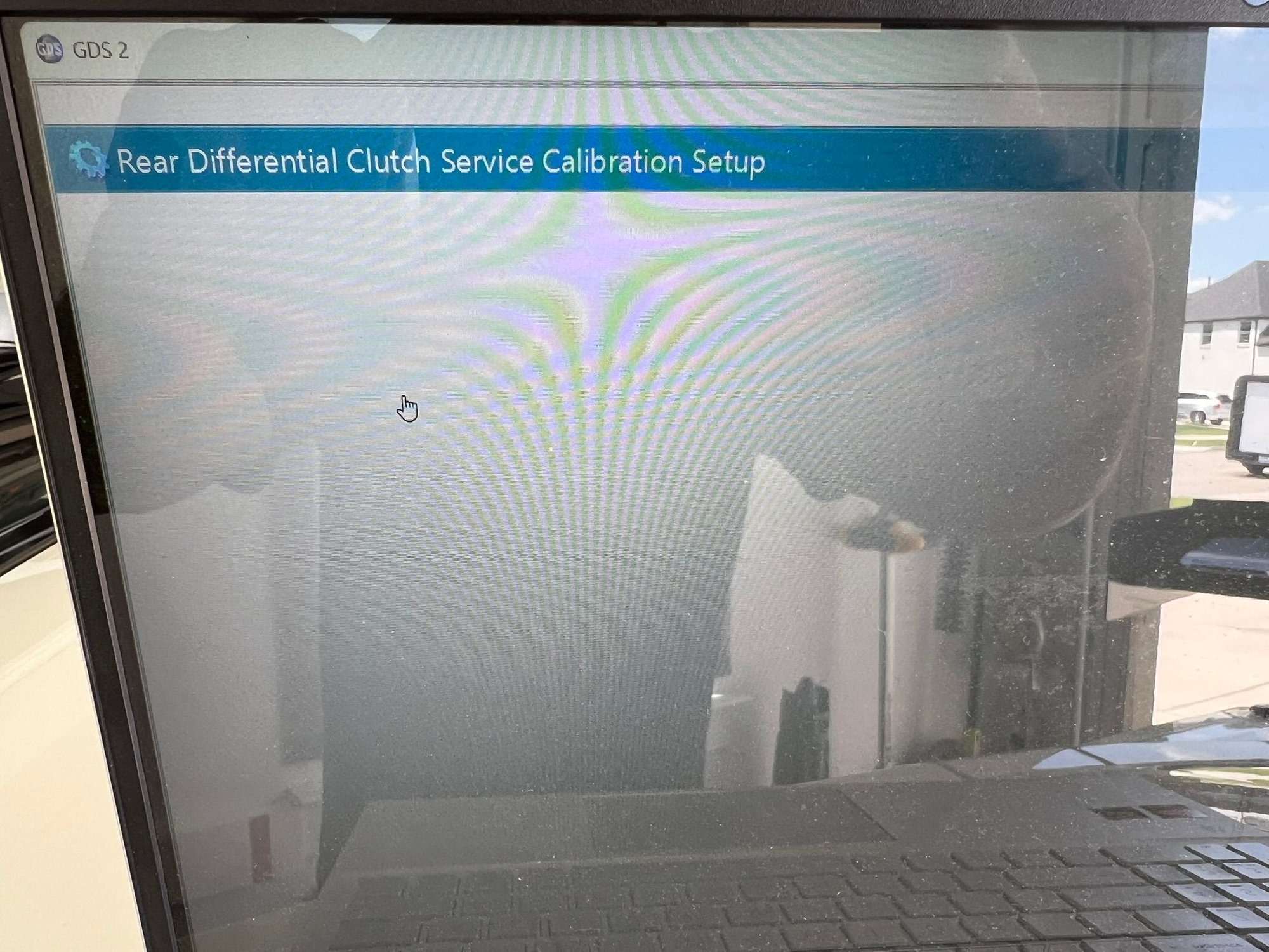

I literally got back home today. Once I get settled in, I'll take a look later this week to see if the VX Nano works
Old Jul 18, 2025 | 04:33 PM
96GS#007's Avatar
96GS#007
Joined: Apr 2000
Posts: 15,344
Likes: 4,009
From: Texas
Originally Posted by jimbob8915
So any more information on the correct scan tool to eLSD service?

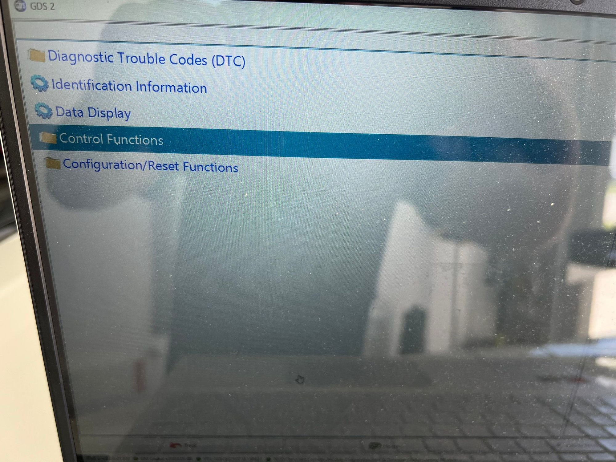

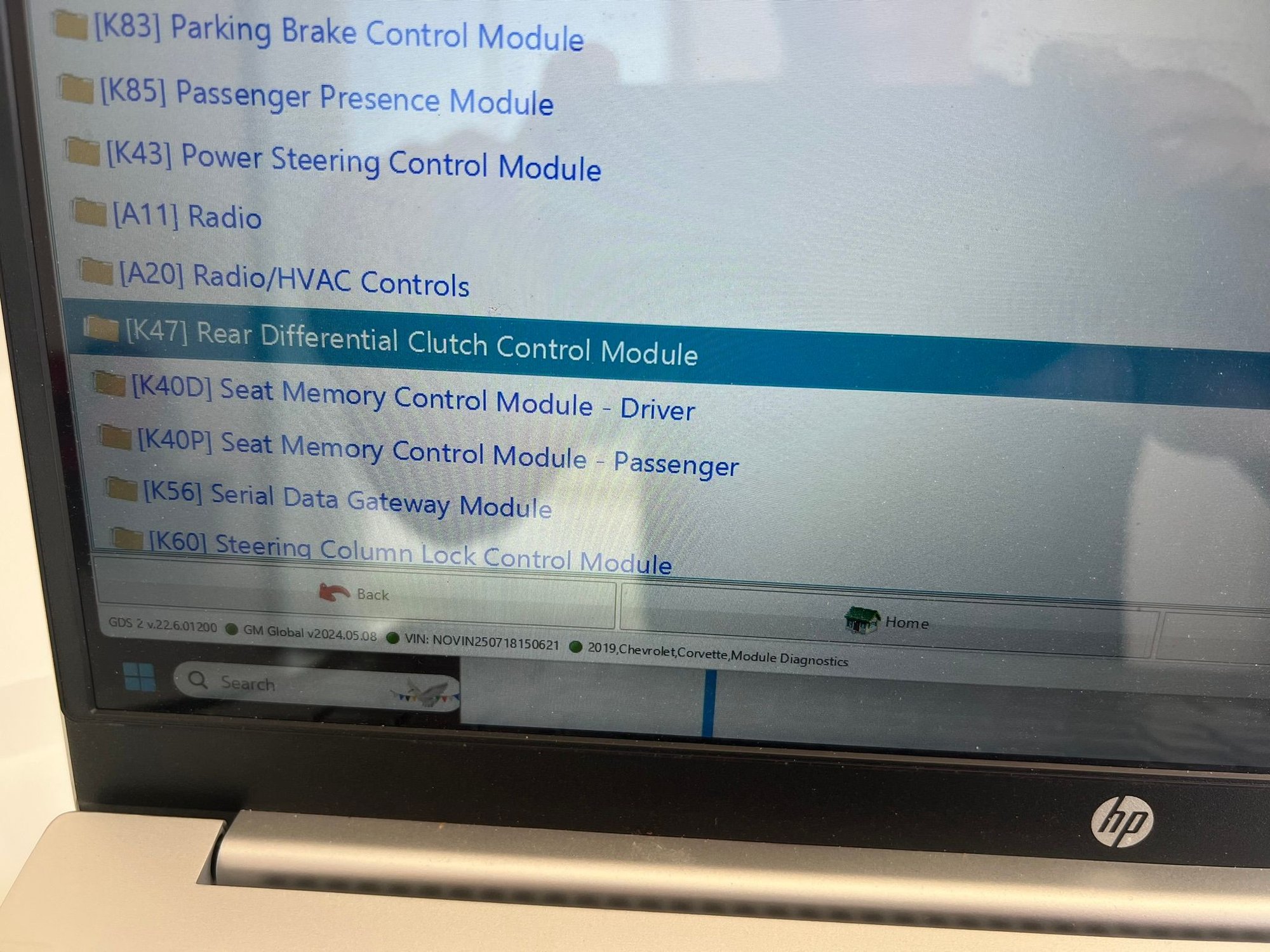

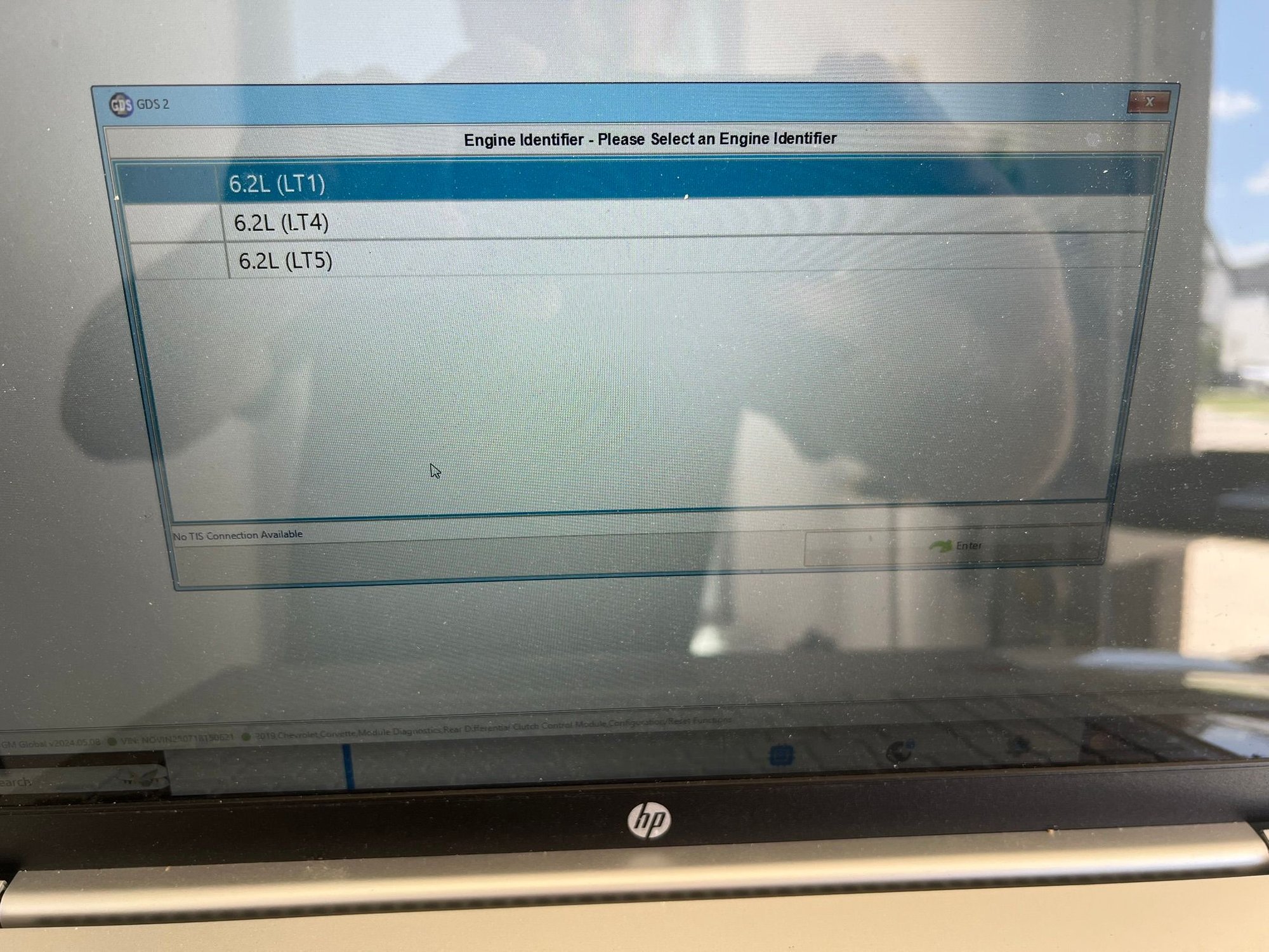

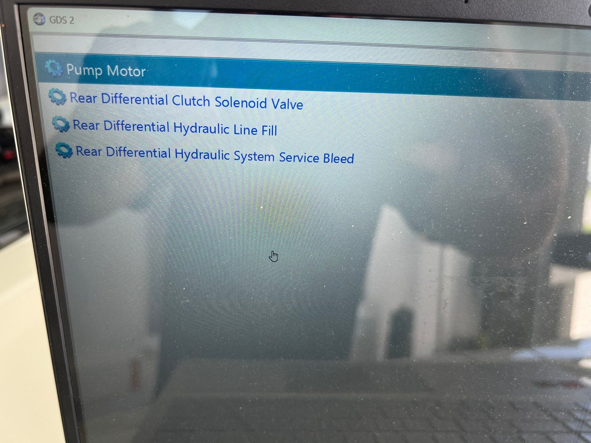

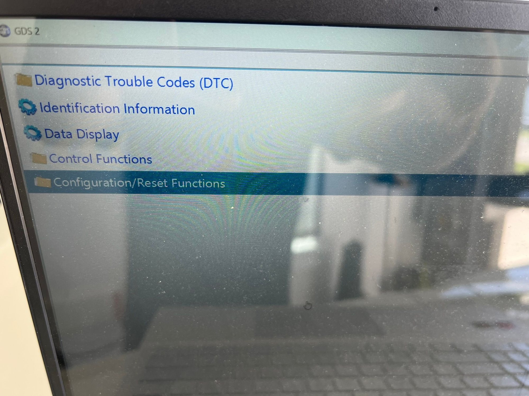

Finally got around to this. I will say that VCX Nano....at least for me....is a pain in the *** to get up and running. Could just be that I rarely use it so I'm out of practice.
Anyway, long story short is that the functionality is there. Obviously I wasn't going to run the actual bleed but yes...it's a button push away. The car does need to be running per the Service Manual and if it's not you get an error. I didn't want to experience "no good deed shall go unpunished" so I left well enough alone. 100* here today so I wasn't in the mood to play around in the interest of science.
Right off the computer screen....
