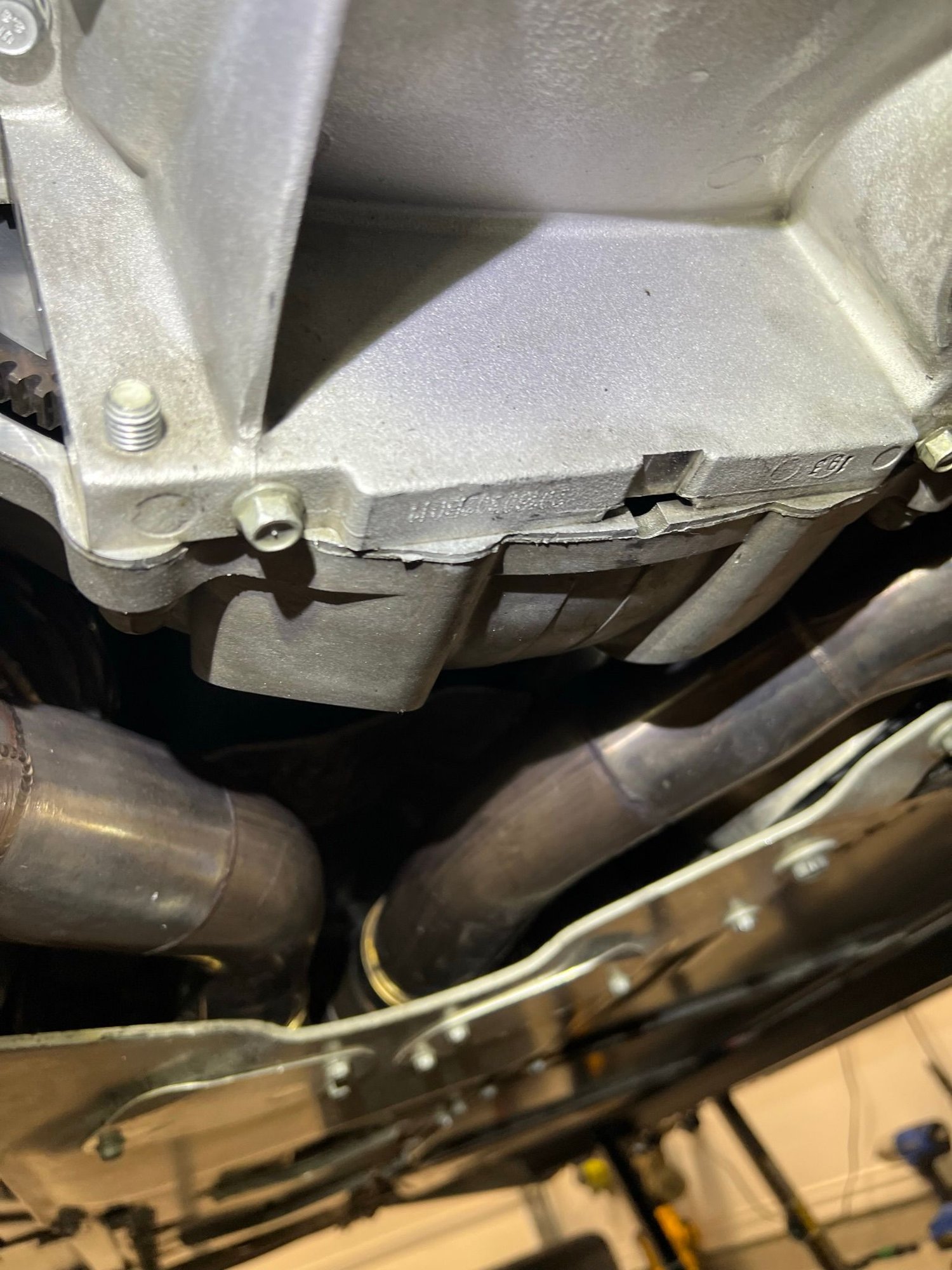

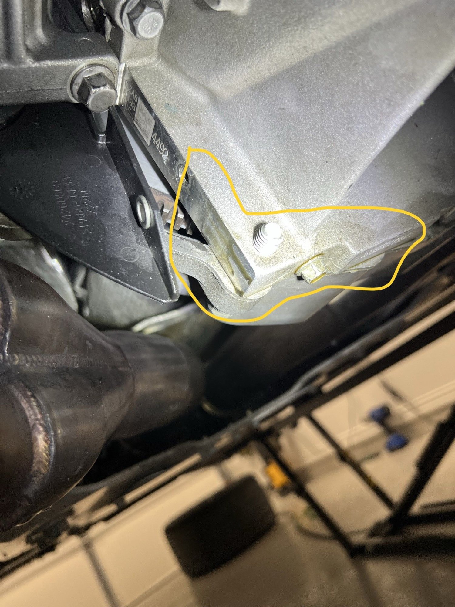

Post track day inspection and I seem to have developed an oil leak. I've looked all around the top of the engine (including using a borescope) to see if it was from the intake, valley cover, valve covers, etc and there's no evidence/sign of oil. From underneath, the drip is at the bottom of the pan on the bolt closest to the starter. Peaking inside the bellhousing, the flywheel, clutch, and interior surfaces are all dry so It's not the rear main seal
Seems to be the right rear corner of the pan, above the starter. I attempted to retorque the bolts but apparently the prior shop I used either didn't bother with a torque wrench or overtightened them. The spec is 18 lb/ft and the torque wrench immediately "clicks".
The oil pan is a huge pain in the *** to remove. I despise leaks of any sort and in this case I don't need oil blowing onto the header during a track day so I'm looking for ideas of how to crutch it vs straight to removal.
I was thinking to drop the starter (pretty easy with headers) and spread "The Right Stuff" around the perimeter as best I could. Any other thoughts? Some pics for your viewing pleasure....

Well....just a quick update. I torqued all the pan bolts as mentioned before. However....the one with the drip just more than finger tight (keeping in mind the torque spec is only 106 in/lb). If not for sealer, I'm pretty sure it would have fallen out eventually. Cleaned everything to within an inch of its life. I used a lot of brake cleaner in the hole and shooting it up to the block and kept spraying and cleaning until it was clean drips. I then applied some gray "The Right Stuff" sealer (well worth the added cost IMO). I gobbed some sealer on the threaded portion of the bolt (except for the first 1/4" of the threads so I could get it to engage) and around the bolt head and then torqued it. I let it sit overnight although this sealer is a "1 hour Return to Service" type.
I've since taken the car out on public roads (get some funny looks with all the aero and the numbers and such ) multiple times. Close to 80 miles of driving. Highway, stop & go, Blasts to 6000rpm +/-, etc. So far....fingers crossed...no leak.
I probably just jinxed myself. Regardless, at least it seems "manageable" even if it is leaking. If I have a minor drip every couple hundred miles, I can live with that for awhile. What I can't live with is oil blowing back on hot exhaust in the middle of a track day.
