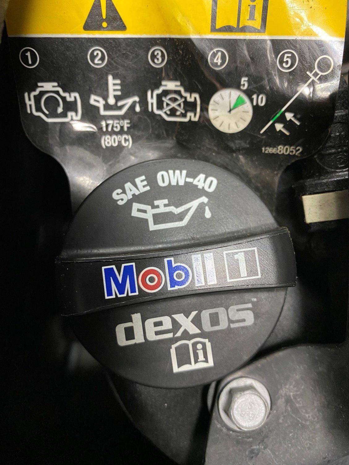

For Dry Sump engines (all Z51, GS, Z06 and ZR1s) the key item here is the engine temperature. The OIL Temperature (not coolant temperature) needs to be at least 175 degrees.
My Dry Sump Reservoir has this label attached to the oil filler cap:
Bill
