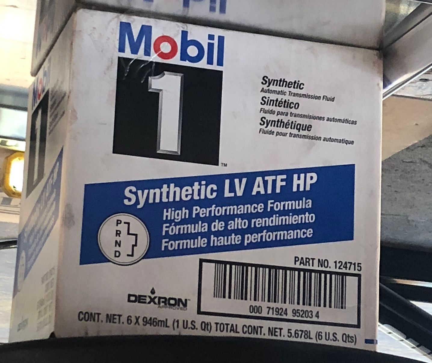

Anyone know the fluid used in the flush?
