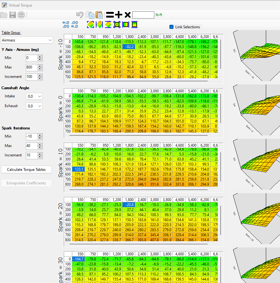

I will say that increasing the left side of the Immediate table (ie instead of -25 going to -35 for instance) should slow the throttle return when you let off the gas. Too much of a good thing and the throttle will hang.
In the Virtual Torque (VT) tables you'll want to look in the ~1800 rpm range and surrounding areas. You also have to know via data log what timing is being used by the car. There's not just a single table. They go from -10* advance to +40* A snippet of mine....
Frankly, although the setup you have is lighter than stock....It's not that much lighter. 16lbs is pretty minor. For sake of caparison, mine is 47lbs lighter.
It makes me wonder if they need to move the Adaptive Idle tables back closer to stock. This is speculative without a log and seeing the tune. Driveability takes some time and the more mods the more time it takes. WOT is the easy part.

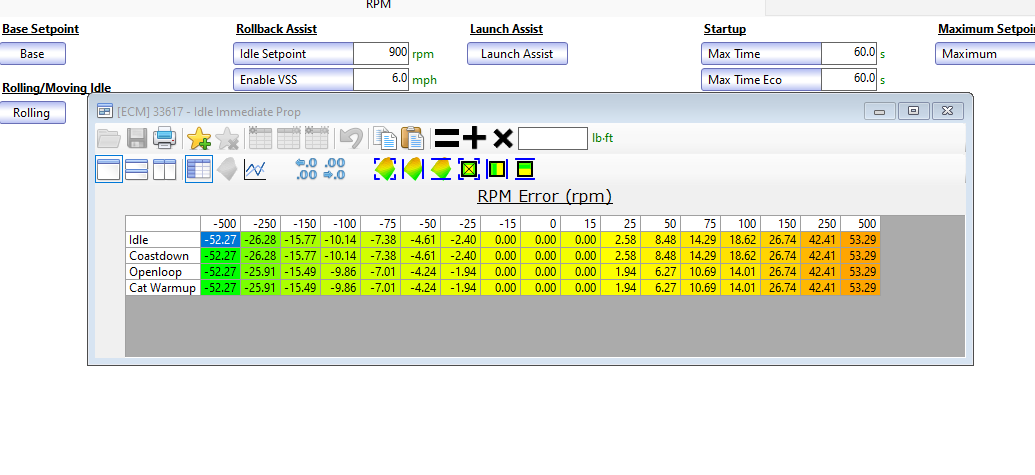

To give you an idea of how things can vary (or not), even in stock cars, below are the Adaptive Idle Immediate Speed Control tables
Stock 2019 Grand Sport

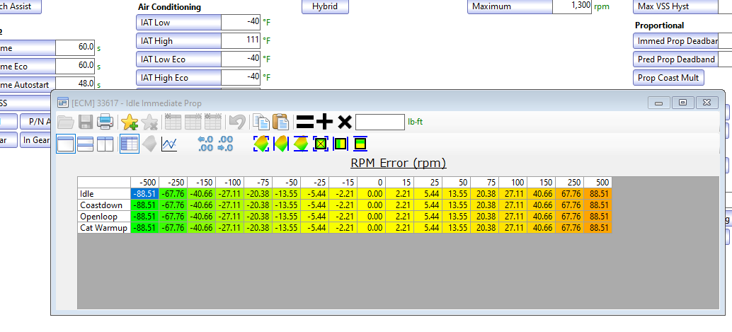

Stock 2019 ZR1
Cars you'd think would be similar to the ZR1 are instead identical to the 2019 GS. 2022 Camaro ZL1 is the first table and a 2019 Z06 is the second one....

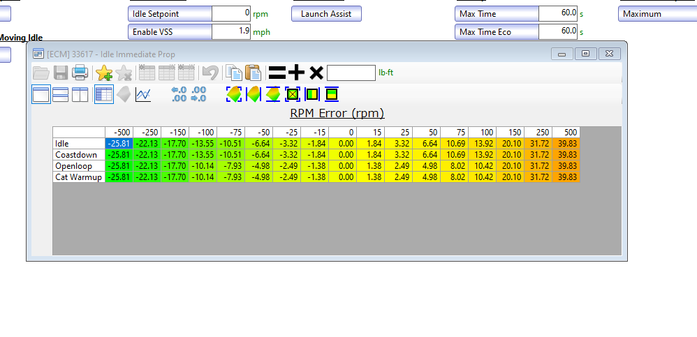

Here's what's in my car currently....
