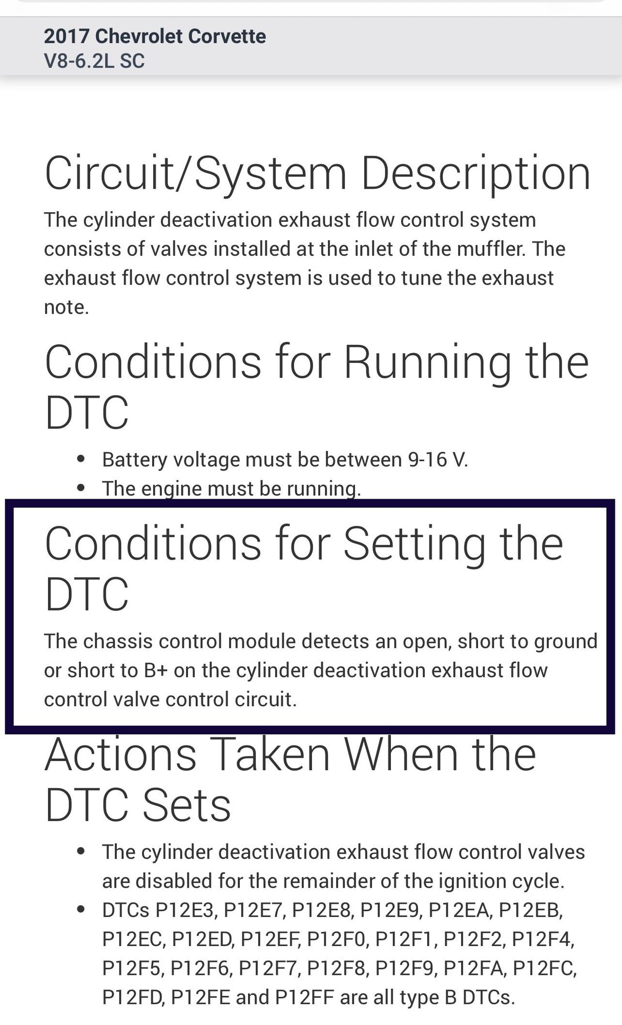

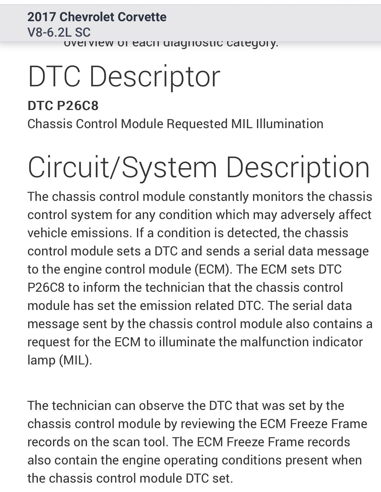

Both code descriptions are below…your “code reader” will not be able to read the trouble code stored in your chassis control module…to diagnose the P12EF you will need some electrical skills to check the exhaust flow control valve circuit…open, short to ground or to B+.

  • P12EF Chevrolet Cylinder Deactivation Exhaust Flow Valve Stuck Closed Bank 1
What it is telling you the left bank 1 valve is stuck closed. Since you are using simulators and there are no mechanical valves present you may just have a bad actuator. Since you went into eco mode the valve would close depending on the system saw and it did not reopen or the actuator is some how is stuck in the simulator.

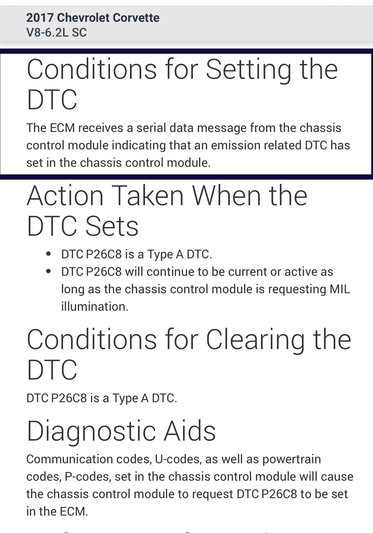

The P26C8 is there because of the P12EF once the that it is cleared/repaired and you go thur several engine cycles it should go out.
