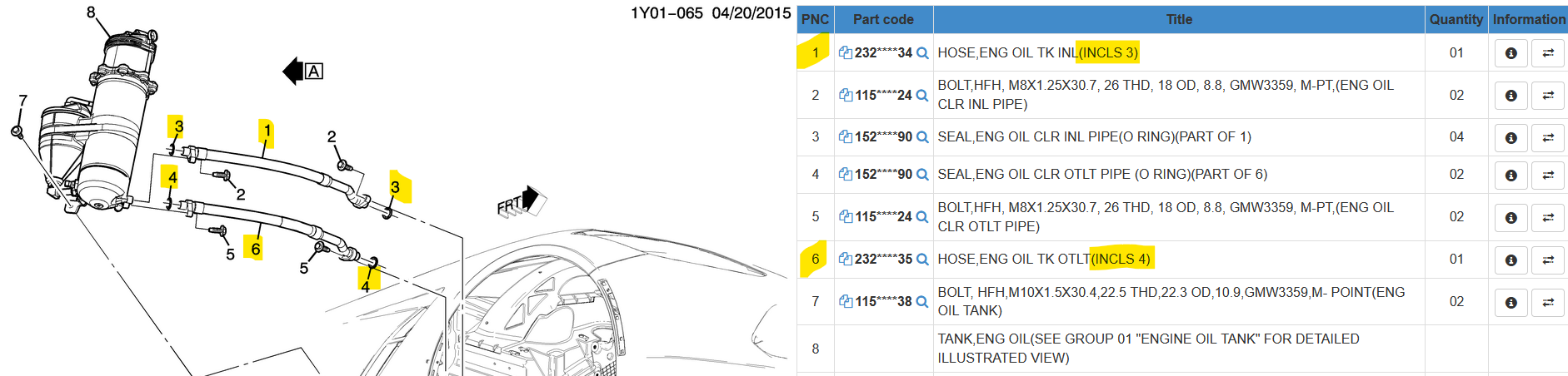

Anyone know the part numbers for the 2 dry sump hoses? Can't find them for the life of me.

23299434 Engine Oil Tank Inlet Hose Assembly
23299435 Engine Oil Tank Outlet Hose Assembly

The Dry Sump Oil Hose Seal Part number is: 15217990. I doubt the lines will come with new ones, but I'm not 100% sure on this, and you will need two of them, probably four since the hoses are completely off (I have only taken them off from one side so not sure how many of these seals you ill need or if there are two different seals, but you will probably need four new ones). Hope this helps if you didn't already know the part number for this, took me like 2 hours of searching to find when I needed them after pulling my motor.

Do we have a solid confirmation on the part numbers? If so, I'll tag this with a "Solution" button.

The lines are what's listed in the GM catalog and it shows as coming with the o-rings (15217990) as well. As always, the responsibility falls with the buyer to verify at time of purchase since GM has been known to change things. However, these part numbers have been consistent for a long time.
