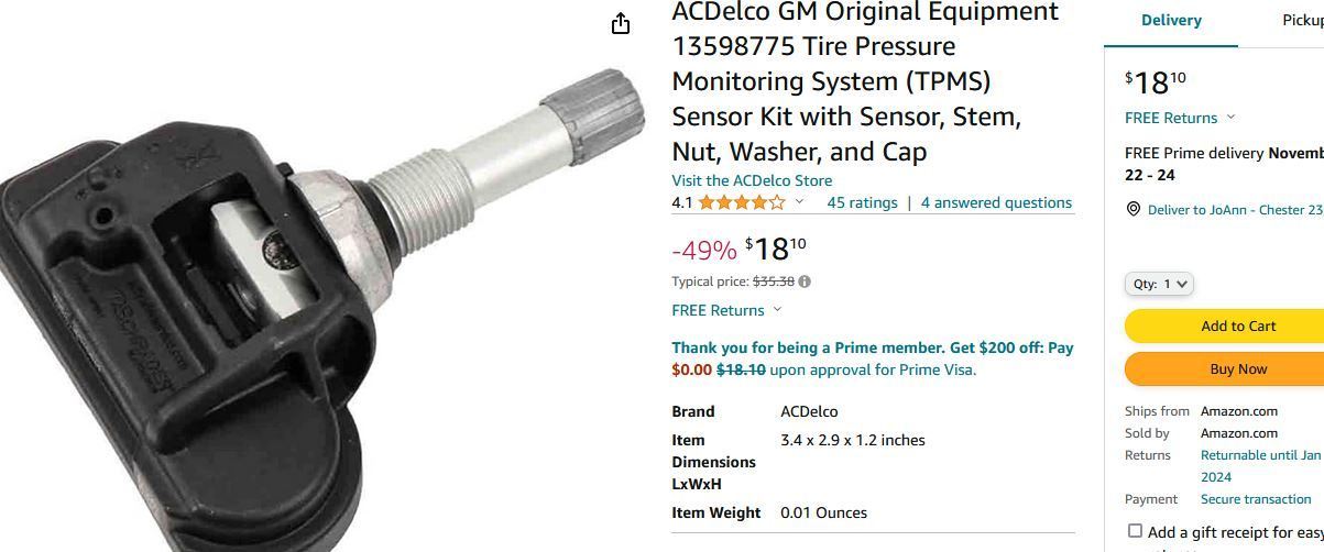

Inexpensive GM on Amazon -

  2. Does e.g. one OEM/GM/Schrader sensor work across the entire GM range? (That Amazon ad says ACDelco but you can actually see the Schrader text on the body of that TPMS sensor -- I have a dead one in front of me).
