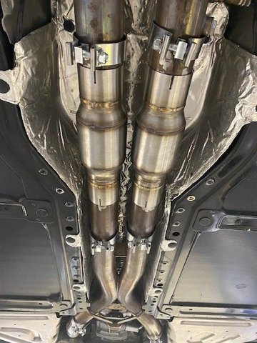

I recently had headers and a catless x-pipe put on my 2014 Stingray, and had it tuned. The exhaust smell is horrible. It smells like the car is running extremely rich. I realize that without catalytic converters there is going to be smell. I had a C6 with the same setup and the fumes weren’t near as noticeable. Is this due to the direct injection of the LT1, or is it a bad tune? I’m almost to the point of putting the stock system back on.

If you want to keep the headers, have bullet cats installed. Keep in mind they may or may not clear the tunnel plate. For instance on mine I have 1/8" spacers to gain tunnel plate / bullet cat clearance. Do keep in mind that excellent bullet cats are not cheap. However, having a stock cam you should be able to get buy with some that are ~$300ea.

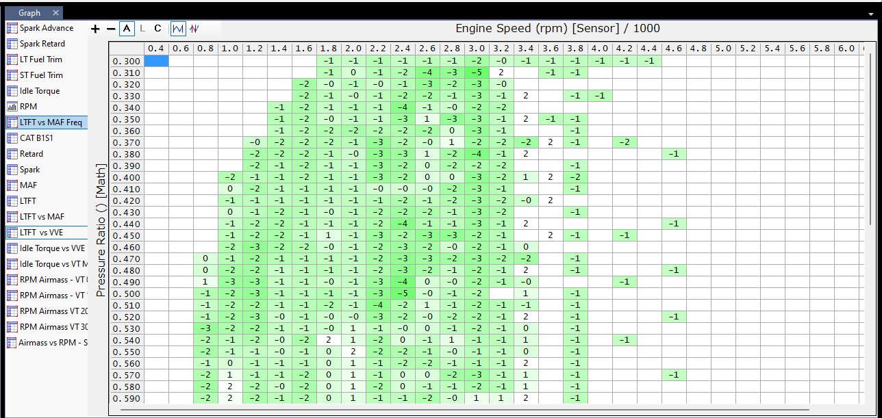

Here's mine (all idle and part throttle tuned with the OEM narrow band sensors), with a Stage 3 GPI cam, headers, heads, 103mm throttle body, MSD intake (all of which are ported), etc....
