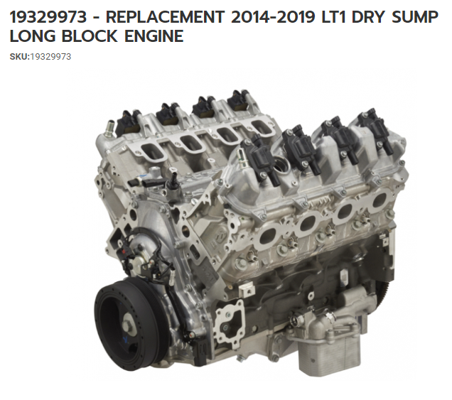

I would look at buying a New GM Crate Engine with a warranty & should be a drop in. Main issue is cleaning all the debris out of the oiling system before new engine install

Old Dec 5, 2023 | 05:52 PM

s sorry to disappoint but in light of all of the risks in buying a salvage engine, then all the possible complications of installing, I abandoned that idea and instead bought a new GM crate engine. I had a local professional (Bentune in Oronogo, MO) install and have several thousand miles on the new engine. Total cost was about $12.5 The local Chevrolet dealer wanted $19.5 for the same engine.
Still expensive but I’m pleased with the outcome and have a GM 3 yr/100K mile warrantee. Installed a new clutch/pressure plate while we were at it. Cost $500 but installation was free!
