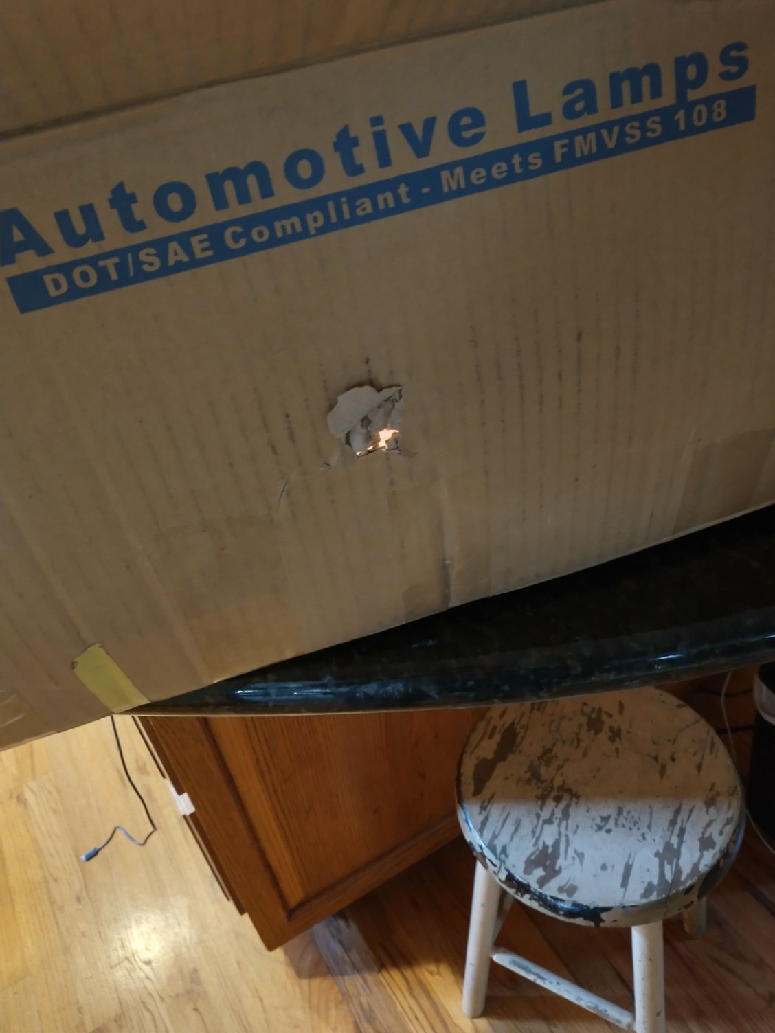

Well good news,,,, really bad news. It took 22 minutes to remove the front bumper. Good news, it wasn't the bulbs,,,,, really bad news, it's the headlight $600 I purchased. After market TYC. I tried 3 different bulbs, and tried plugging it into the left side, nope it doesn't work.

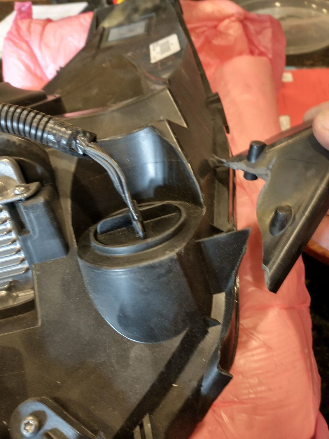

Well this makes my head really EXPLODE! I got the used OEM headlight,,,,, F-ing UPS smashed the box and broke the tab off the headlight..... . The broken tab is why I started this headlight replacement in the first place.

How frustrating is that!!! As if getting the parts isn't hard enough - SMH
Can you post a pic of the broken tab and mount area?

The fix is a bit messy but it will be hidden. I used super glue to hold it into place so I could match the piece perfectly, then I used JB weld strong as iron epoxy. with 3 layers of fiberglass, kind of like repairing fiberglass body parts but with epoxy.

Nice job-I was figuring you could do something like that! Moving forward as parts become more scarce, it's fixes like this that will keep our C7's on the road.

Very frustrating, I tried to challenge the sale on Ebay and was turned down. This wasn't the shipping company's fault. The guy selling the headlight on Ebay lied about the light. He said it was in perfect condition with all of the mounting brackets. That was a lie. Plus he didn't package it correctly and it was broken during shipping. He used way to small of box and the side bracket smashed through the box and broke off. Ebay said because I messed with the light, "fixed it", I couldn't get my money back.
