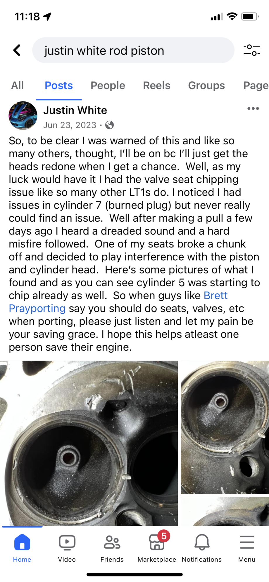

Hello all, I bought a 2016 M7 Z51 a few months ago and I am planning on building it over the next year or two. Goal is to make 850-900whp with a V3TI. Car is currently stock.
I've been trying to read up on the LT1 heads but there are not many forum posts on them. From what I've learned, the heads on the LT1 have almost the exact same issue as the LS7 heads with dropping valve seats/valves.
With that being said, what good options are there for aftermarket LT1 heads that are affordable? Not looking for a set of 4-5k heads.
My first round of mods will be GPI drop in rotating assembling, BTR stage 3 cam, head work, and DSX flex fuel kit, then when I have the $$ do the V3TI and MSD/LT5 TB and fueling.

LT1s do not have the same issue as the LS7 which was about the valve guides (hence the “wiggle test”). The only LT1 issue has been broken valve springs. Even that is few and far between when you consider the 10s of thousands of cars out there. You’ll be replacing the factory springs due to the cam you’ve selected.
if the heads did have issues, the internet would light up, just like it did with LS7.

Not an LS7 type failure and without knowing hp levels and rpm, who knows the cause.
Regardless, if I was going to run 700+hp, I sure wouldn’t skimp on the heads. Fast, cheap, reliable….pick any two.

I saw that post too. It’s the first I have heard of it but he’s a big name with the LT1 so I’m sure he’s seen it. As mentioned, no idea what conditions these engines were run under. Hopefully it’s not a huge deal as I just finished getting my cam/heads done with stock valves.

JW (big ctsv tuner now focusing on LT) also ran into a similar issue.

....and it clearly says when porting the heads.
As soon as you start messing with the factory stuff like that, all bets are off. If you use the factory heads "as is" with the exception of the correct valve springs, it's exceedingly rare to find a problem. There are probably 100k+ Gen V LT1s out there running around. If there were head problems like the LS7, you'd know about it. The LS7 issues were on Stock heads on Stock motors.
You've already decided that there's an issue. As such, have the heads worked.

You have not been reading the internet enough or not making serious power, LT1 heads have valve seat issues.

It's not just ported heads, plenty of stock heads are breaking valves or chipping seats

Brett (Pray Porting) has said that it is a combination of the increased RPM above the stock RPM limit along with the cam lobe being very aggressive on some cams causing the valves to jump and slam into the valve seats which eventually can cause the issues with chipping the seats.
