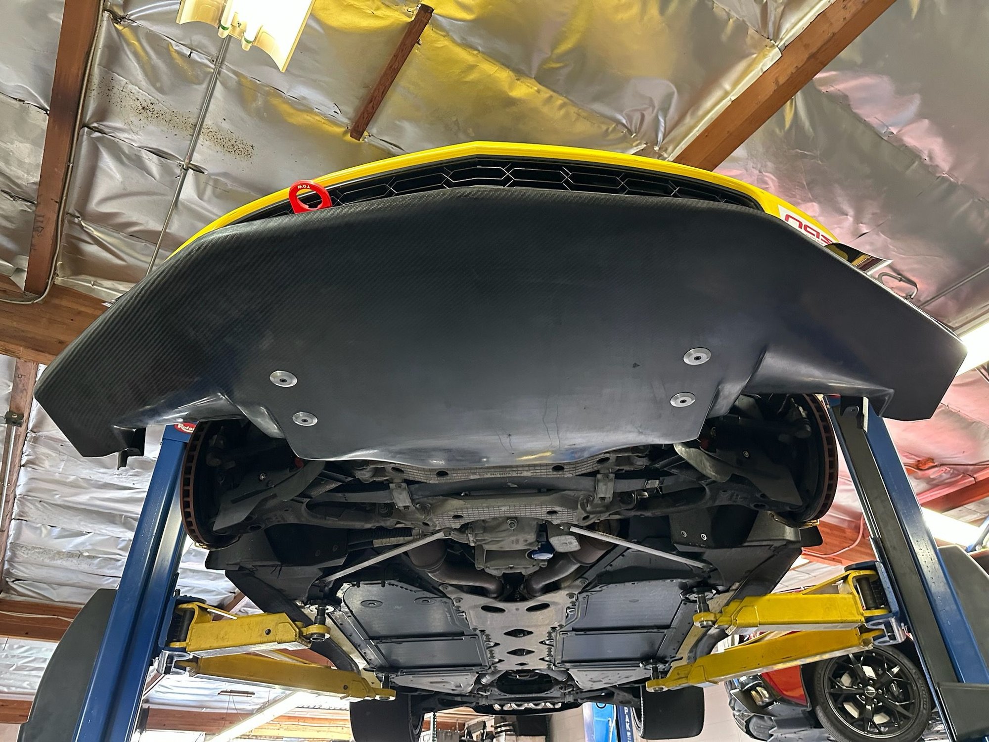

I know what your saying. I've toyed with the idea for a couple years now of making a full flat floor. Most of the floor is flat, I run a very large tunneled front undertray which makes a lot of downforce (pic below) but always wanted to finish the floor and create a rear diffuser that will prevent drag from under the car as well as make some more downforce. Never took the time, our car is very fast on track and makes a lot of downforce but I know it could be even better with a complete flat floor and functional diffuser. If you do it, post it up id love to see how it goes. Maybe one winter ill design one and try it out for a season.
