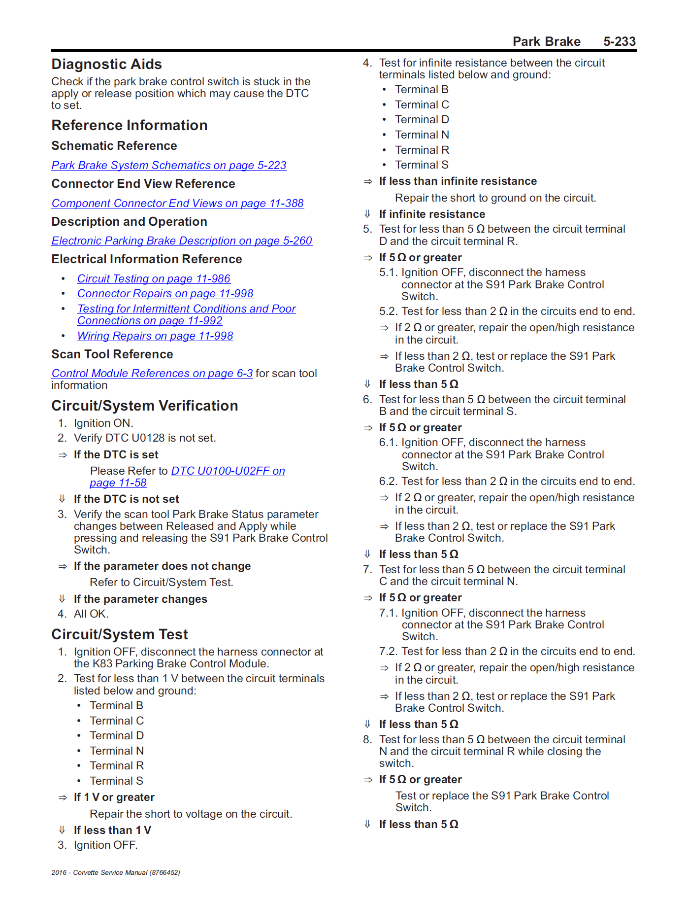

Originally Posted by KirillG88
Anyone ?
I still have these 2 errors U0421 and C0298 08 Park Brake Unlatch Switch Circuit Performance - Signal Invalid, I guess that the U code is coming with the parking brake code, maybe it's related to the same circuit , anyway, I have tried to replace the parking latch/unlatch switch but the issue didn't go away. Recalibration from the diagnostic tool is working, so from here I guess that the module is ok. Looks like there is some communication issue between the switch and module
The U0421 code indicates the module isn't configured correctly, however, the FSM says if you have other DTCs correct those first before worrying about the U Code.
The C0298 08 code means there is something wrong with the parking brake and you have noticed something wrong with it.
Once you have that problem resolved see if you still have the U code and only the U code. If the U code is the only remaining code then reprogram the device described by the DTC descriptor, if the U code is still set after reprogramming the device then replace the device and test again. If the code is gone then you are ready to go.
Bill
Bill
Thanks a lot for the pages from the SM !! For some reason, I don't have these in my SM. This will help me a lot. And yes, you are right 200% , once I solve the parking issue, the U code will go away for sure.

Originally Posted by CPB
What were the results of ohm testing?

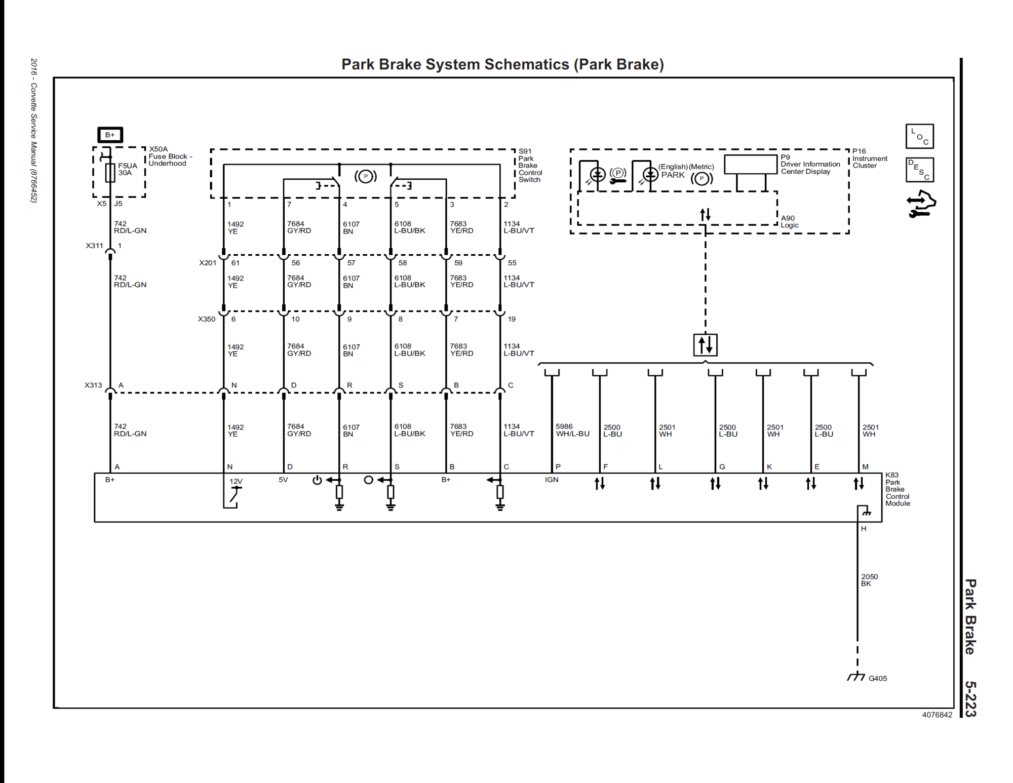

Made tests as per Bill's guide from SMCircuit/System test :
Test for less than 1V between the circuit terminals B,C,D,N,R,S - ALL OK
Test for infinite resistance between the circuit terminals B,C,D,N,R,S :
Found as follows :
Between B -> S 1.1 ohm
Between D-> R 1.1 ohm
The rest is infinite.
If I understand correctly I need to replace the Parking brake module, right ?

Assuming it was sub 1V on B,C,N,D,S,R?
What about resistance check on:
-C and N
-N and R
-C and N
-N and R
C and N infinite
N and R infinite

From: Louisiana
Sorry the flowchart is more like a flow paragraph.
Just clarifying your test.
B,C,D,N,R,S to ground all tested as 1.1ohms or infinite (Greater than 5Ω)?
As I understood from the service manual I had to test the resistance between each other, or I misunderstood something ? If we are talking about resistance tests between each other, so all the tests show "OL" - which is infinite, right ? Except for 2 which I guess is normal (or not ?)
Between B and S 1.1 ohm
Between D and R 1.1 ohm
Should test them each to ground at step 4. 0 will be infinite, which is "greater than 5." Basically infinite resistance in this test would mean they aren't shorted. The manual describes this strangely.
Probably missed the step where being said to test them to ground. Will do ground tests and give the results
