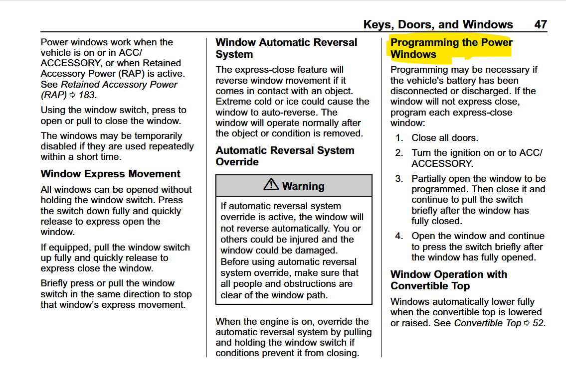

Sorry to be so ignorant but what do you mean by index your windows?
Old Mar 31, 2024 | 07:46 PM
96GS#007's Avatar
96GS#007
Joined: Apr 2000
Posts: 15,344
Likes: 4,009
From: Texas
Been around since the C6 arrived on the scene for the 2005 model year
It's explained in the Owners Manual (which is available online as a pdf file for free)
