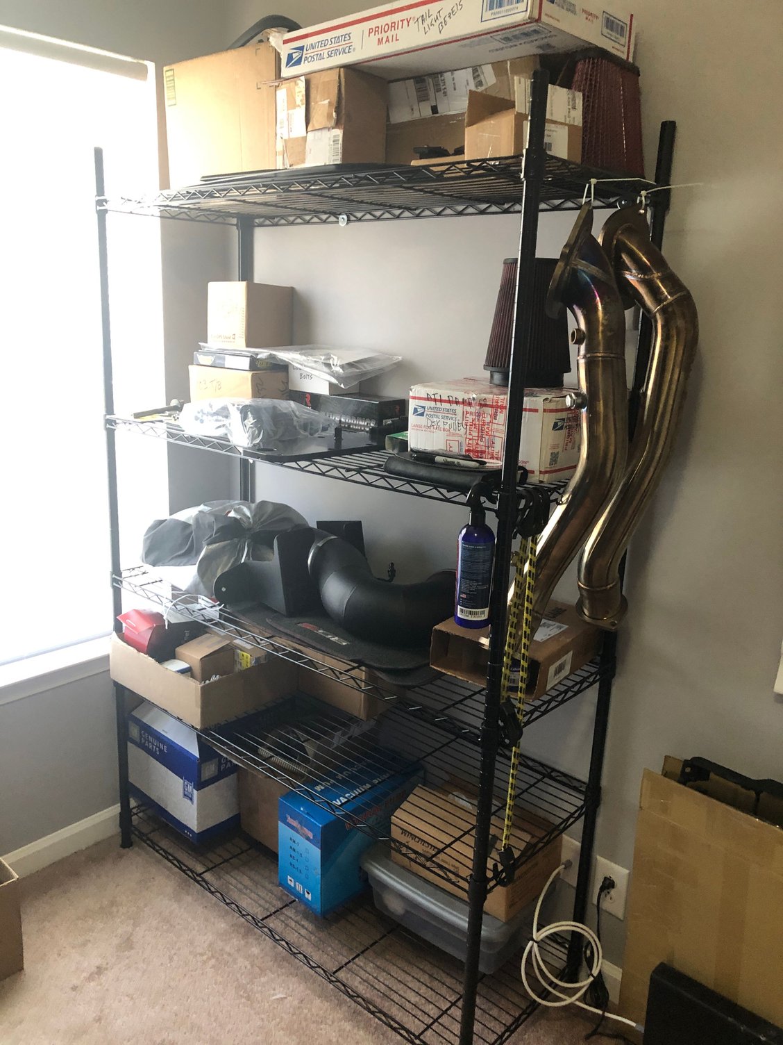

so to start understand I do all my own work so I cant comment on any shop other than most charge 125-175 per hr. as for what to replace the heads have to come off so its basically a top end tear down. may as well drop in a cam double springs pushrods and lifters. when it comes to lifters its also the trays that fail allowing the lifter to turn and wreck the cam. so I use link bar lifters and eliminate the tray . not cheap but very reliable. trunion kit for the rockers so the needle bearings dont fail. bigger cam for the chop and ad more fuel . I dont care for the phaser lockout on the cam so I do a complete vvt delete. no need to allow for advanced Tim ing the new cam is already a bump. collecting my parts from the forums from guys who bought parts and never installed them (all new in box) I have about 5k$ so far. guessing about 7k$ from a shop would guess another 5-7k$ in labor then tuning.
you could just pull the heads tune out the dod replace the lifters with some ls7 ls springs and pushrods and drop in a vvt cam from gpi or btr but seems a waste to me . if im going to get dirty I want to see the most bang for the buck. im forced induction so I see more of a hp bump than a n/a car will.
im sure theres someone out there with 100k on the motor and no issues from the afm/dod but to its a vette why would you want 4cyl in the first place!! I ran a range device from the day I got the car (14k miles) to approx 20k miles then had it tuned out when I tuned the bolt ons. will do a permanant delete when. I drop the motor this winter approx 25 miles by then . have had zero issues and may not see any wear at all when I tear it down but my goals are 750-800 wheel and I drag the car so im not taking any chances. this was about a yr of sourcing parts for my build. many more parts added since then.

Looking at your numbers, we are talking about $14K at this point. From past experience, mod bills never go as planned. Always higher, never lower. For that kind of money, I probably will go with a 378ci package from LPE making 600HP with a 3 year 36K warranty and be done with it. At least that caps the price and has a warranty and improved performance.
Looking at the BTR kit for $1600 and if we add a few thousand for labor and end up with a $5000 bill, it might be a better option unless it is a race situation like yours. If it isn't too wild, you can get itchy and decide to sell it easier and upgrade to a newer series.
Maybe the better question is "What is the statistical likelihood of hitting 100K without an AFM failure?". I don't get why people are so indignant about a vette in V4 mode when it isn't being used. If I can cruise comfortably at 70, it can go into V2 mode for all I care as long as I can get V8 on demand. I just got AFM tuned out to buy myself some time, as advised by a couple of speed shops till I decide what to do. Probably going to get a cam kit that isn't too far from stock since I really am not looking for a lumpy cam.
