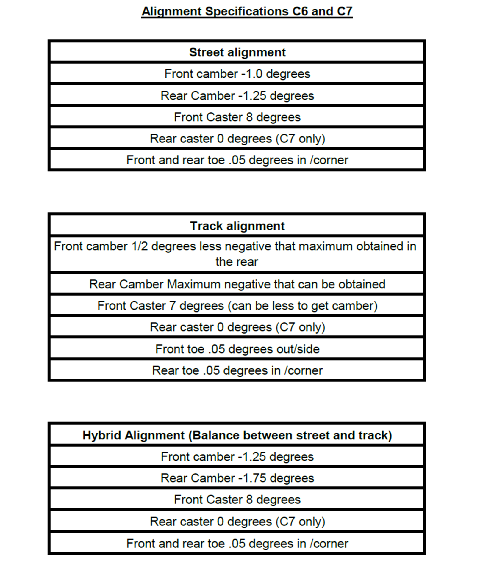

Alignment....again my opinion....I think the GM settings are pretty tame. I assume you're talking to Rich at Abel Chevrolet. I'd ask for something a little more aggressive.

I'm running what I consider to be a pretty a "mild" alignment, since I travel about 4-5 hours on the street one-way for an HPDE.
Camber:
-2.1F
-1.7R
Toe:
1/16" out front
1/32" in rear

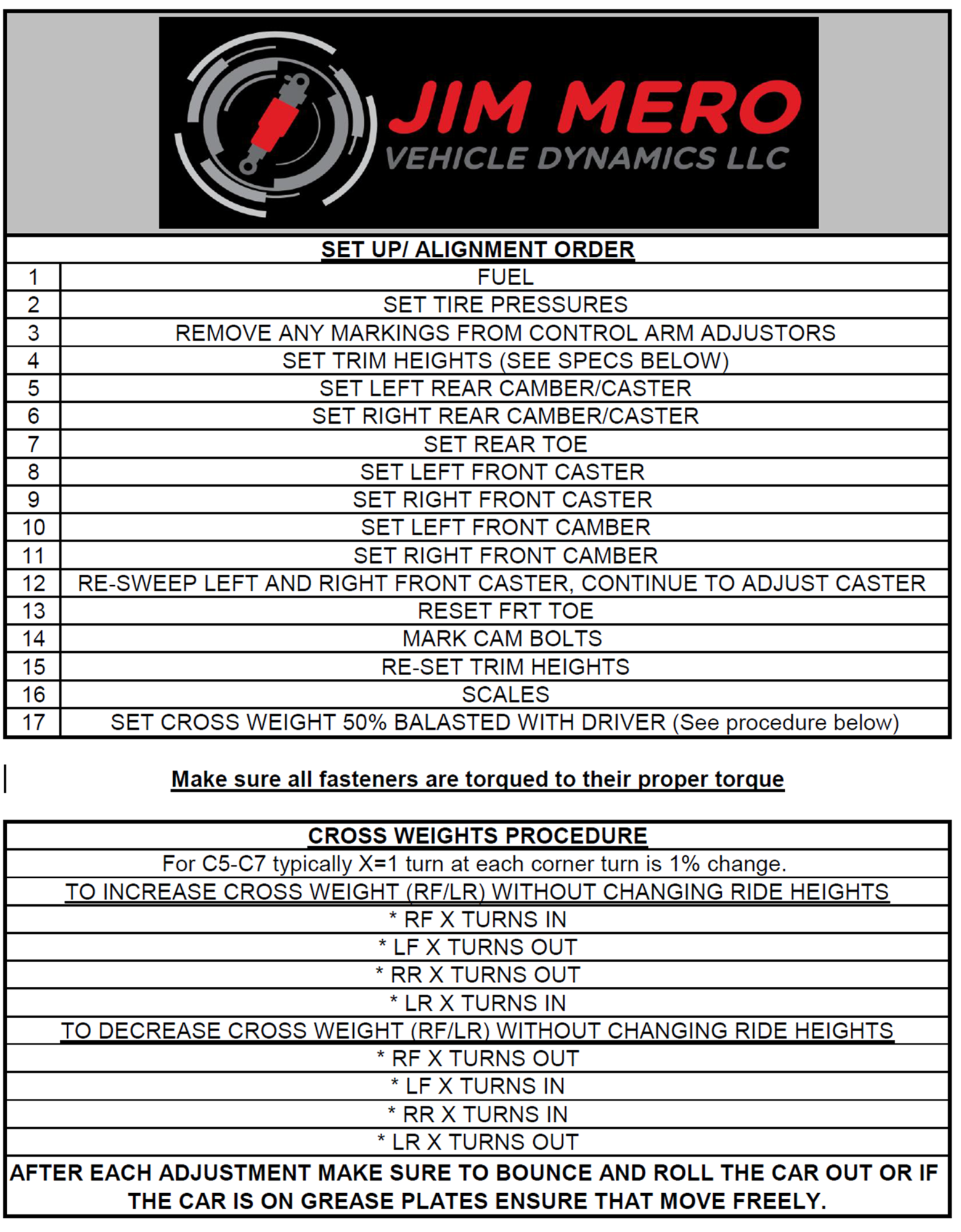

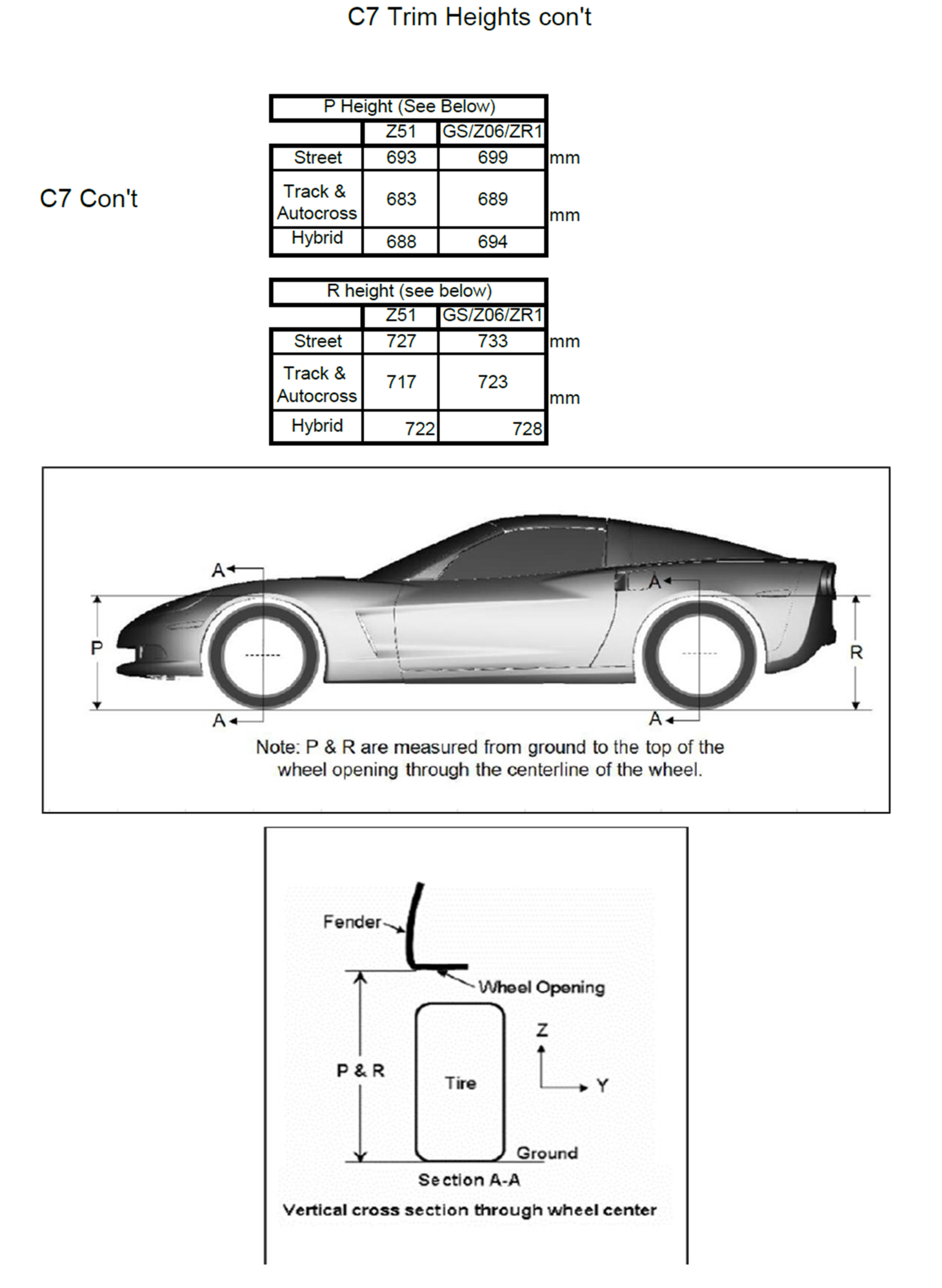

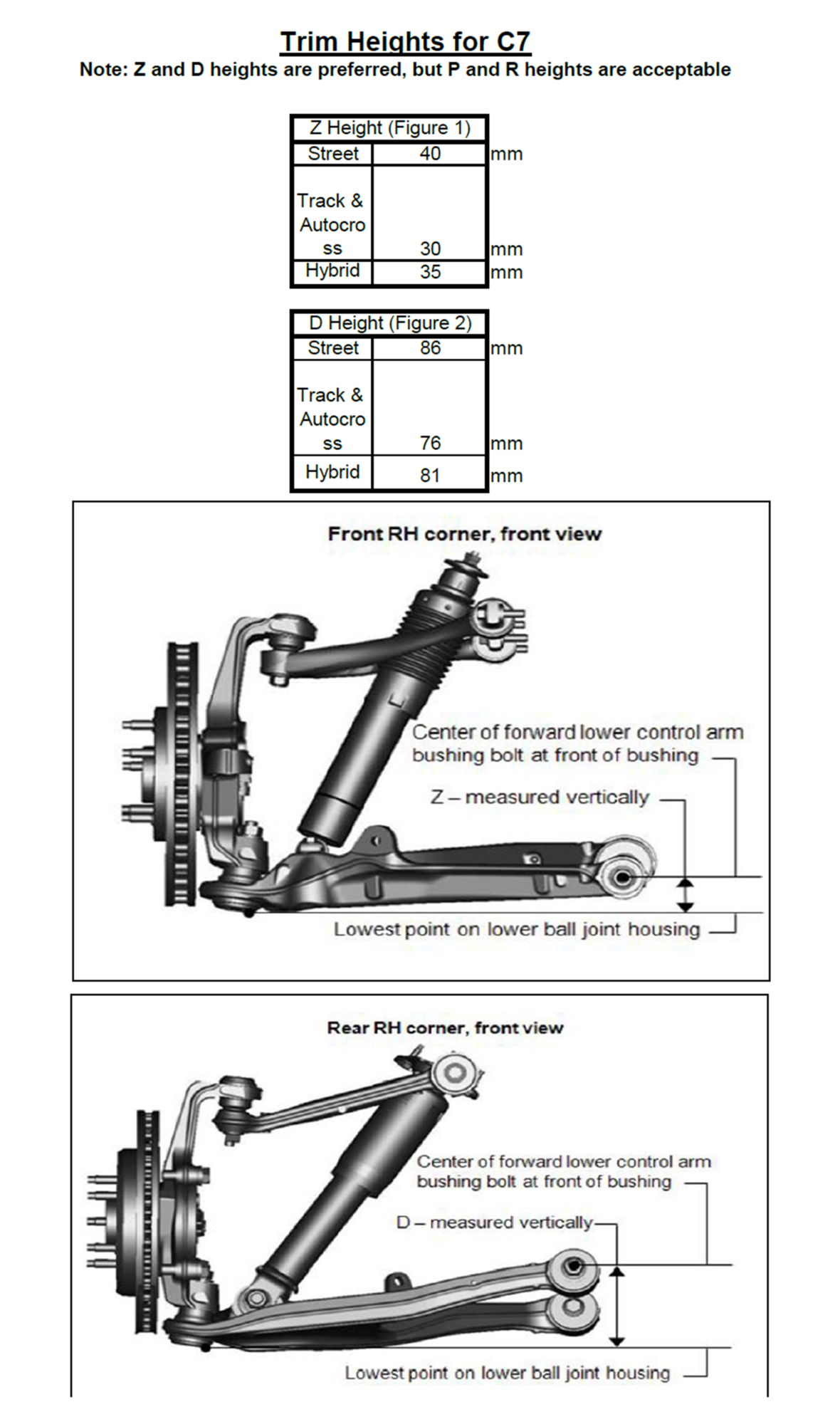

Going to Stage 3 with the tall end caps installed on the front splitter and a center wicker installed in the rear spoiler will create a lot of drag that can be felt on longer straights. I have a 15 Z06 and I can feel the added drag once the car hits 140 mph. A GS with Stage 2 Aero (small end caps on front splitter and no center wicker (basically street aero) can run pretty close to me.
As for alignment Jim Mero (retired GM Corvette Test Driver) says to set the rear camber more negative than the front camber and if you look at the alignment specs in the FSM that is what they show. Here is his recommended setup process:
I have been running my alignment with -2.2 front and -1.9 rear with 0 toe for several years. I am wearing out the inside of the front PSS ZPs while the rears wear evenly. However, the wear on the Pirellis slicks I use on track is different. The fronts tend to wear on the outside edge while the rears wear evenly. The Pirelli's seem to be able to last up to 45 heat cycles although the last 10 heat cycles tend to be a little greasy. I usually flip the front tires on the rim about halfway through the heat cycle range I plan on using them. If you are using nondirectional tires (run-flat excluding Michelin PSS or non-run flat) that is one way you can reduce camber wear on the fronts.
