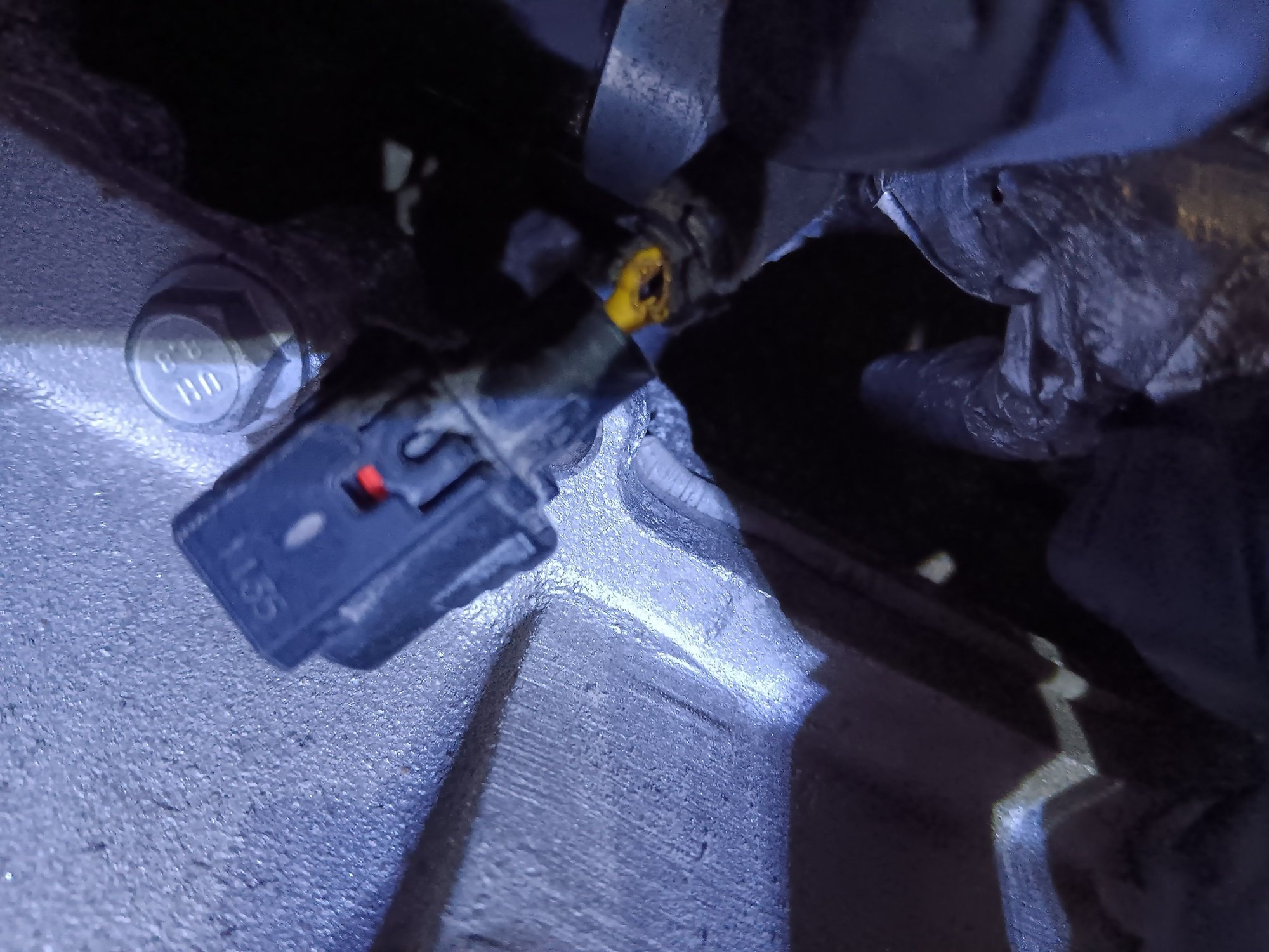

Old Jun 18, 2024 | 08:04 PM
Telco Tech's Avatar
Telco Tech
Joined: May 2024
Posts: 29
I tried to recognize this plug. Not being familiar with C7's was MY disadvantage. Turns out this was the solenoid activation lead. I looked at a pic of the starter and it dawned on me.

Old Jun 19, 2024 | 03:49 PM
Telco Tech's Avatar
Telco Tech
Joined: May 2024
Posts: 29
This is what i was dealing with. Before i started working on this car someone had back-pierced the yellow solenoid wire and twisted a lead around it. Why? SMH I dropped the starter down about two inches and was able to reconnect that lead. I had the car on jackstands about a foot high so it was tight. Once i made that connection the car started right up. The car is now at the dealer for some "fine-tuning" and not necessarily meaning the engine.
