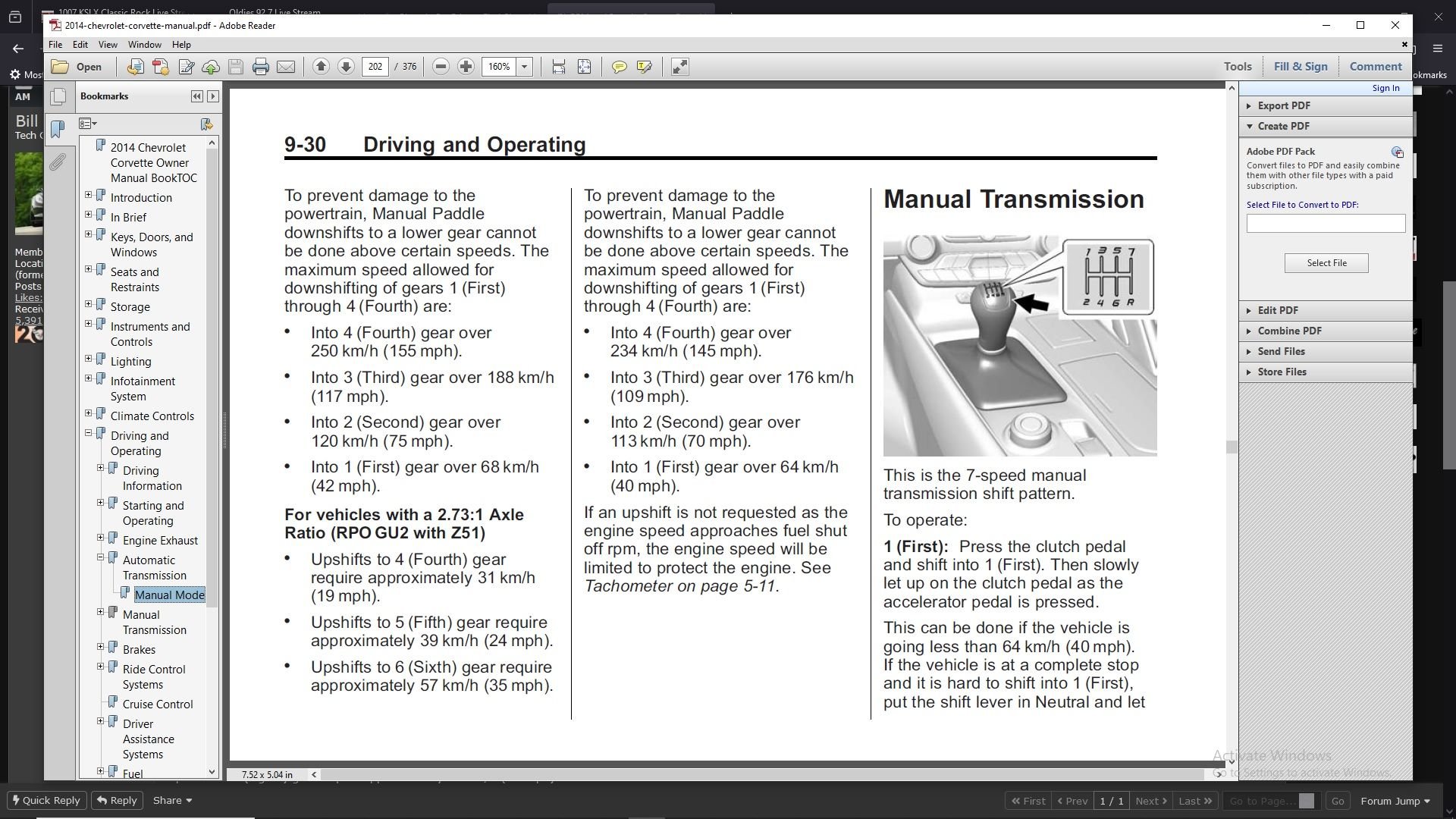

2014 z51 paddle shifts up/down, p 9-30
To RPM and Speed
