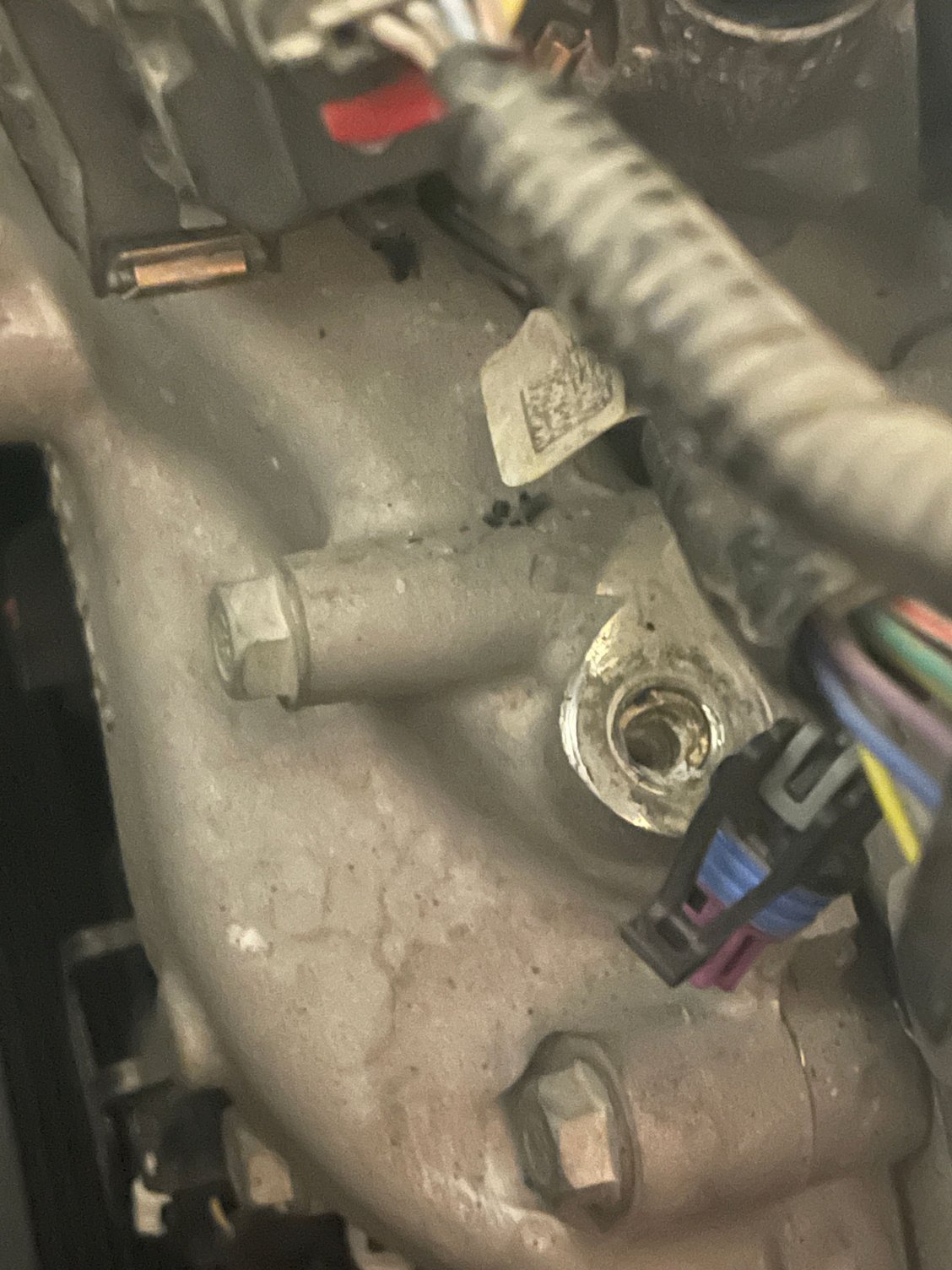

It's always fun to come on the internet and admit a stupid mistake. I replaced my thermostat a couple of months ago. Now when I quickly speed up, the temps go higher. I ordered a new temperature sensor and went to install it. Easy enough until I cross-threaded it. Even when I felt like ti was taking a little too much effort to put it in, well, I didn't quit and it broke! Now I can have it towed somewhere and fixed, or do it myself. Can I get it out easily? Anything I should worry about?

Can you post a pic of it? Might get some great suggestions

Here you go.

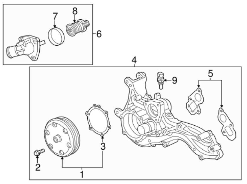

What year?IIRC the 2014 housing is different than later years.
https://www.cultragfactoryparts.com/...em--water-pump

If that happened to me I would try this to see if I could remove what's left. Then see how the threads in the pump are and clean them up or chase them if you can.

I was thinking that might work, but would need to remove the housing to do it right.

Probably be best just to replace the housing if you need to pull it anyway

I'd still try to clean up the threads and see if a new sensor mates up correctly.
Or install a helicoil.
FYI: everything on a piston engine aircraft motor is helicoiled, they do work as intended.
Leaking coolant would be my biggest concern if not done properly.
In the long run if you just don't want to 'play' with it, just replace the assembly. (most expensive route).

Yeah, I decided to go the more expensive route. The new housing will show up today. I've got it all ready to go back together.

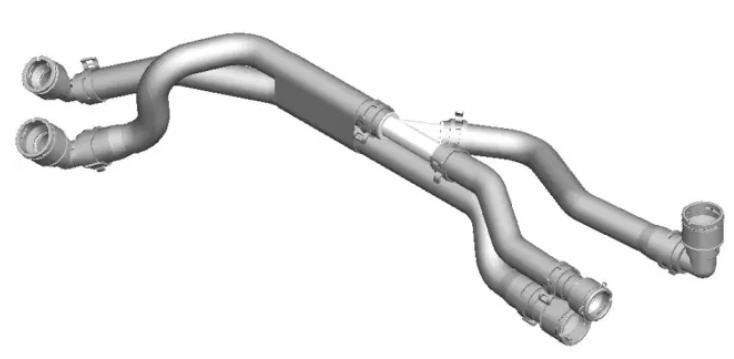

Ok, since you guys are good at figuring out parts, I need more help! I got everything put back together, but there are two hoses that connect to the outlets in this photo. There are plastic fittings that go onto the housing and the hose connects to them. I cracked one of these when pulling it off. Anyone know the part numbers?
They look like this, but one is smaller than the other and I want to get the right ones!

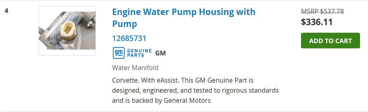

First of all, you need 2 new gaskets #5 in the Cultrag link above (unless they came with the new manifold).

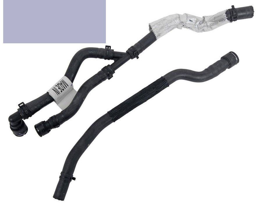

I think you are looking at the heater hose connections:
Heater hoses
I don't see the connectors separately (yet). How are they retained in the water pump manifold? Snap rings? I had a small plastic heater hose connector on my Impala break - shop replaced with a metal connector...
Rock Auto has a better pic
https://www.rockauto.com/en/moreinfo...t=6892&jsn=496

I ordered the water pump housing from Rock Auto. Genuine GM part and it came with the bolts and the gaskets already on it. I'm impressed.
Yeah, on the top photo you shared, on the left side, looks like the connectors I need. Yes, connected with snap rings. It looks like a pain to replace the whole assembly. I guess I could buy the hose assembly and pull the ends off, but at $153 I don't want to! I only broke one, the smaller one. Terrible design.
