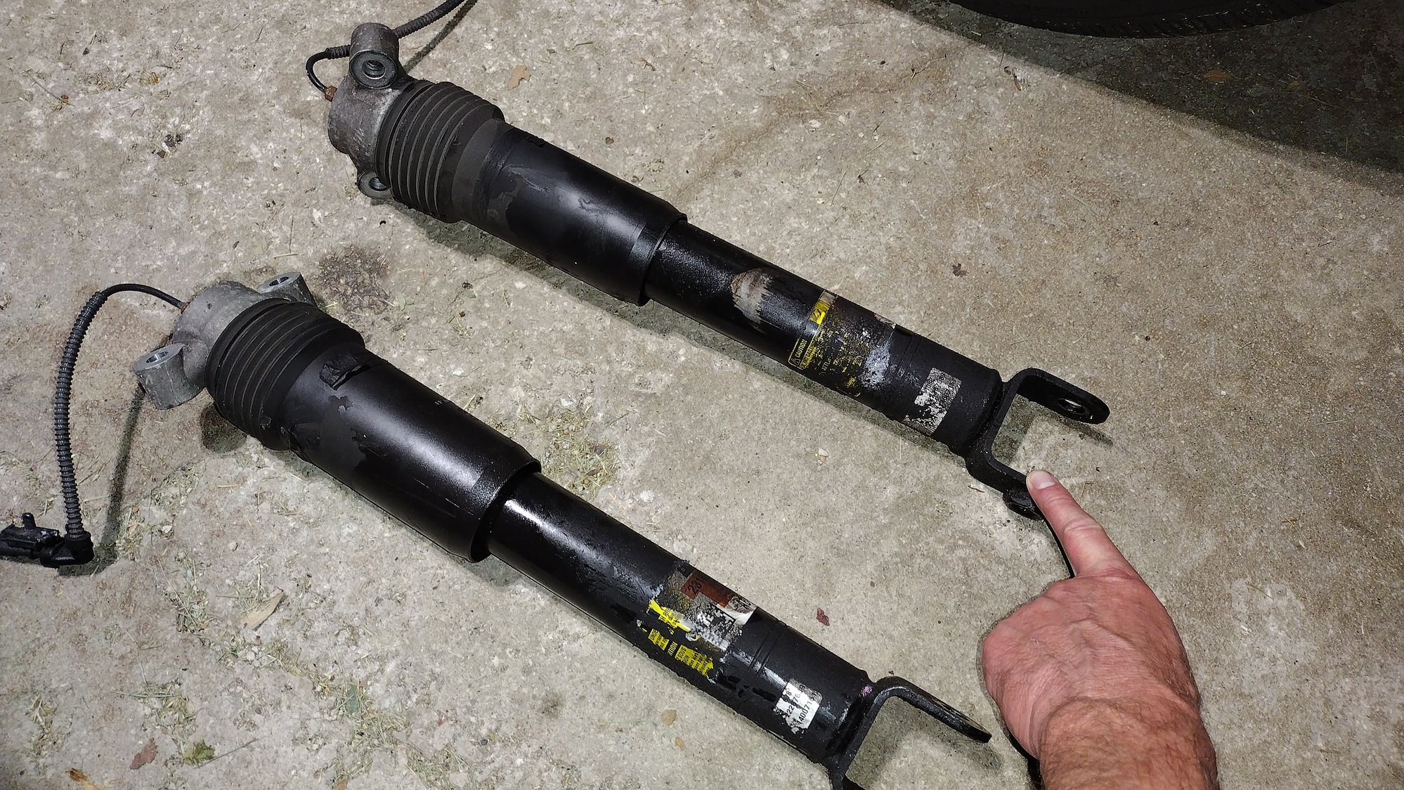

It really depends on how much they are leaking. At 40,000 mine started acting up in the rear. If they look like this, it IS the shocks.

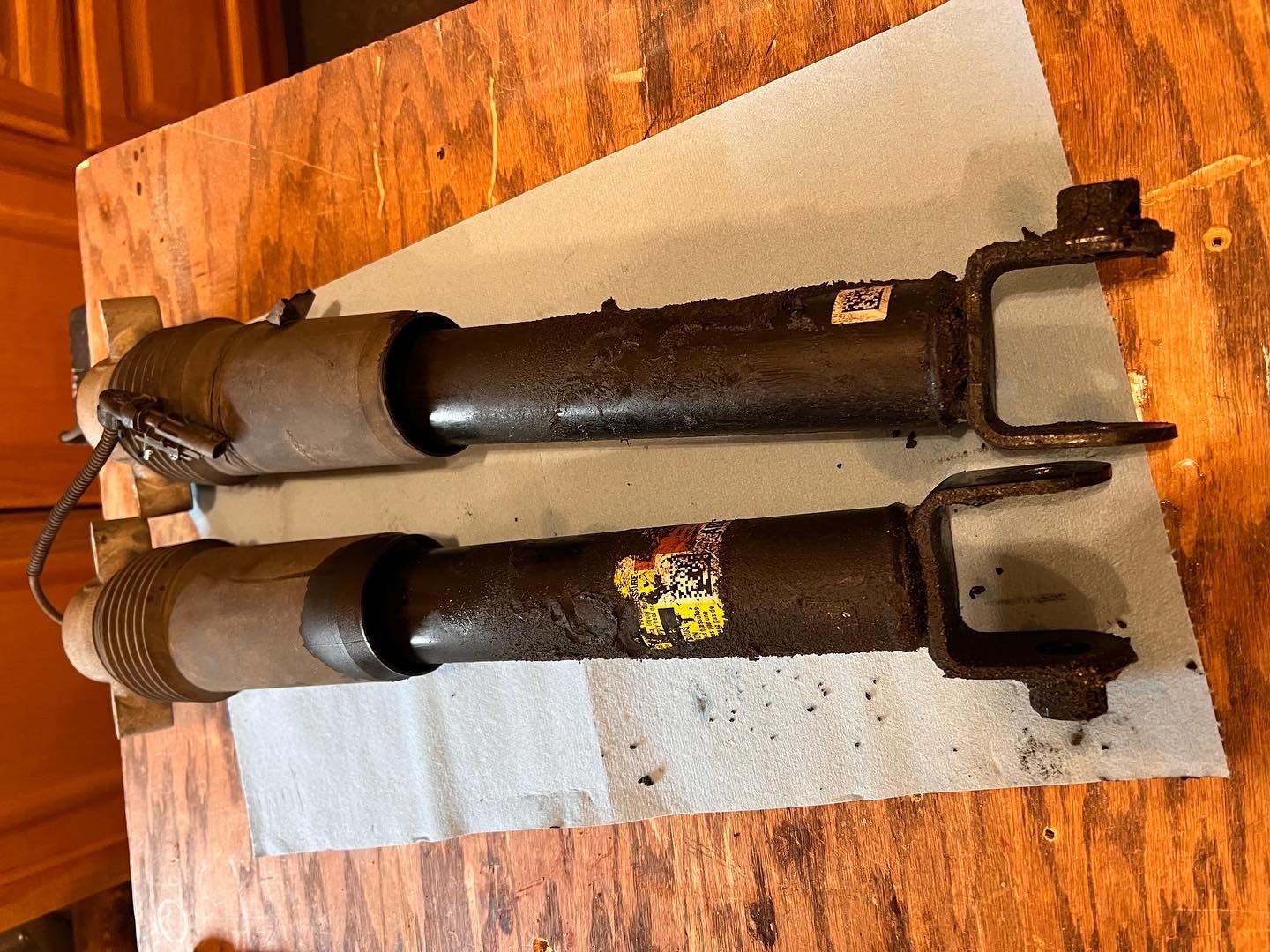

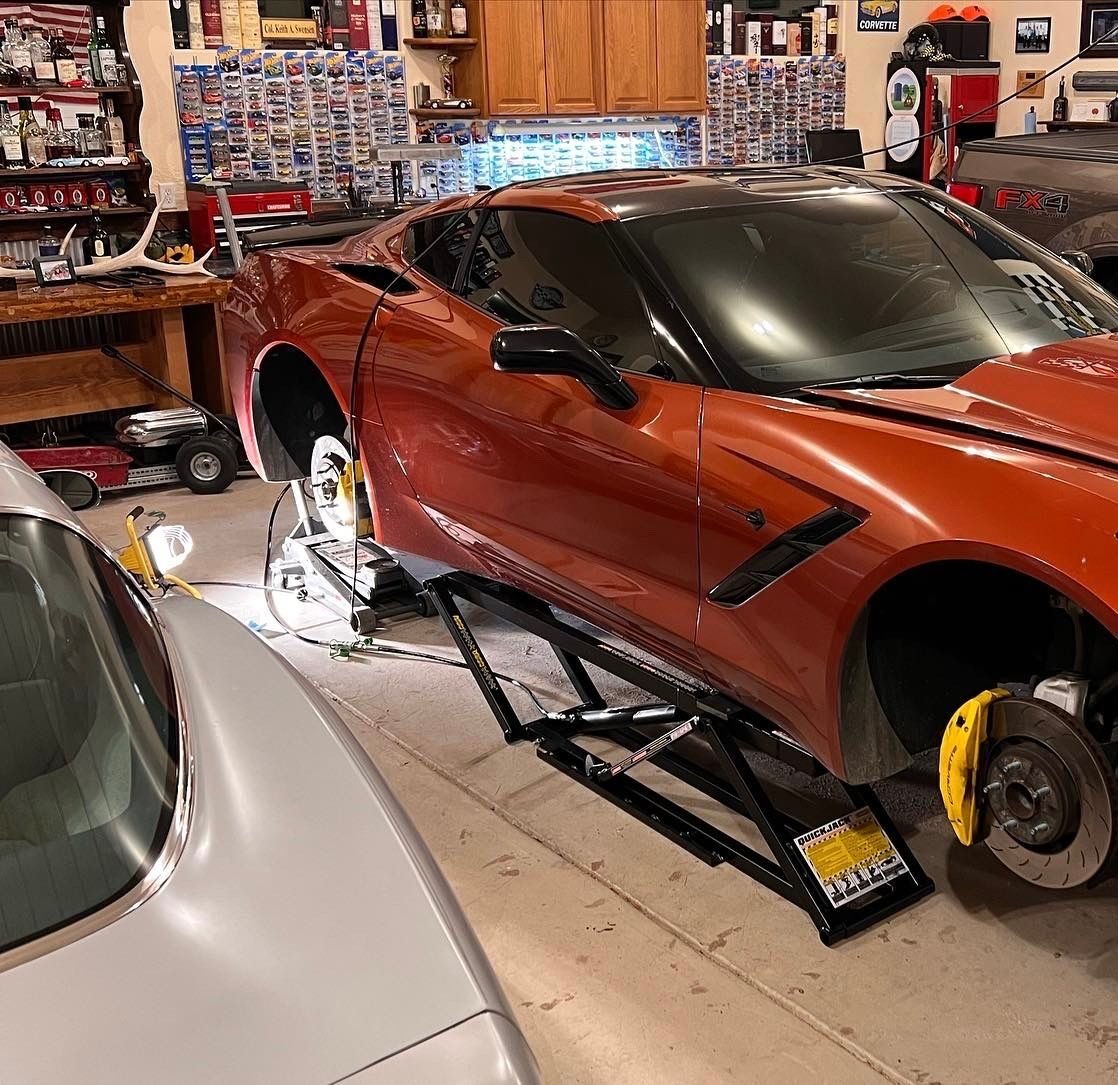

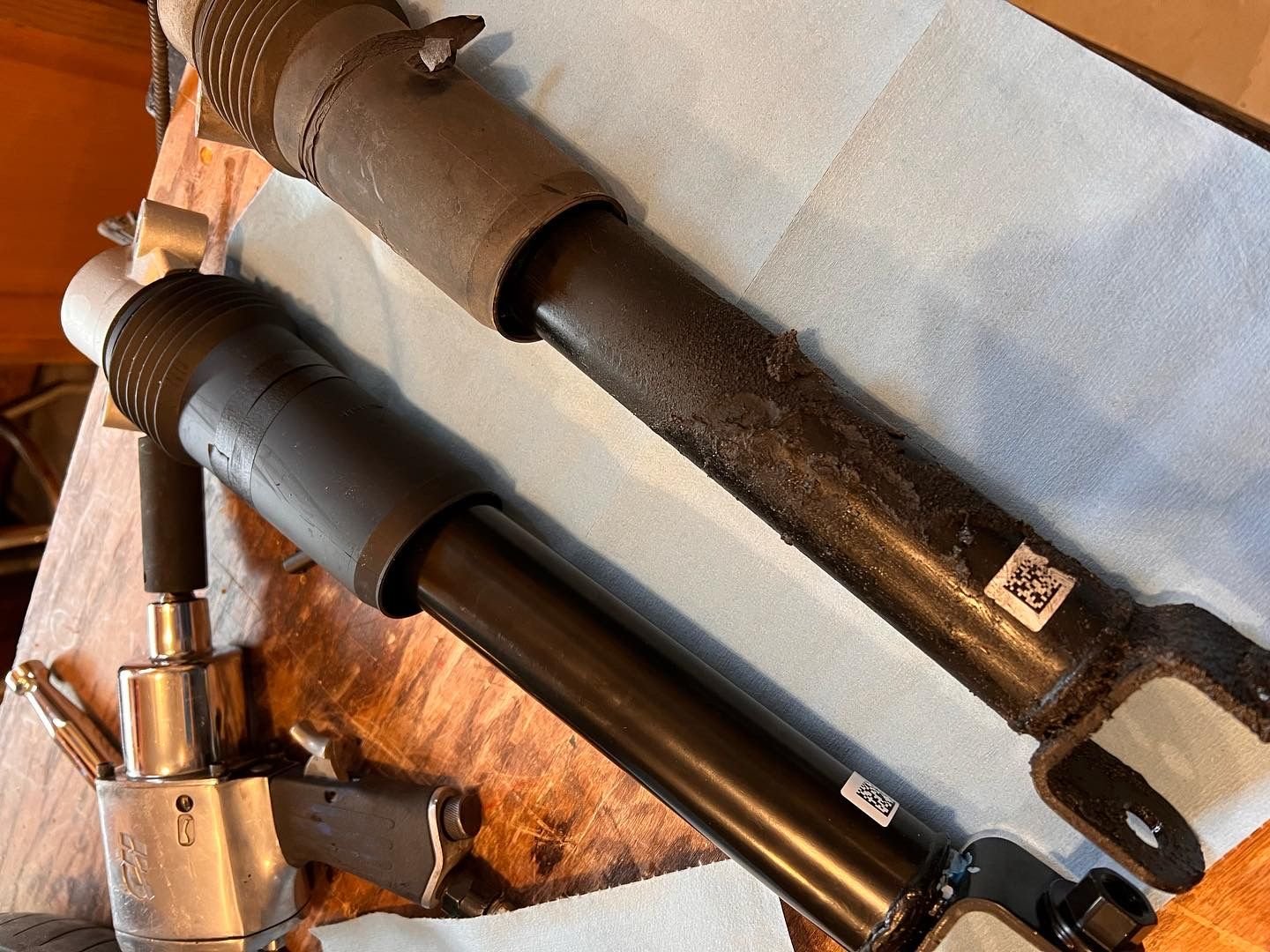

3 out of 4 were bad by 40,000 miles. I was shocked/dismayed but maybe the previous owner hit pot holed roads as I also had to replace a front rim later as well. Dealer wanted $5,000 to do the work; so I decided that I would replace them myself. Chevrolet was going to charge me $650 per shock! I ended up purchasing shocks online through RockAuto for $350 a piece. I bought a QuickLift with the money I saved and did it all myself.
