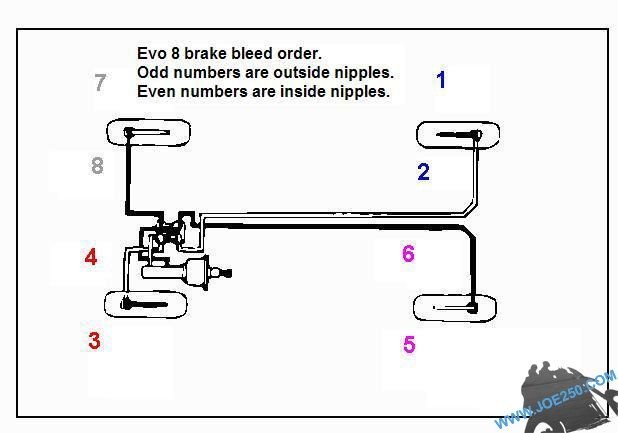

I had the same discussion about bleeding brakes on a C3. Everybody said to start at the back then do the front in a certain order. If you understand how the system is designed it makes NO difference what so ever what end you start on, in the C3. The two systems are totally two independent systems. No fluid or air can go between the two systems.
I did the same thing bleeding the dual calipers on each wheel. Outside, inside, outside inside on each wheel. The way it's designed there is as much chance air can get to the other side, either way you do it. It doesn't take much fluid each time once all the lines are clear. A rubber hammer helps also.
