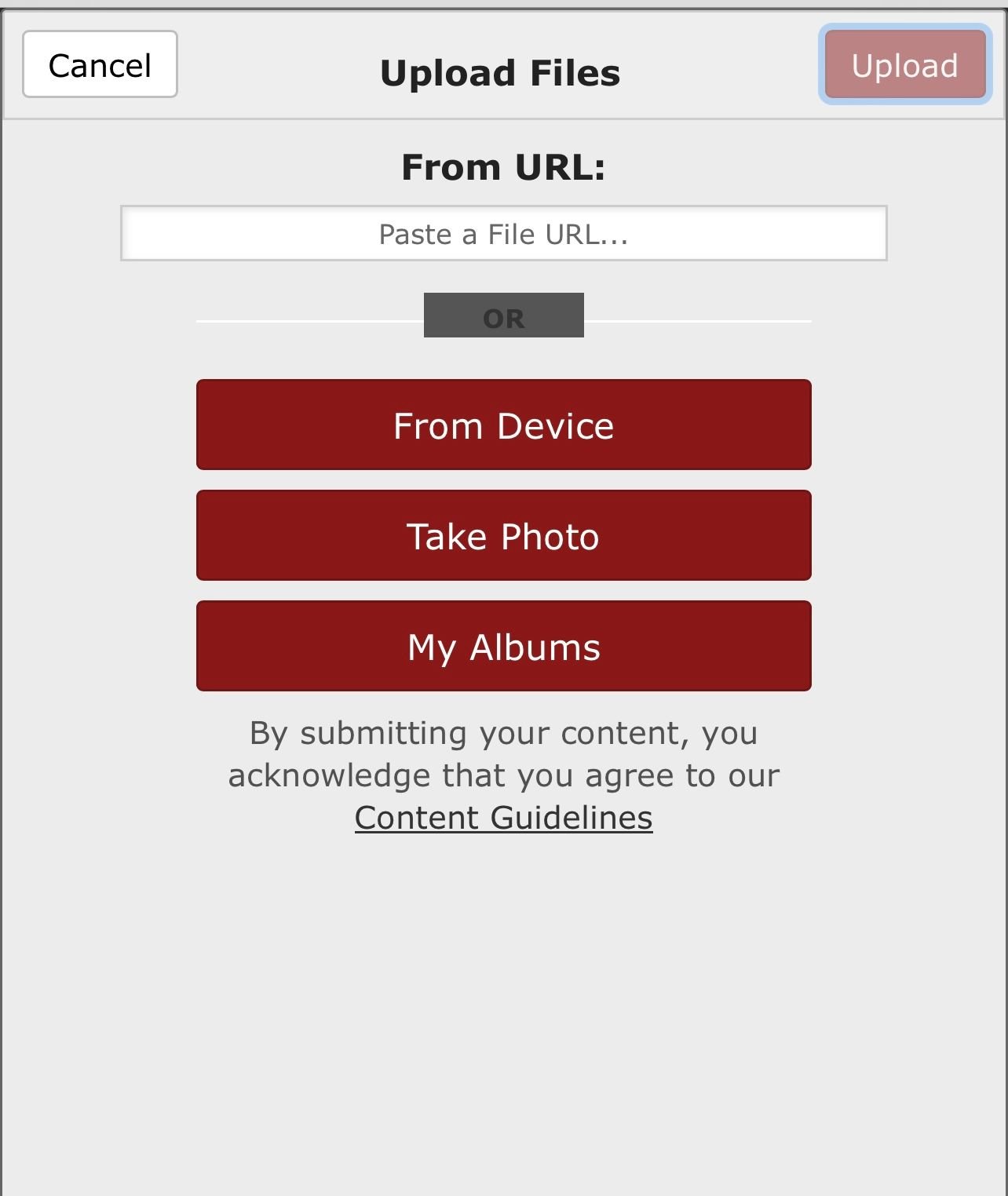

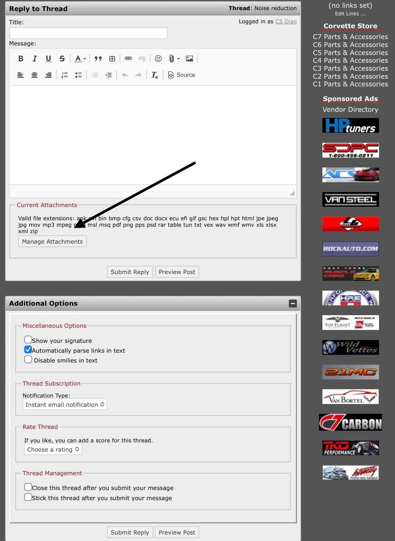

Go to “New” thread if that’s the section you want to post to then “manage attachments” then “from device” if from your cell phone then submit !!
