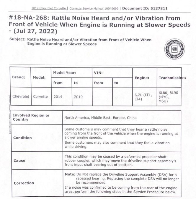

I searched on these forums and its pretty common issue on these. I also asked them I want the specific reason WHY it needed to be replaced and they sent the below document

I did ask them specifically why does this part need to be completely replaced and they sent me the official document about it. See below

Were you experiencing this rattle ??…being a “Corvette Specialist” is a bunch of hogwash …a few years ago I had my Central Air replaced down here in Florida and one of the young AC Techs had been the “Corvette Specialist” at the local dealership here in town before he left…I was asking him a few questions just to see how much he knew and he didn’t know ANYTHING…they had only asked him to be the Corvette Specialist and they didn’t send him to any Corvette specific schools or any type of training…any good auto Tech with Service Info and some smarts can fix any Corvette or any car for that matter…the Corvette is not some magical kind of car that only a select group of mechanics can repair…BTW, there are a few TSB’s concerning rattles.

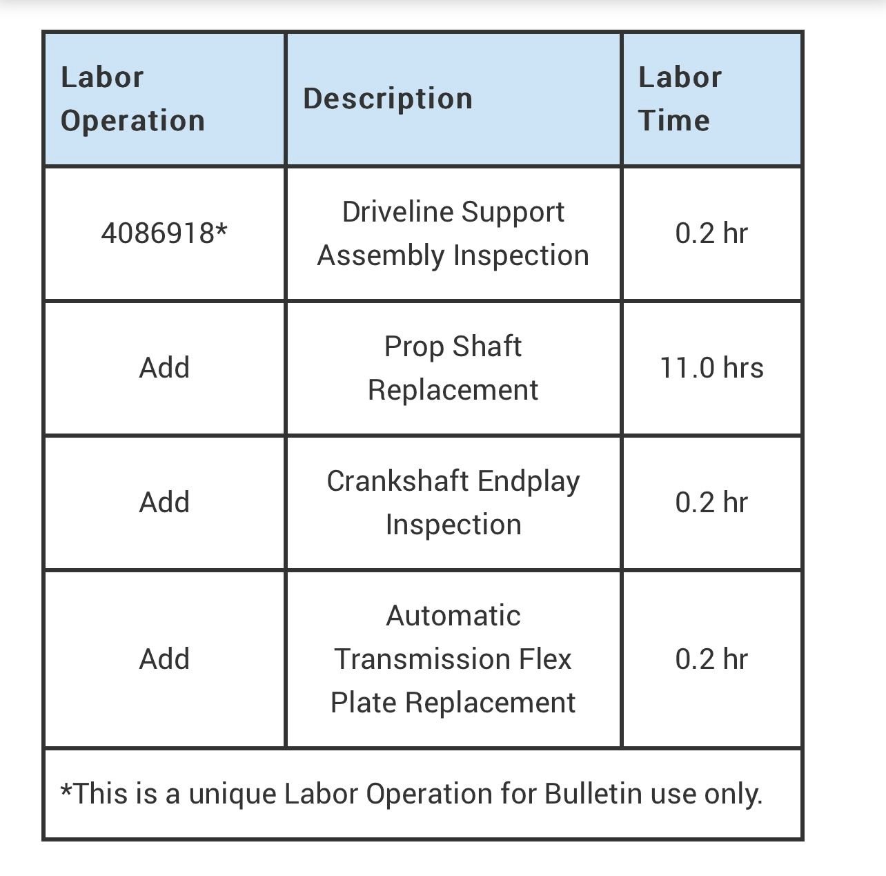

How the he$$ they get 26.3 hours for labor ??…that service writer needs to go back to 2nd grade arithmetic class…did they send you the WHOLE TSB ??…here is part of that TSB…it’s 11.6 labor hours total !!…man, you’re getting taken to the cleaners !!..BTW it looks like they are charging you $2586 for a NEW torque tube…how do they know it’s even bad ??…dealerships make their money on service…NOT selling cars.

Did you complain about a rattle? If not, this is a ripoff pure and simple. Even if you did complain about a rattle, the hours for the repair as C5Diag mentions are beyond excessive.
Run from this dealer as fast as you can.
Based on their "quote", it wouldn't surprise me if they failed to tighten the oil filter completely and/or when they removed the old oil filter the rubber seal was left in place and they screwed the new filter right over the top of it.
It's very Very Very rare for the oil cooler to fail. The ones I've seen leak are from a debris hit. An oil leak in that area (assuming it's not the oil filter as I mentioned above)....is usually the gasket that fits between the oil cooler and the block. The gasket costs about $10 for the OEM part....and it takes less than an hour to change.
Edit....I see they also have the torque tube listed...aka the Driveline Support....listed for $2600 which is 10% more than MSRP! This dealership is fk'ing criminal.

Even if you have a rattle the TSB means this is an issue it CAN be !!…not that it is !!
Yeah as soon as I read it i asked how are you charging 26 hours when the doc specifically says it should take 11
He said "Thats warranty hours" So Im not sure if because its warranty they only get half of the hours they normally would as opposed to paying them 50% of their hourly rate.
Im trying to see what other corvette specialists would say just arent that many in Vegas. Unless anyone can recommend any would be appreciated.
Some TSB’s mention warranty hours but this one doesn’t !!…so do you have a rattle ??????
Yeah I did ask him that because I saw the hours where only 11 compared to 26. When I asked him about that he said that's because that's "warranty hours". I've worked in IT service departments before and warranty jobs are always much less than your regular service rate so I just assumed that it's possible that rather than charging them 50% of their regular service rate they just quoted half the hours. Either that or they are completely ripping me off.
Yes, warranty hours are less than the normal book rates and if it’s warranty work you won’t be paying for it anyway…so did you have a rattle ??

Whatever you confirm the diagnosis, no shop is going to perform a flywheel replacement for 11 hours. The bulletin time indicates what GM will pay, not what a shop is going to accept from anyone other than GM. By all means shop around just don’t expect to find 11 hours as it’s not reasonable.
