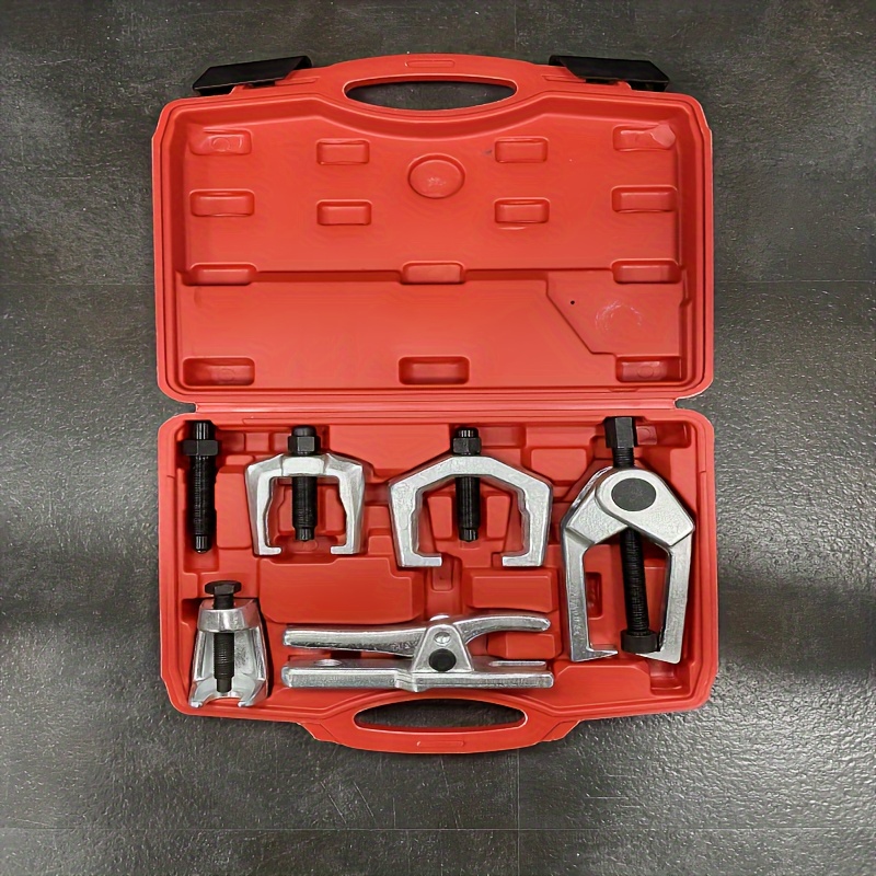

Have you tried these? You should be able to rent them.          arm     alloy     for   end   battery free

I have that exact kit. You will see I used the one to the far right inverted it and tried to use it to push onto the. Spindle. If I tried to use the one at the bottom, I’m fairly certain that I’m going to destroy the rubber boot

It came off using the tool on the far right. I inverted it as you can see in the photo and placed the bolt end that would normally be upright against the spindle. That with some dead hammer banging eventually popped it loose. Now I'm searching for torque specs for everything I took off.
