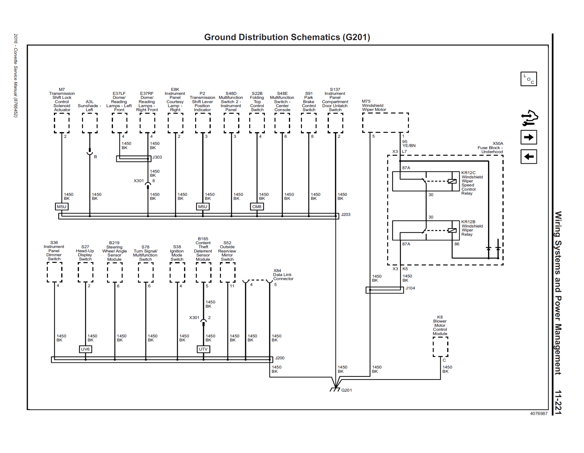

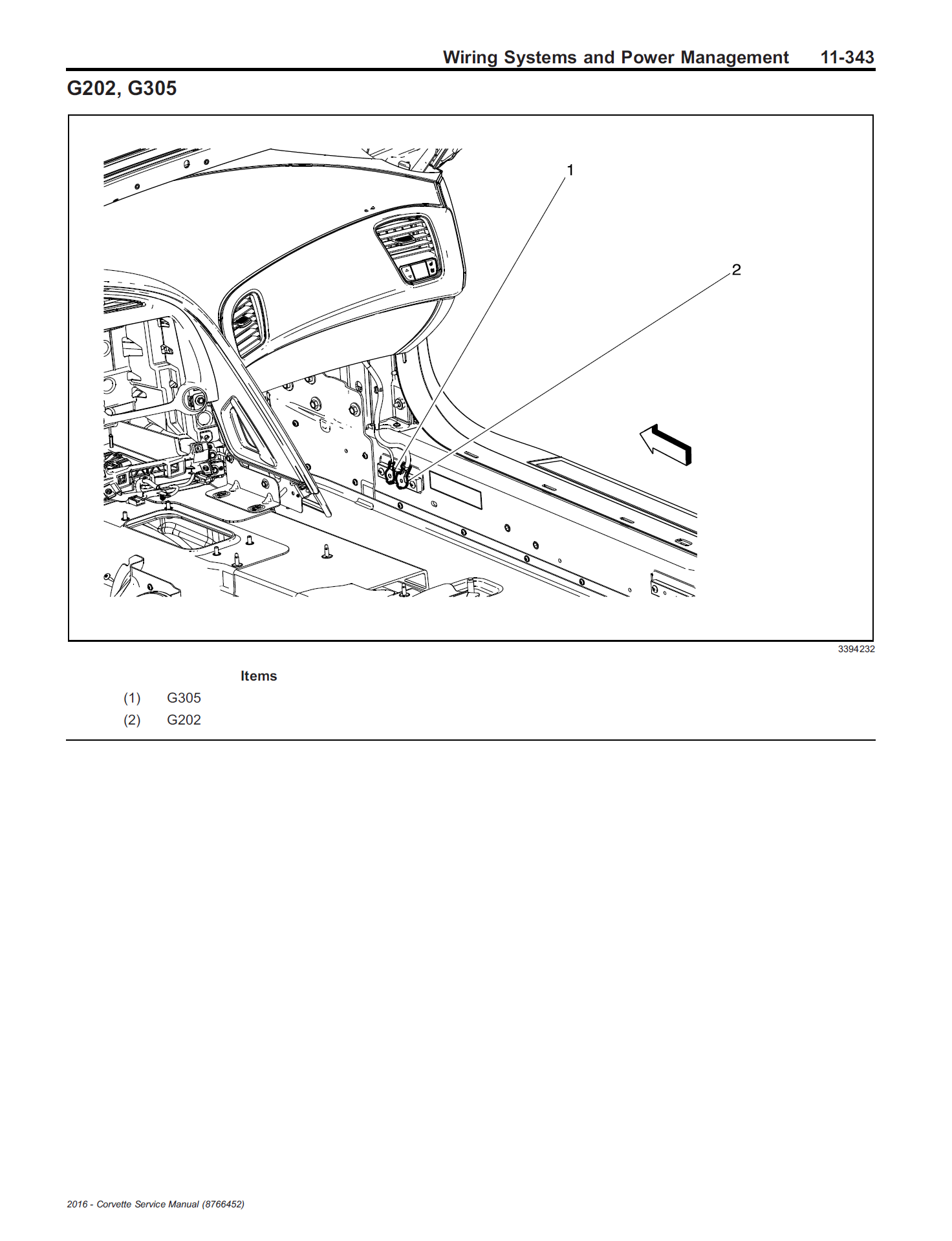

Do you know someone Wohnhaus a plan / diagramm where I can find all ground wires and connection points?
Old Nov 17, 2024 | 05:17 PM
Bill Dearborn's Avatar
Bill Dearborn
Joined: Oct 1999
Posts: 41,029
Likes: 9,779

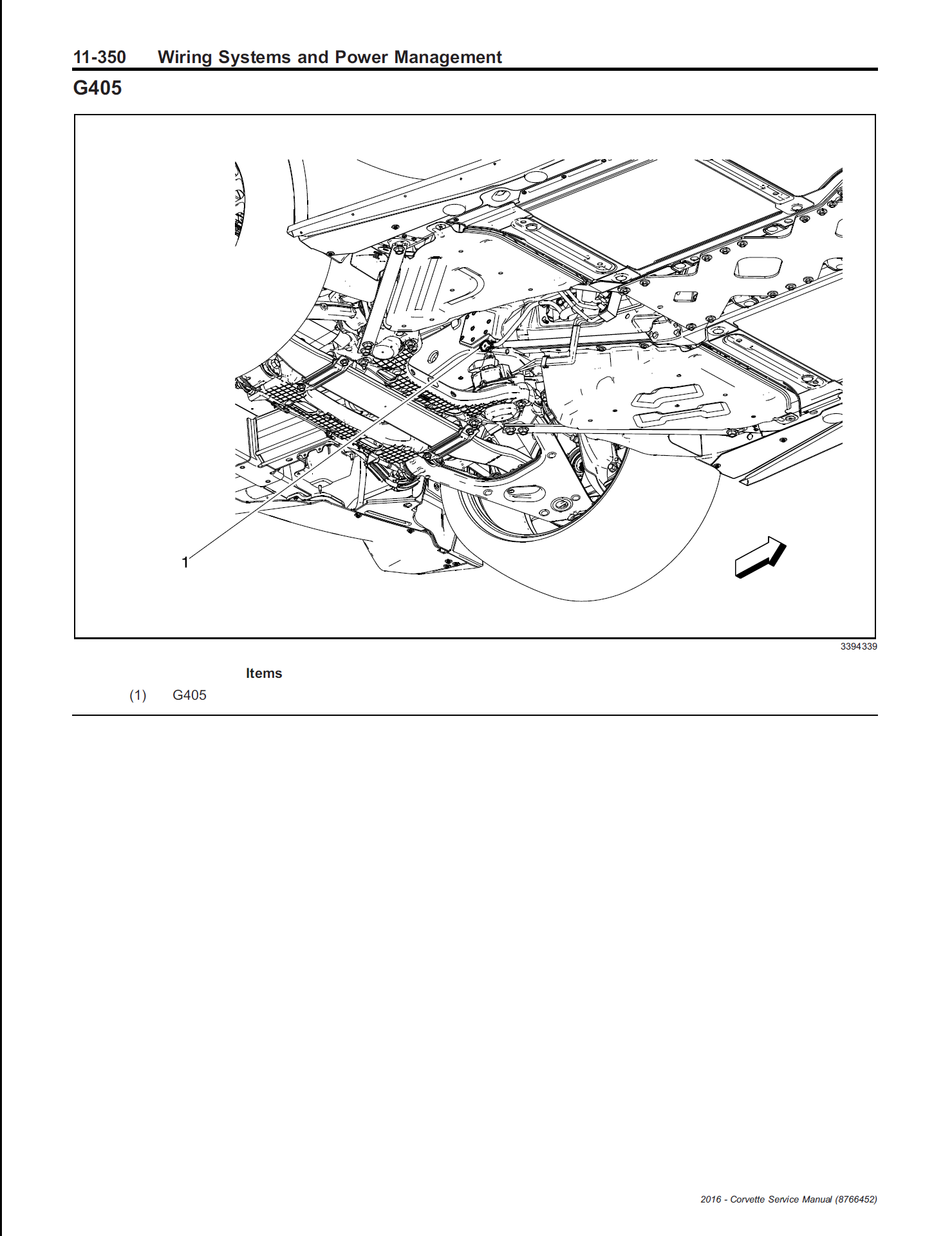

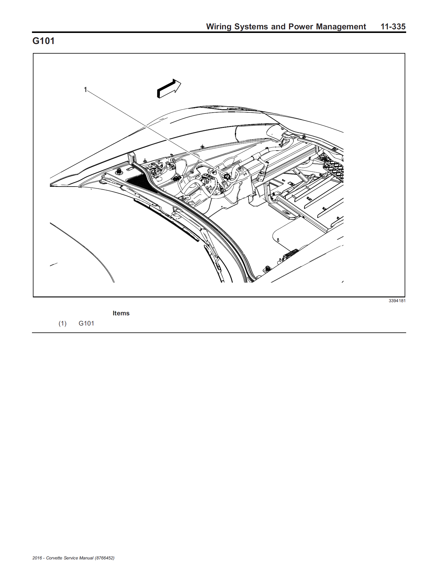

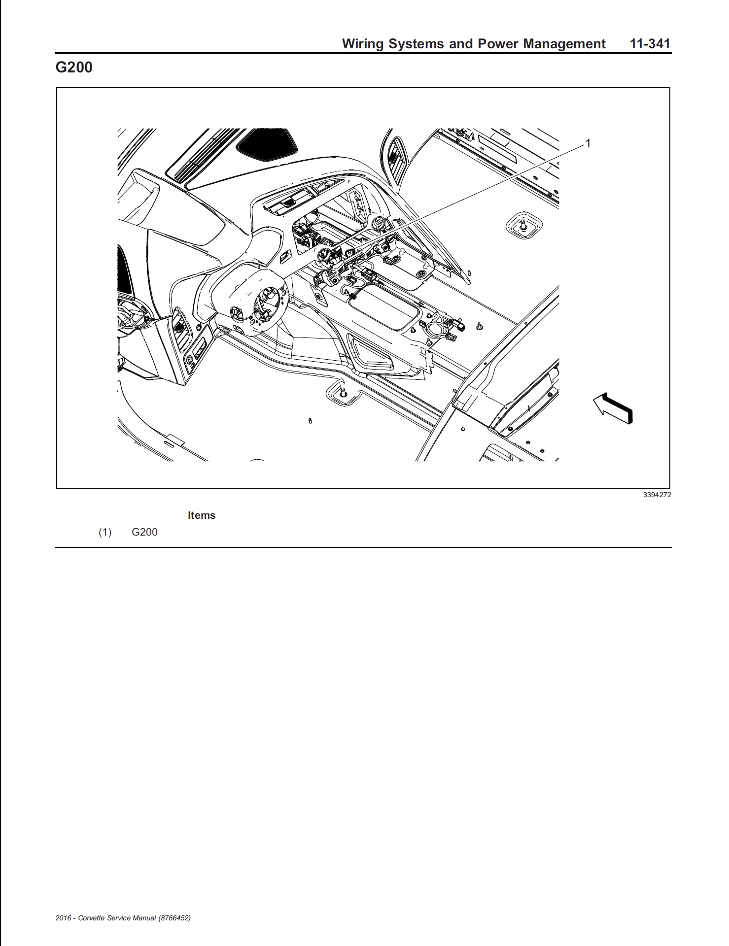

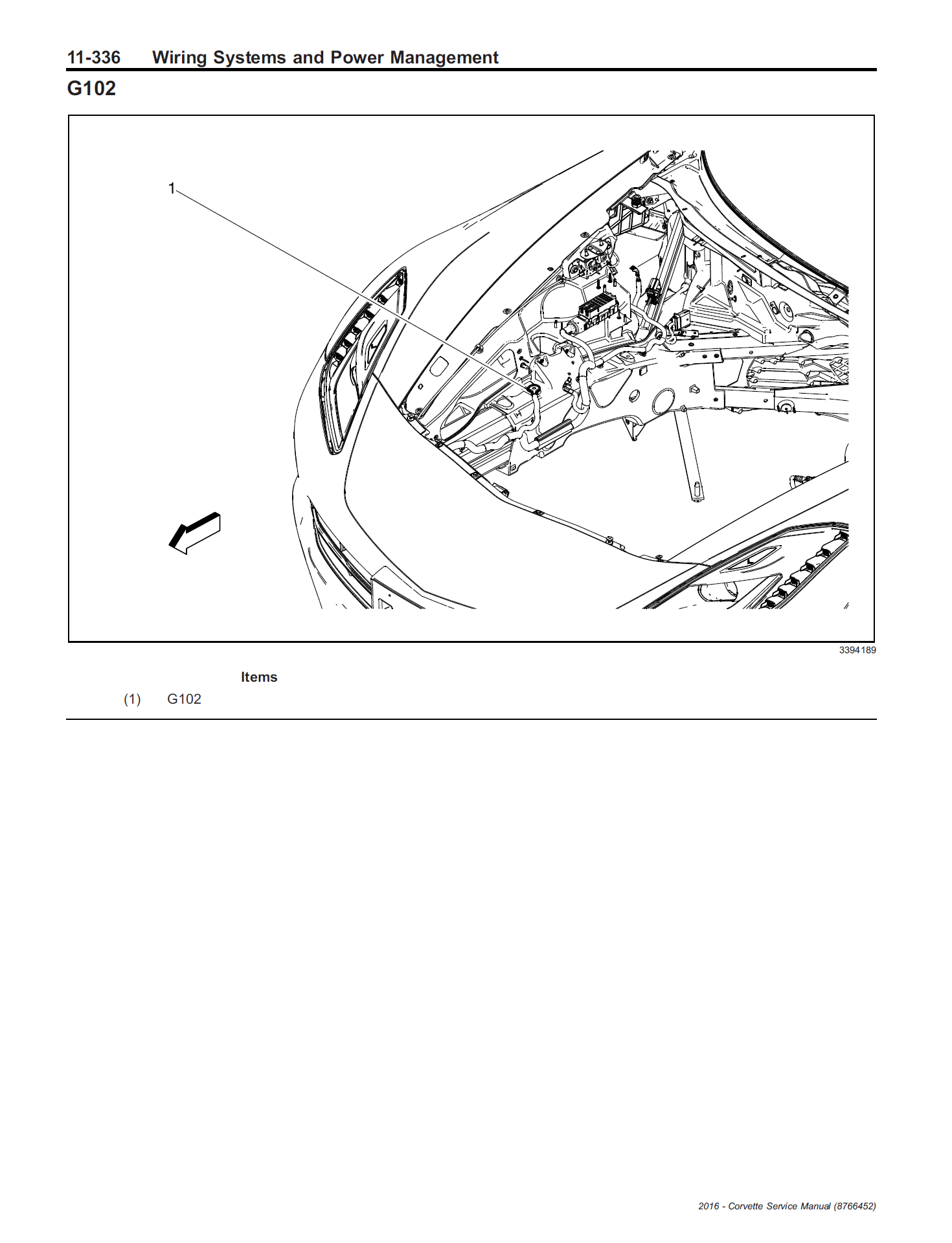

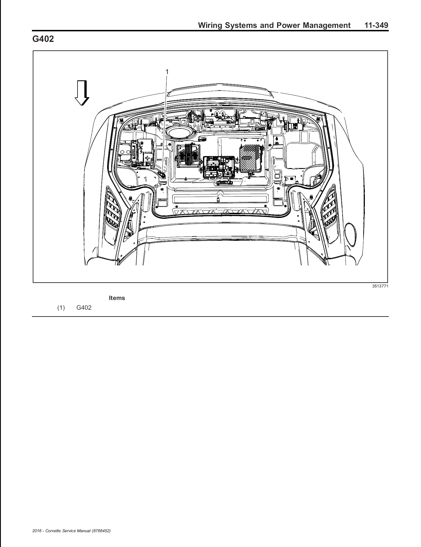

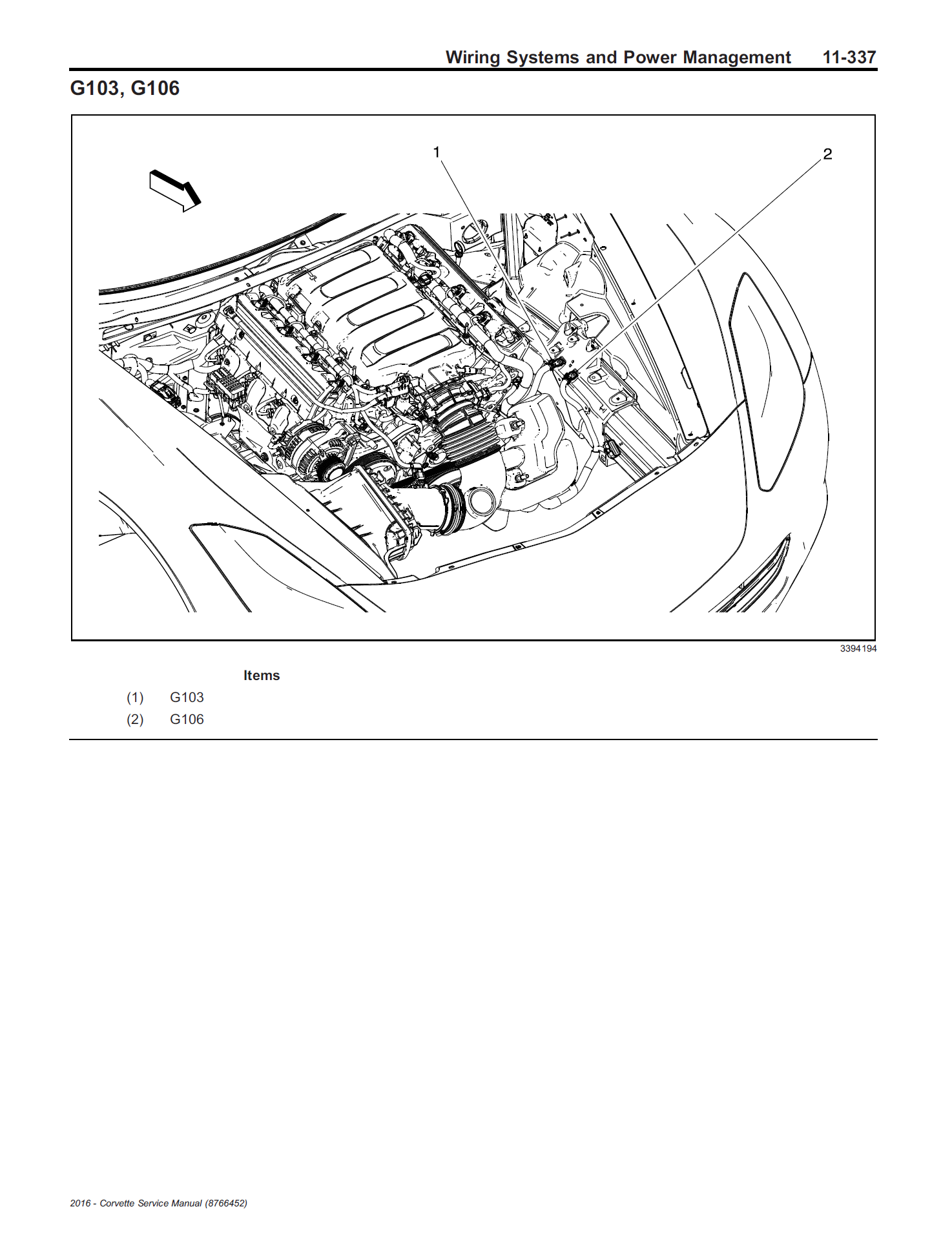

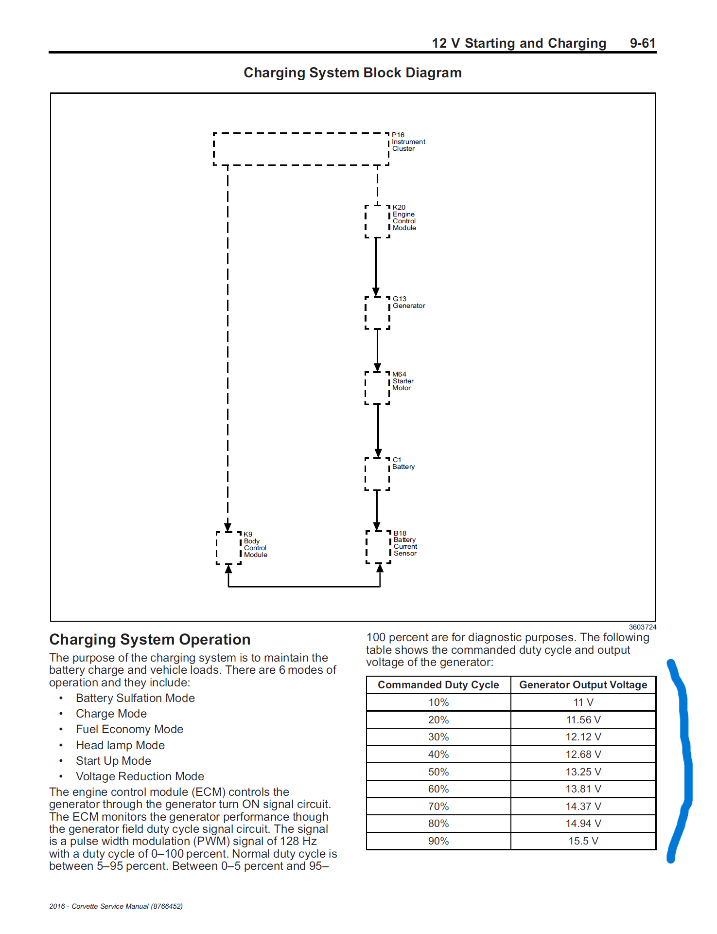

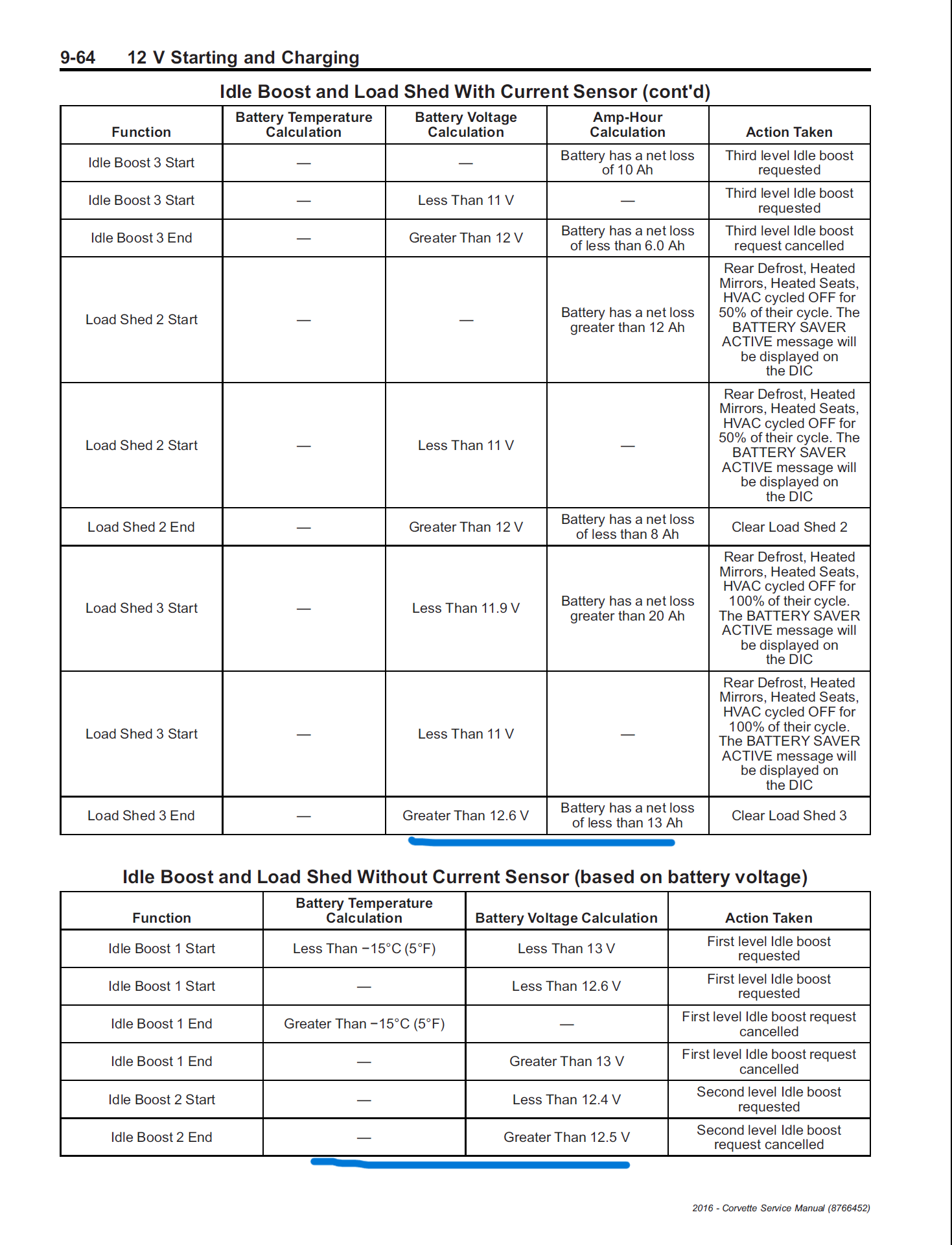

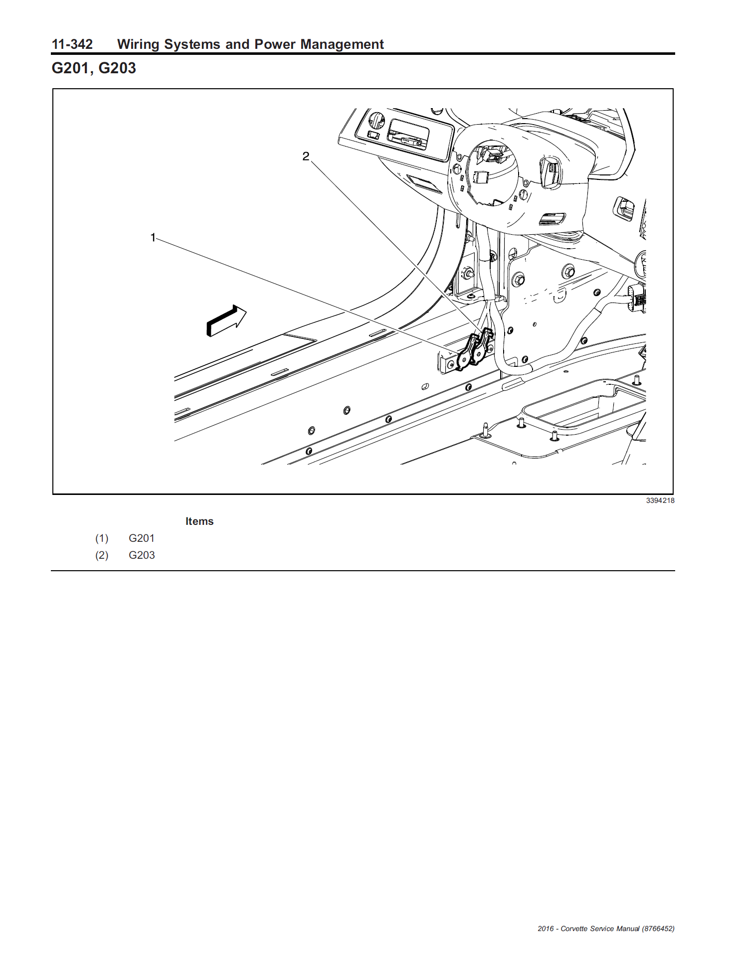

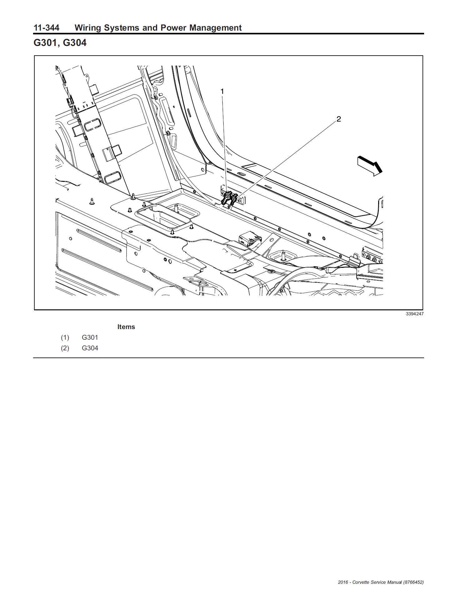

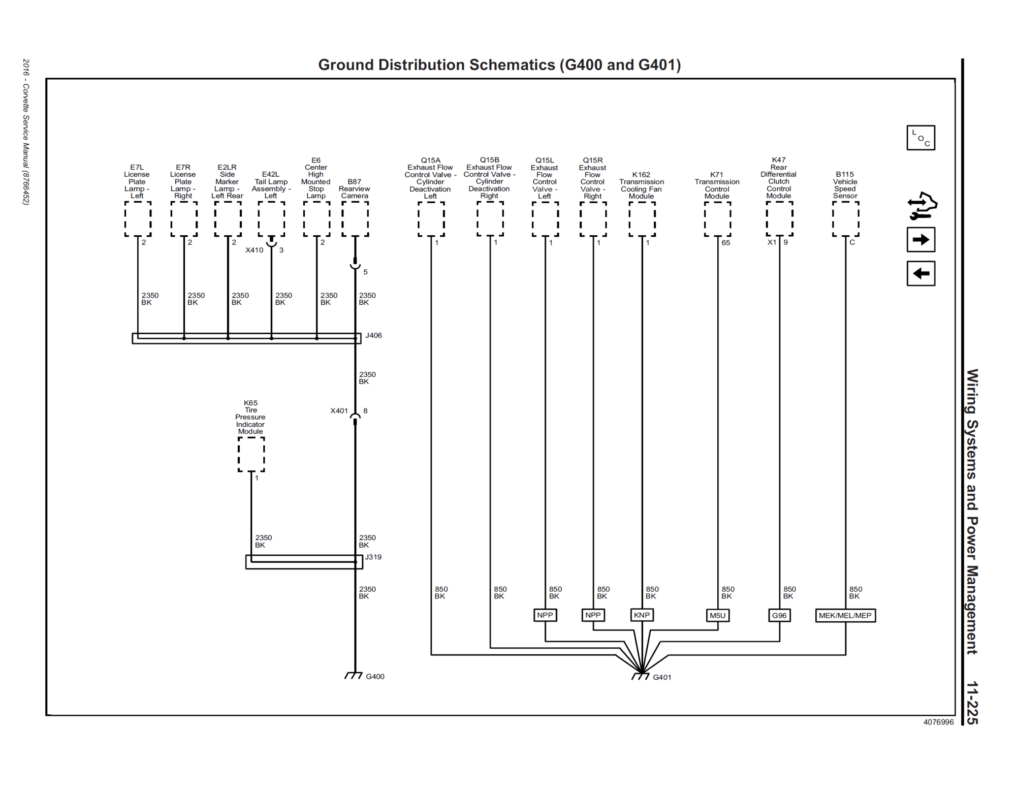

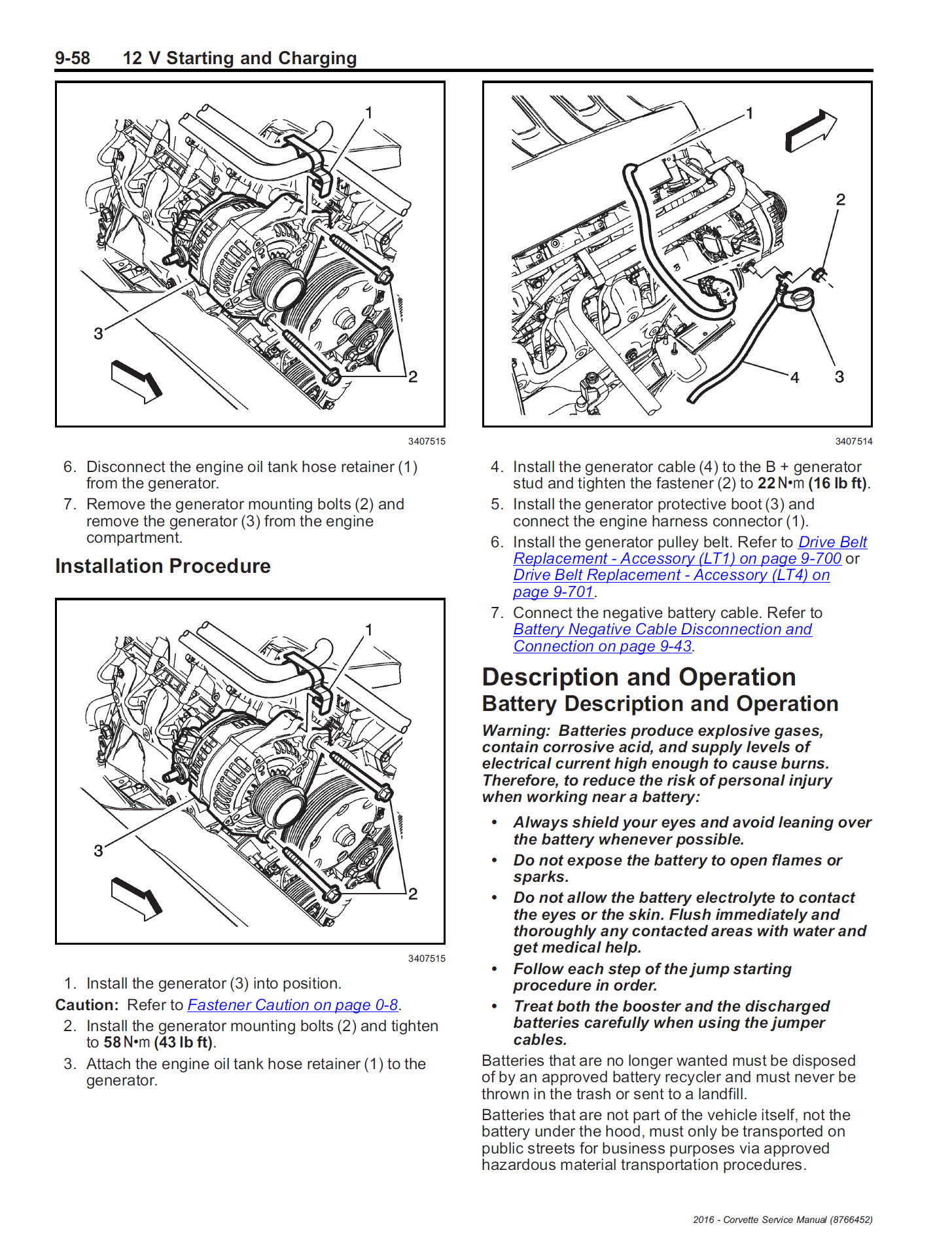

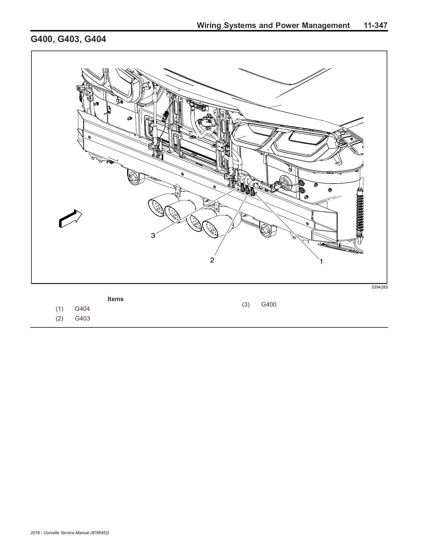

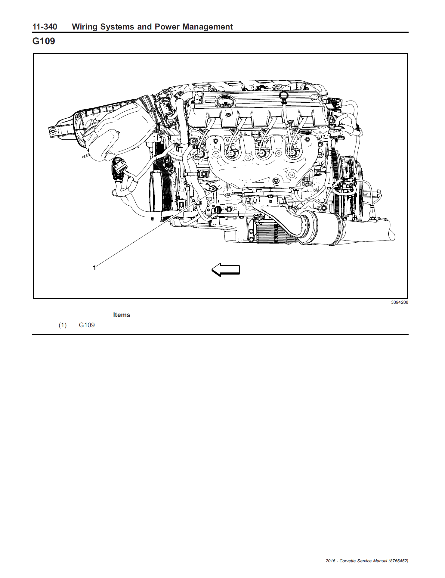

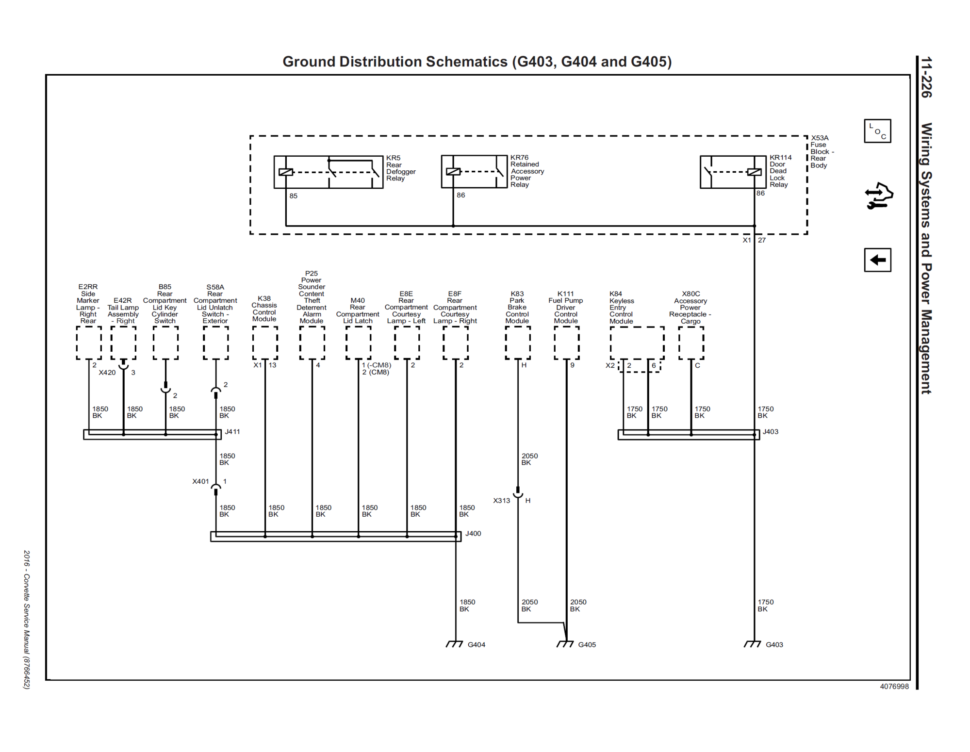

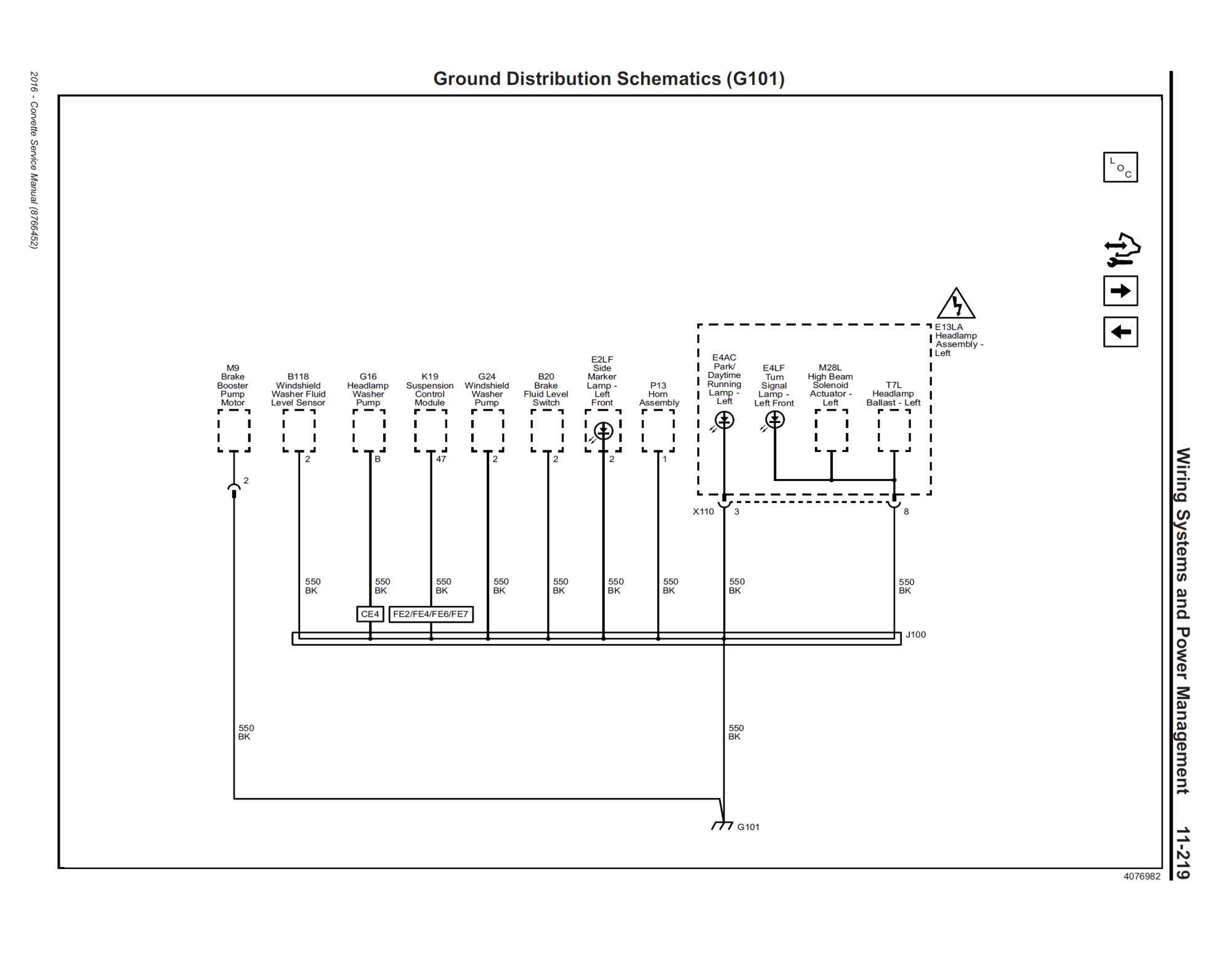

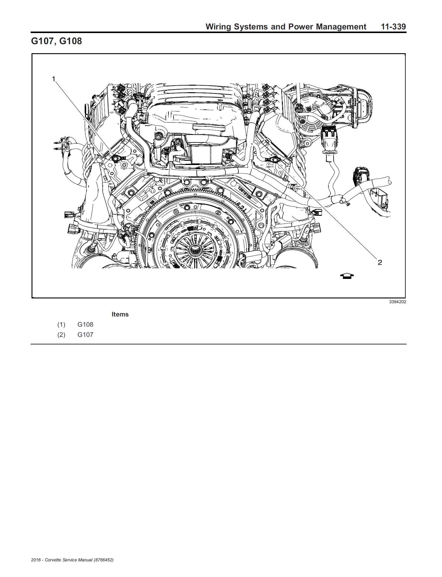

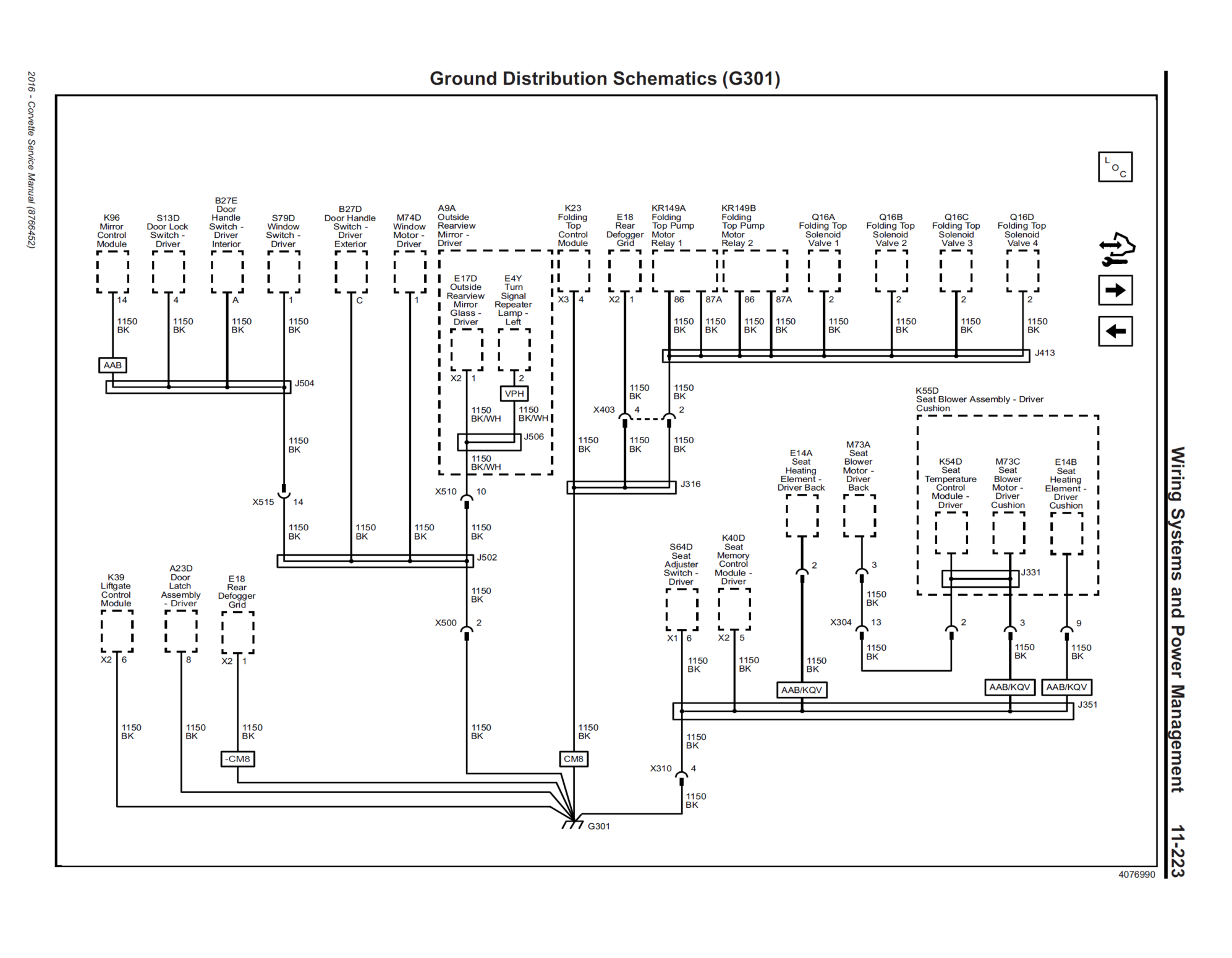

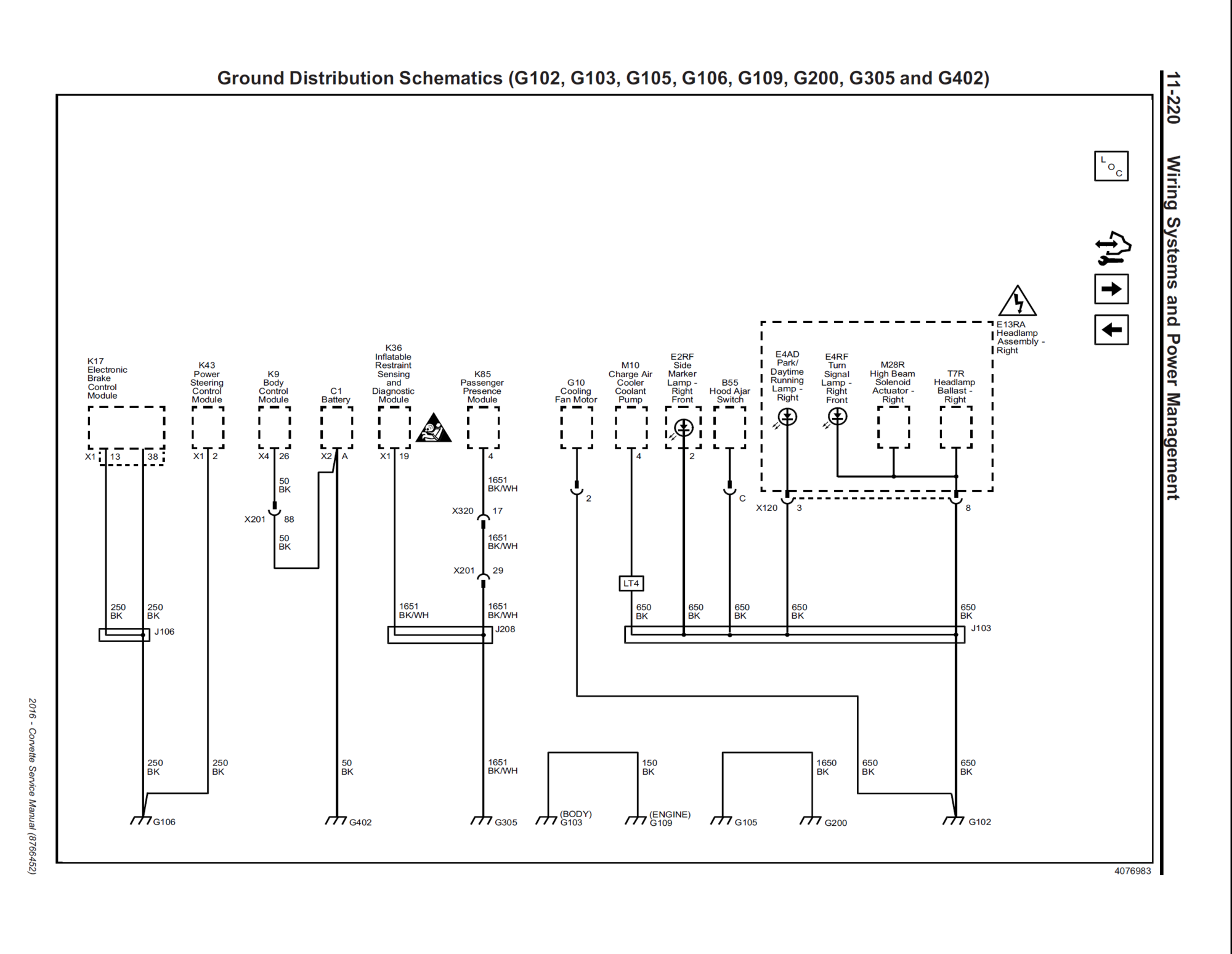

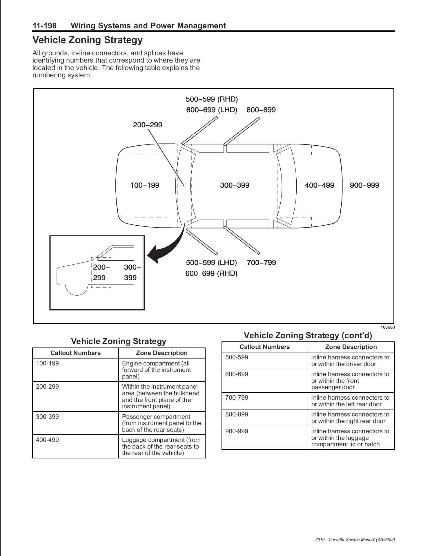

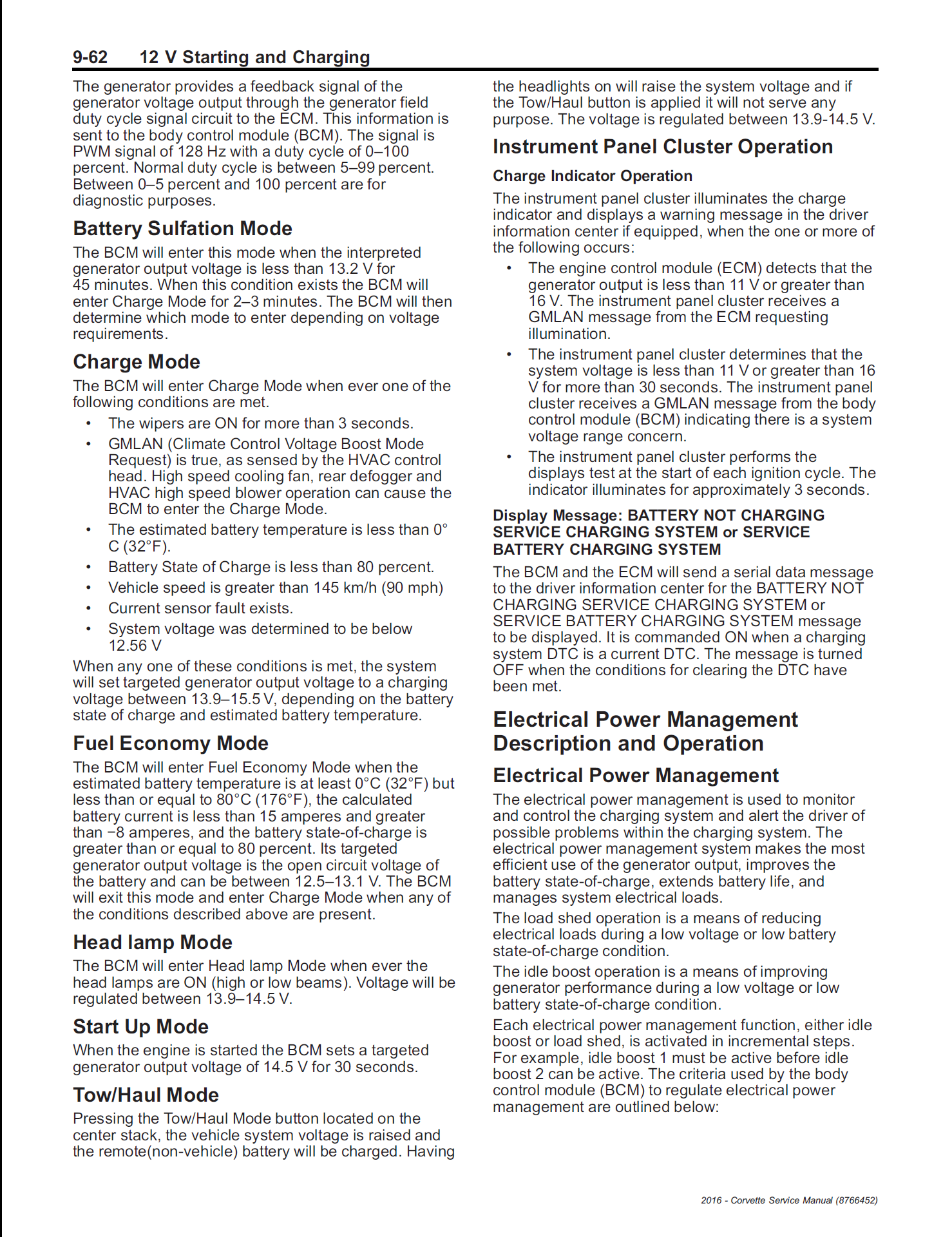

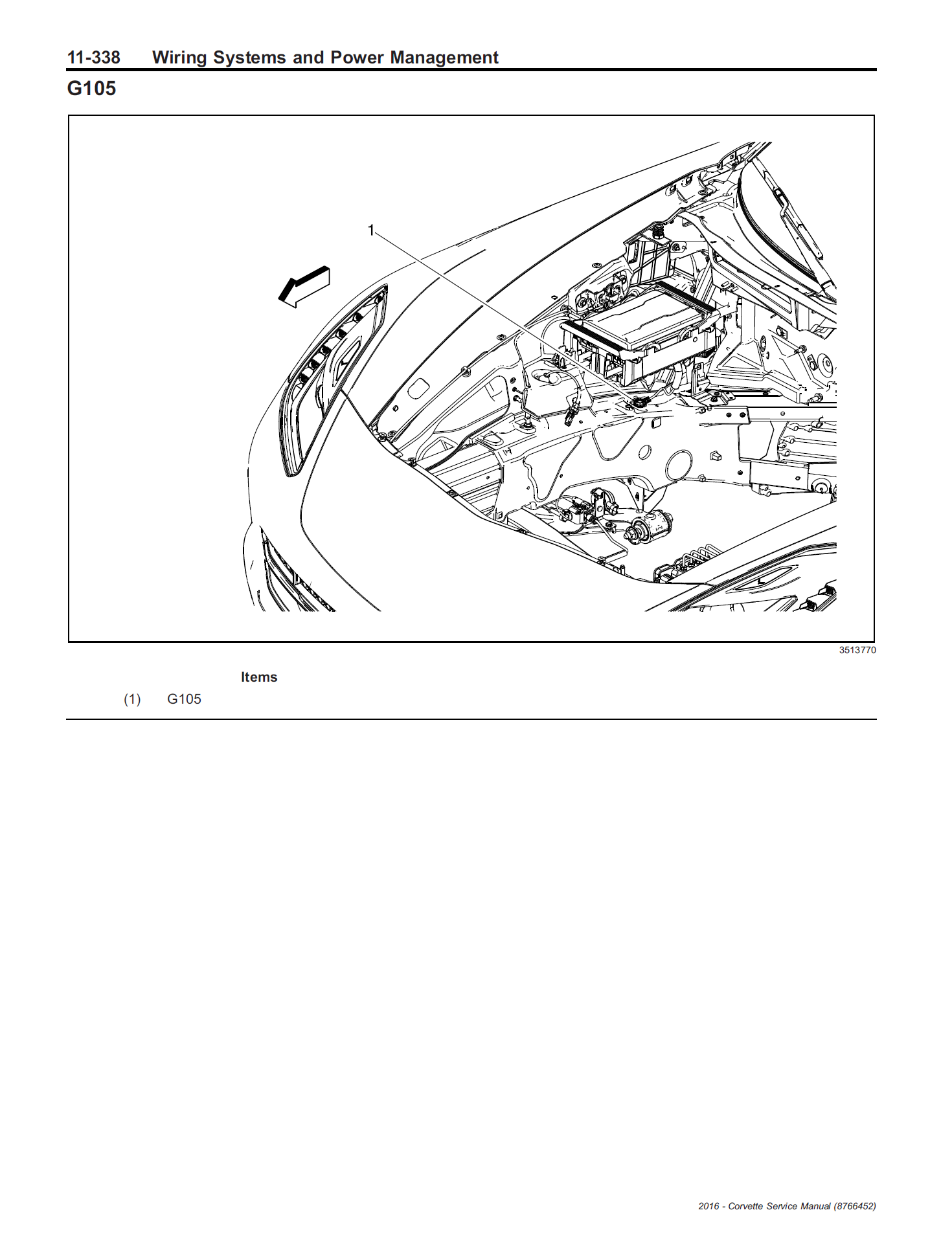

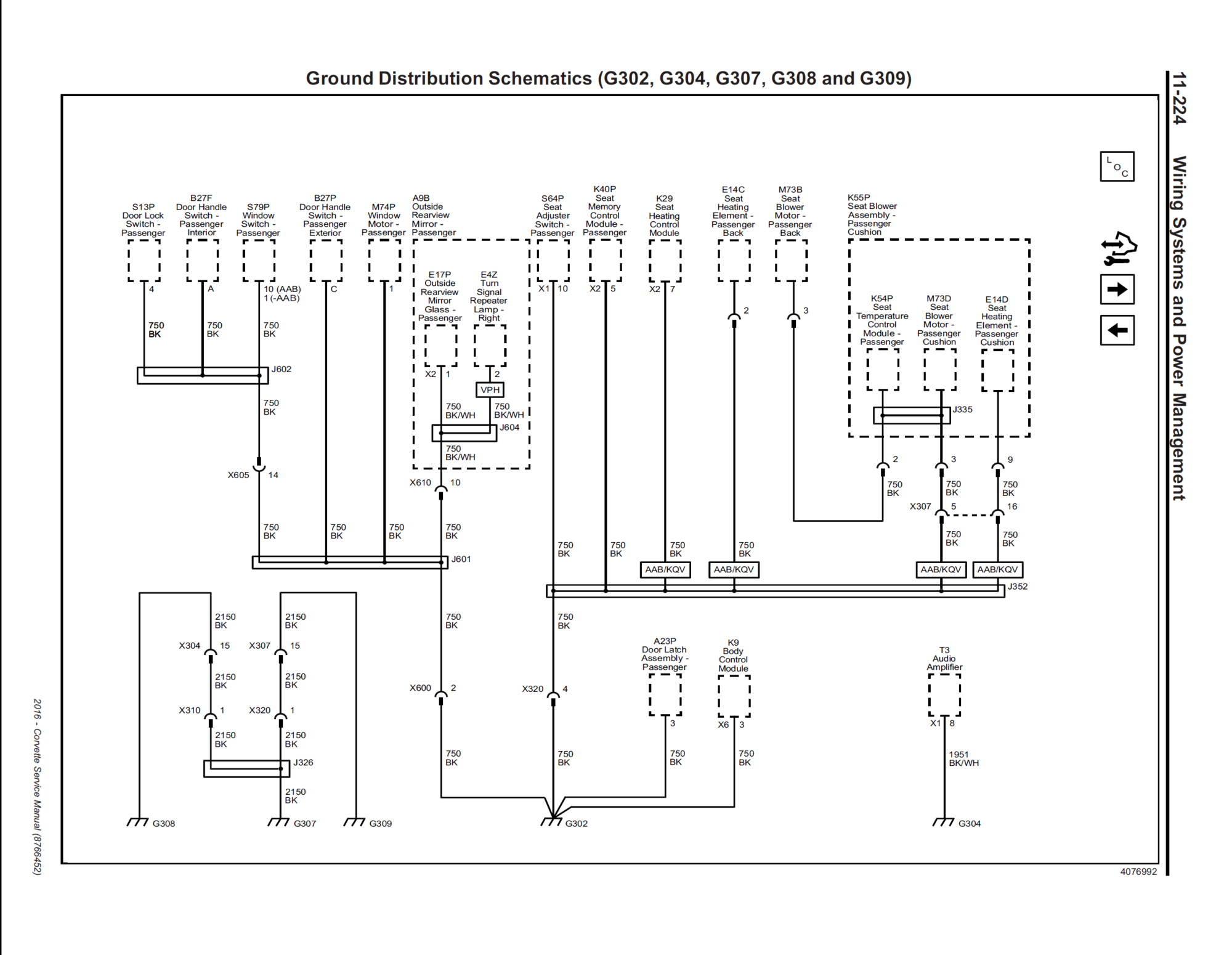

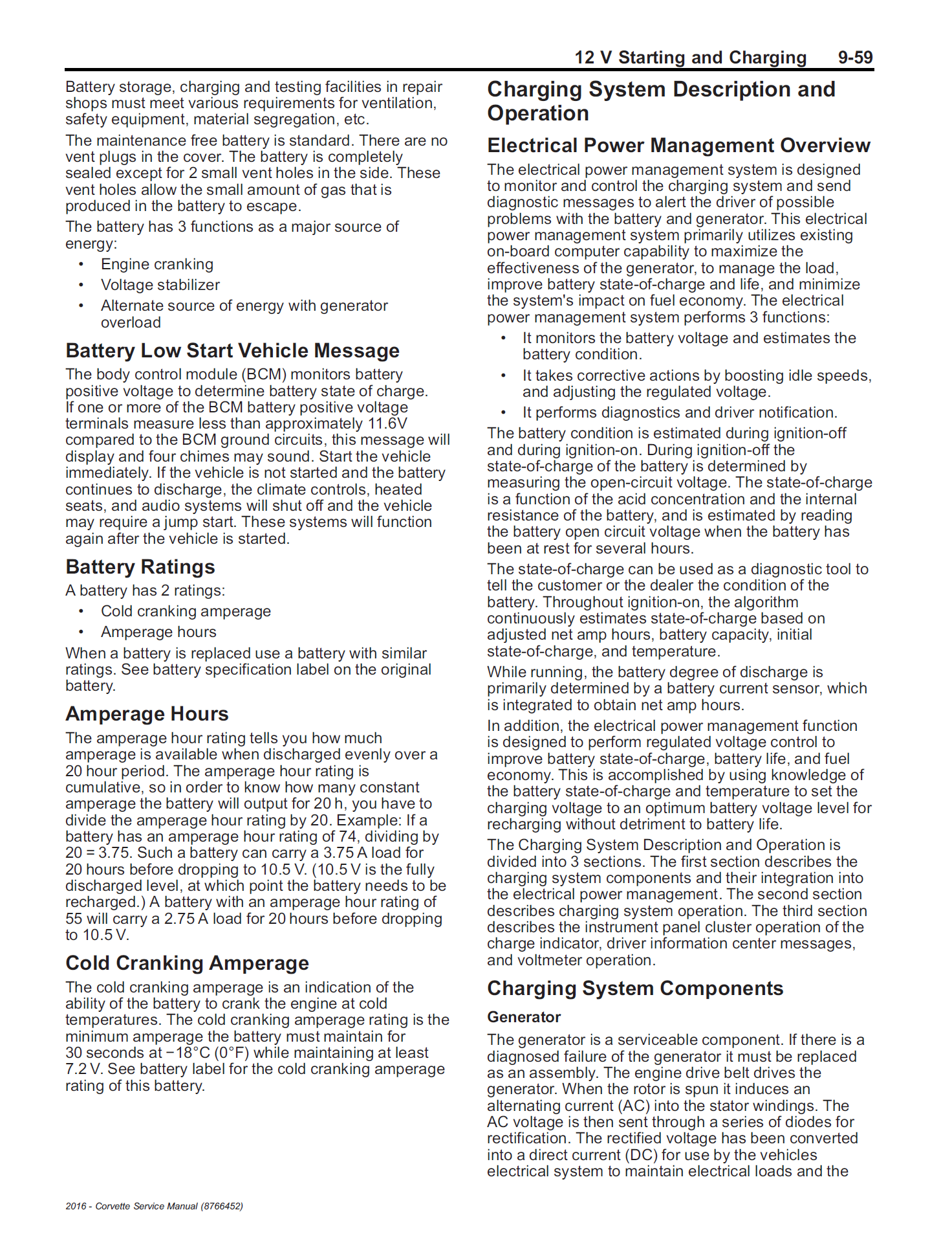

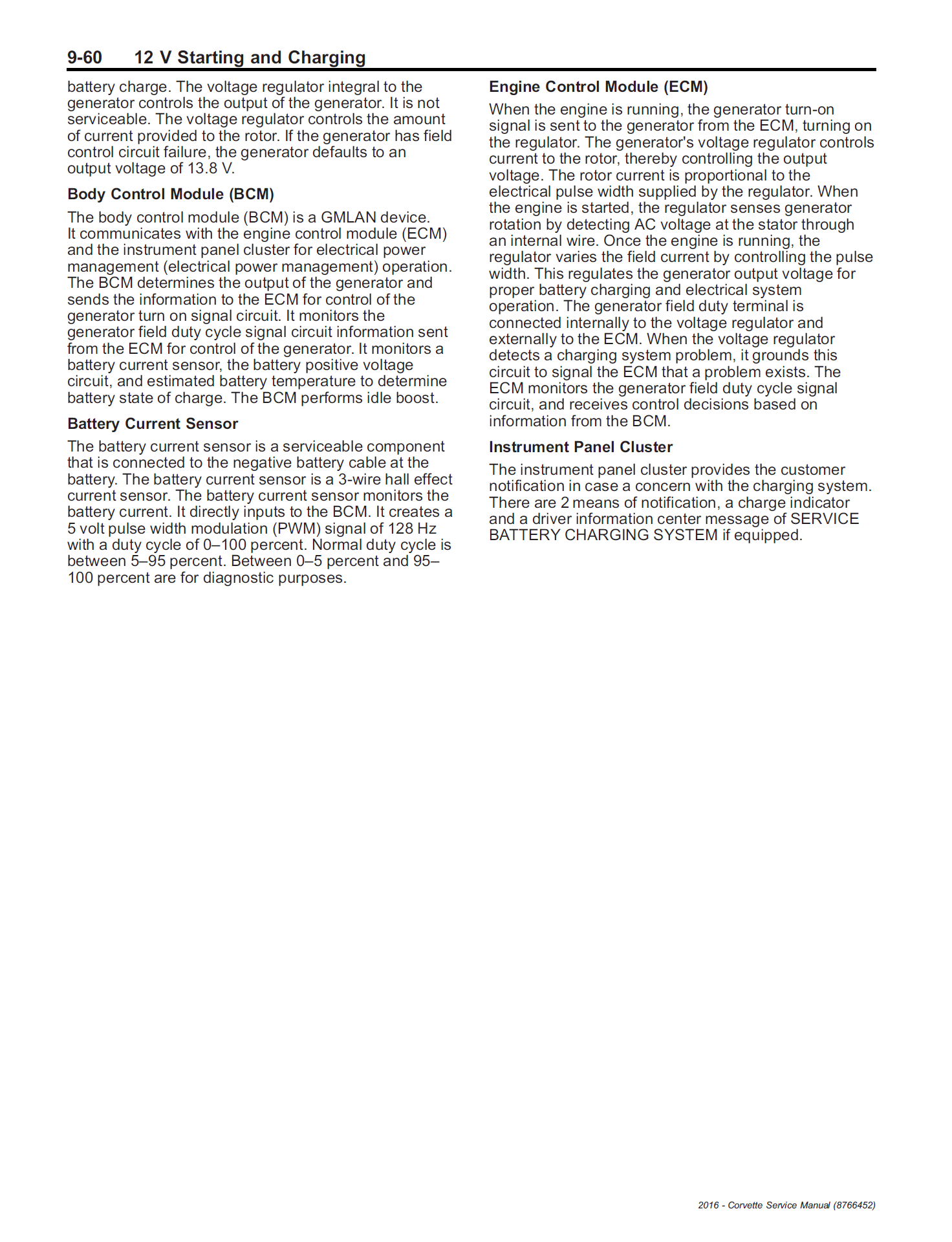

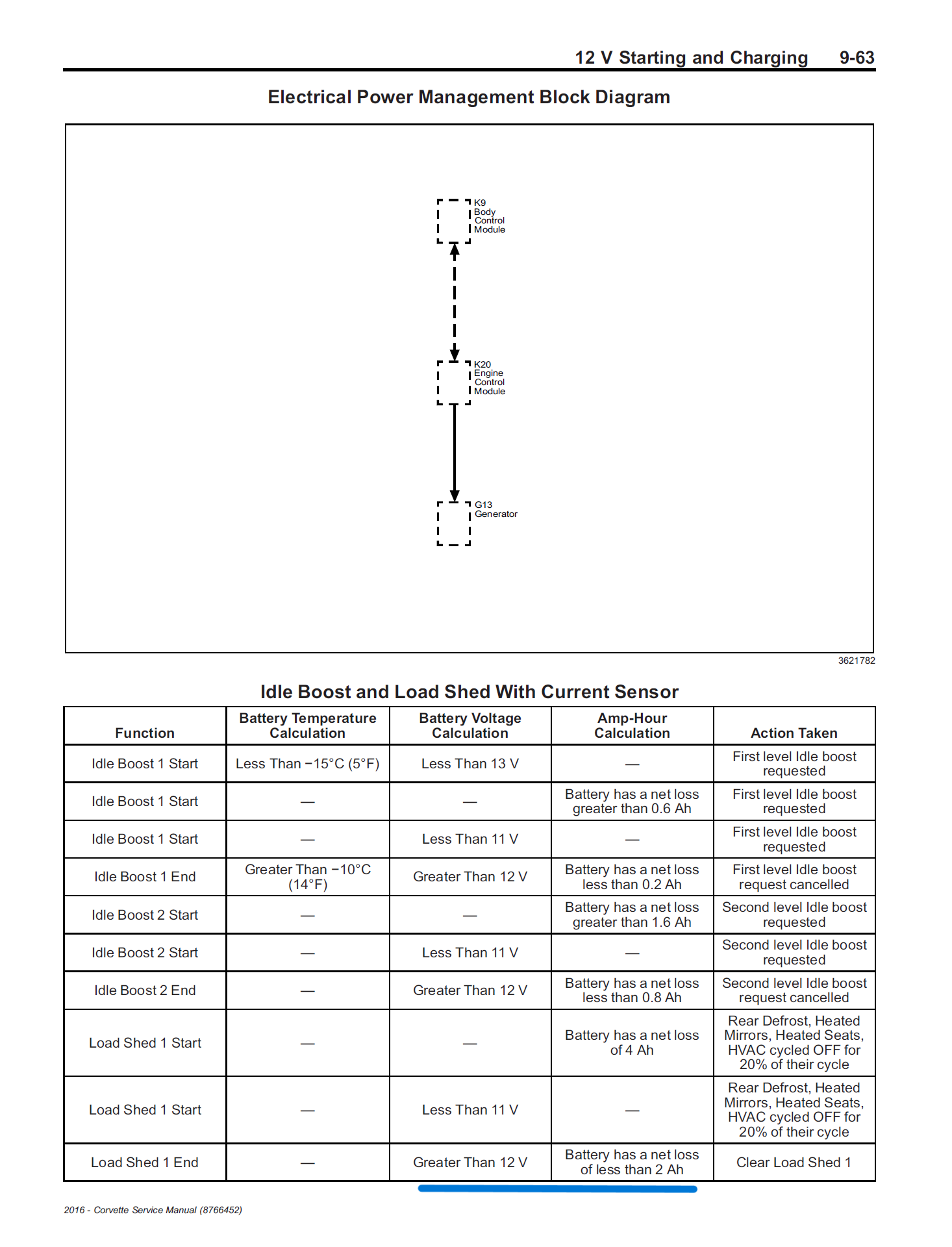

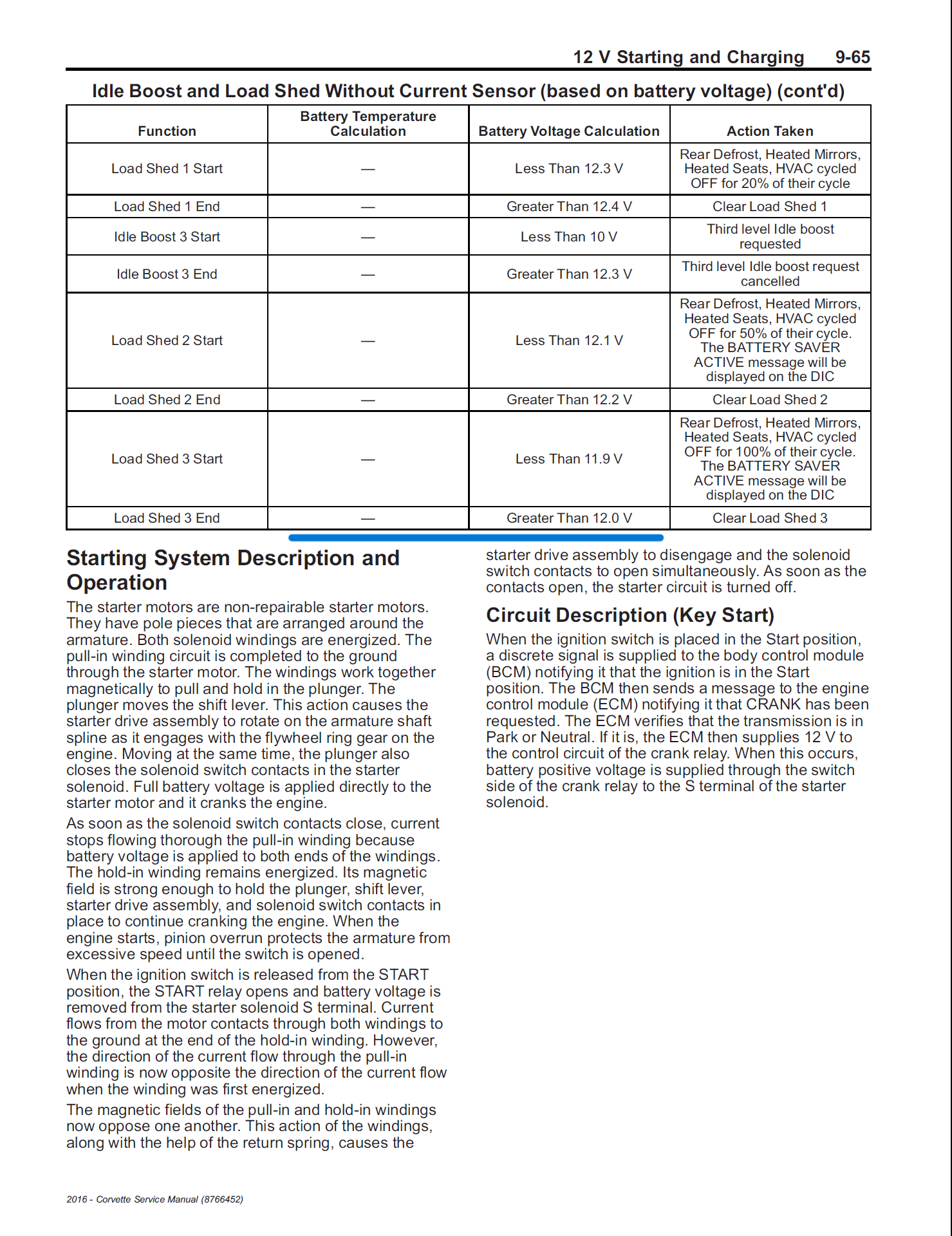

The voltage variation looks normal as it seems to fit how the charging system is supposed to work. I am attaching pages from the FSM describing the battery and charging system operation. I used a blue mark to highlight sections that might be applicable.

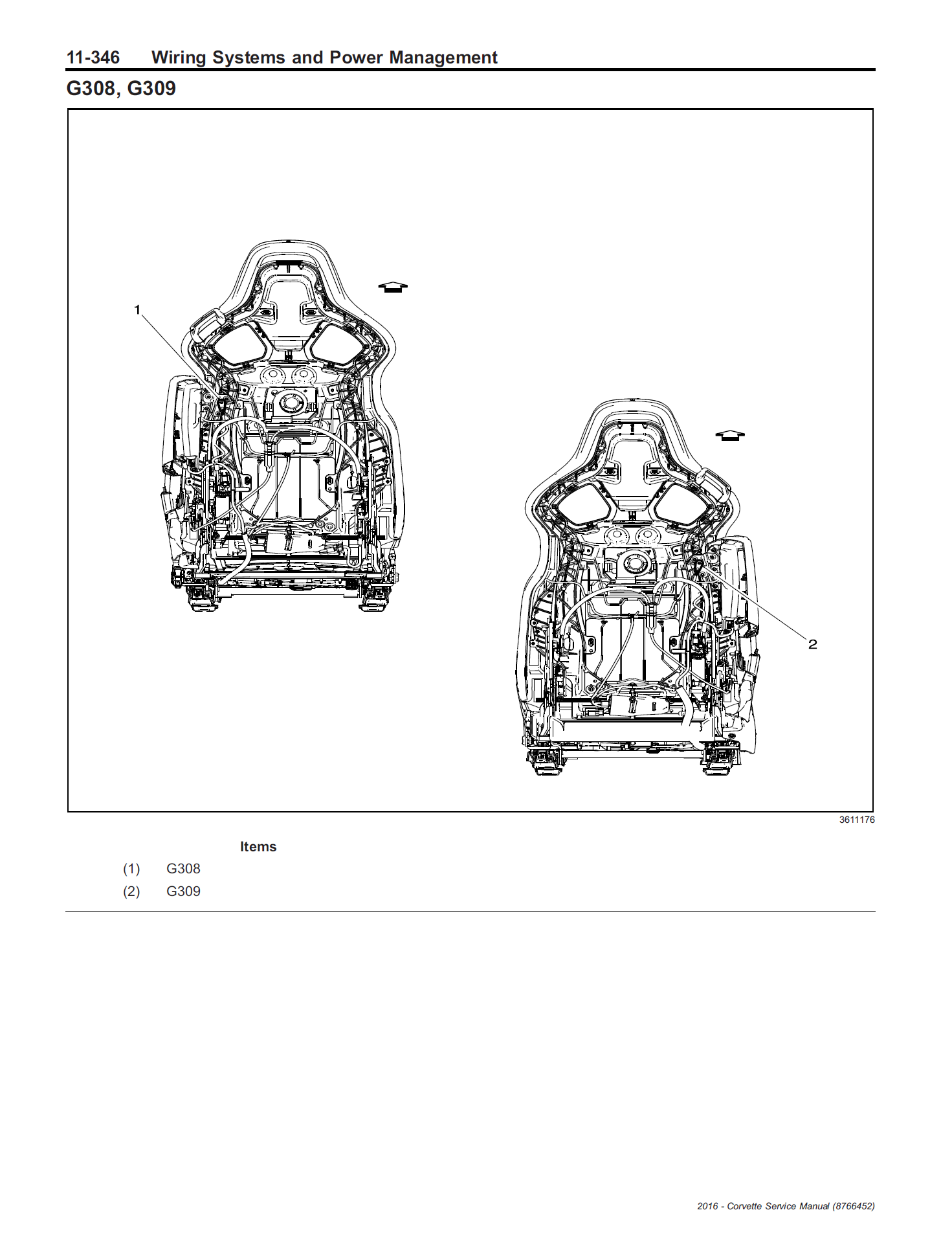

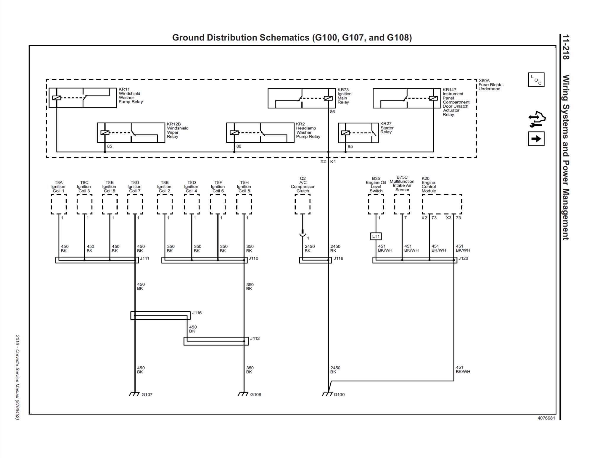

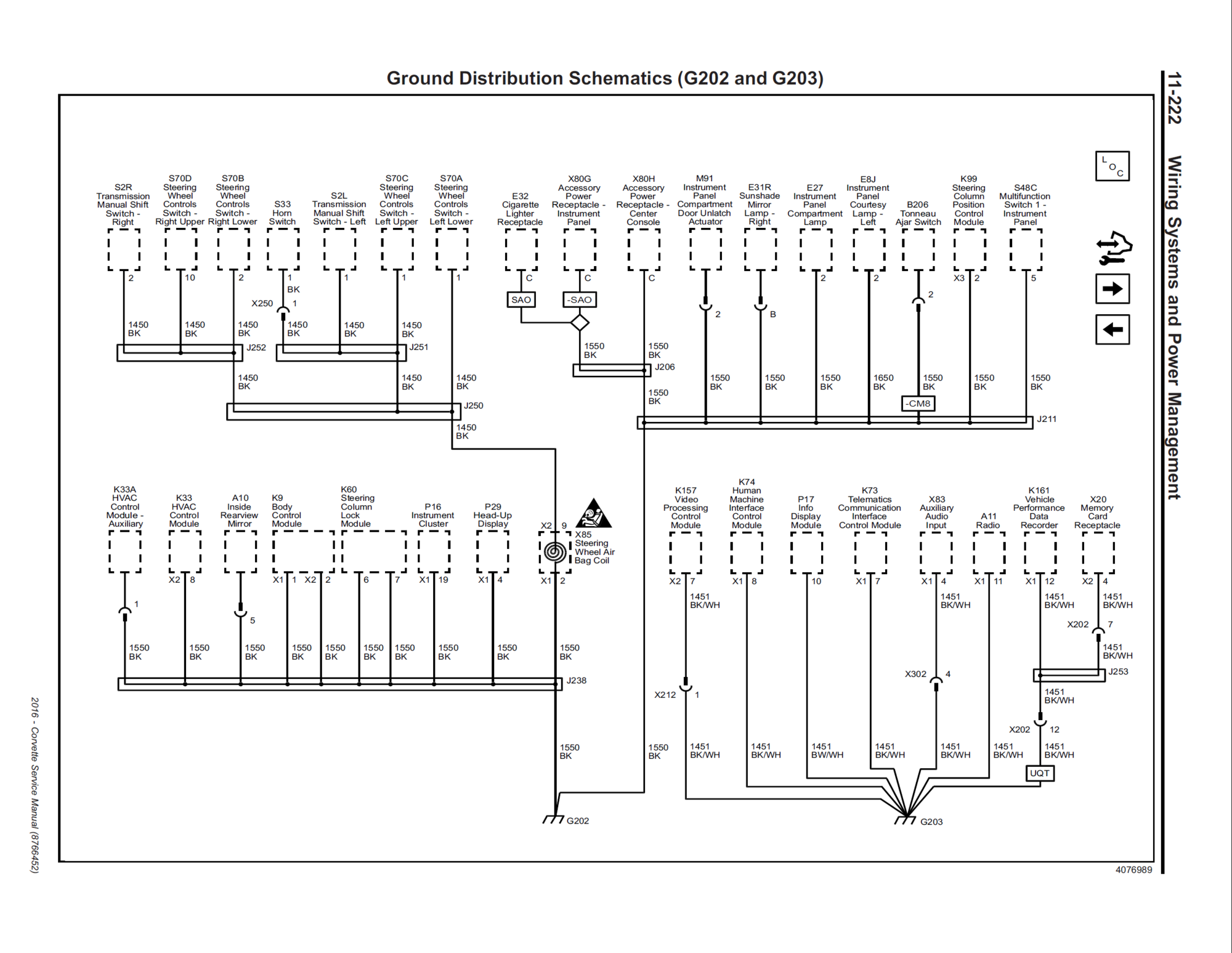

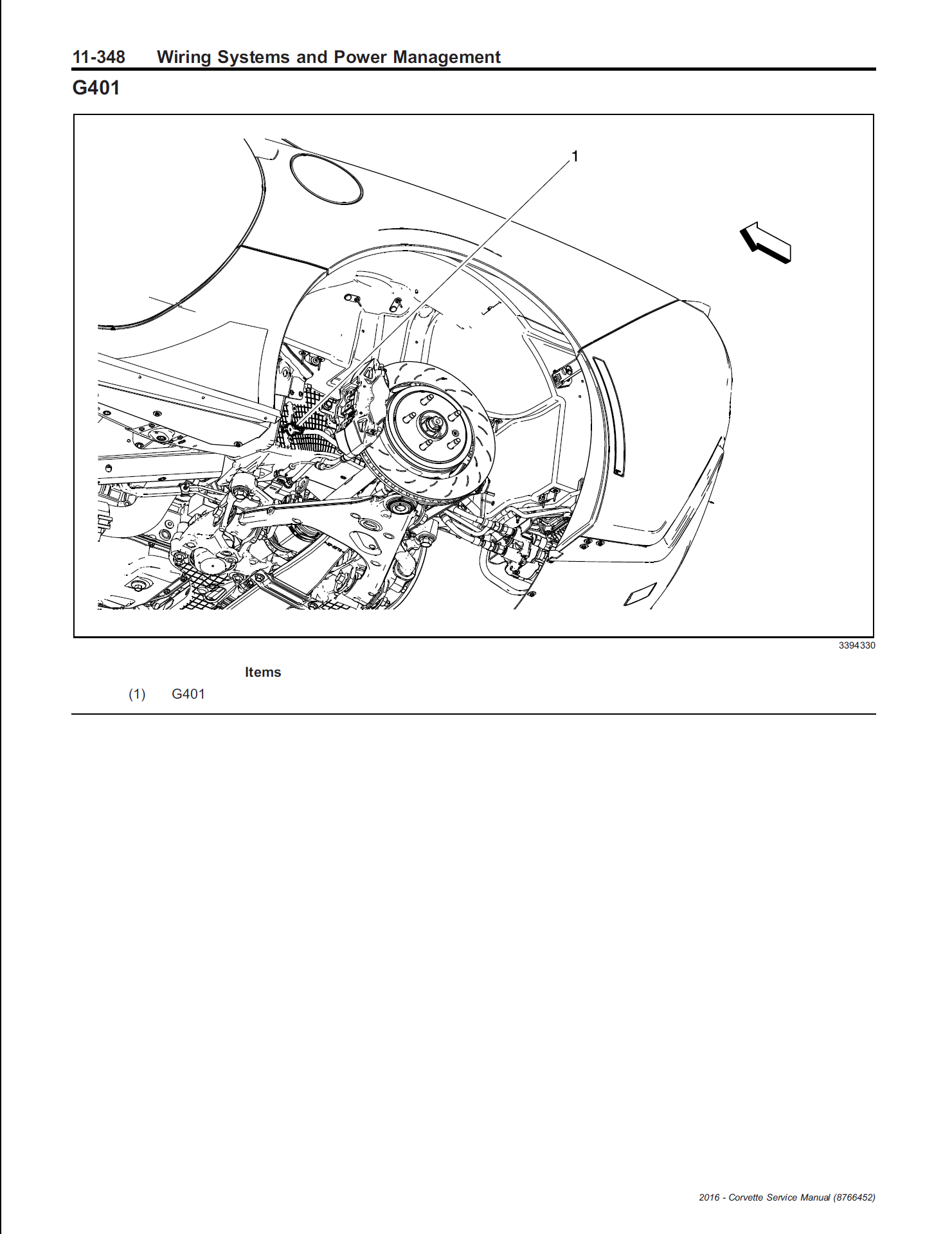

The problem may be somewhere besides the alternator or the battery. Here are the ground points located around the car.
Hope this helps.
Bill
Hope this helps.
Bill
Hey Bill,
thank you sooo much! I am sure that will give me the maximum help I could ever get!
So I will go on search soon.
Frank
