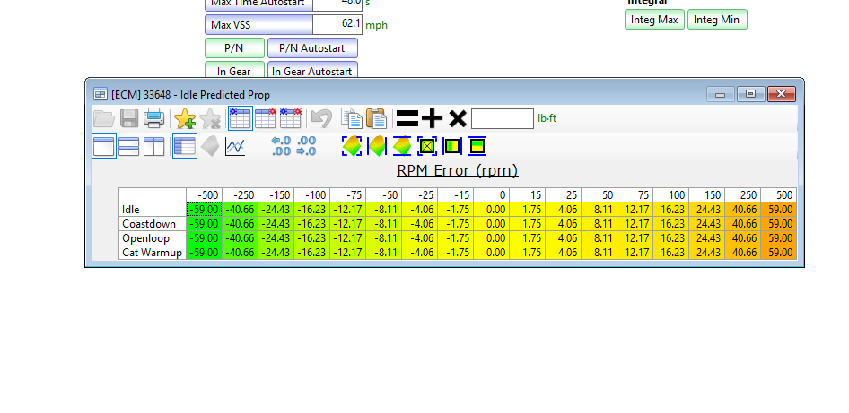

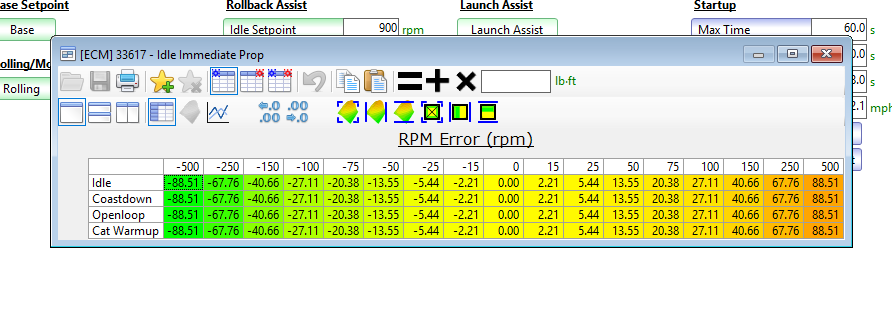

I was over in the HP Tuners forum and there was a thread that was talking idle. I forgot that's changed as well on mine. Here's the post: https://forum.hptuners.com/showthrea...l=1#post814069
In HP Tuners look for the "Idle" tab then "Torque" then look for Idle Torque Limit and below that is "External Load"
As you can see, there's a lot going on with Gen Vs.

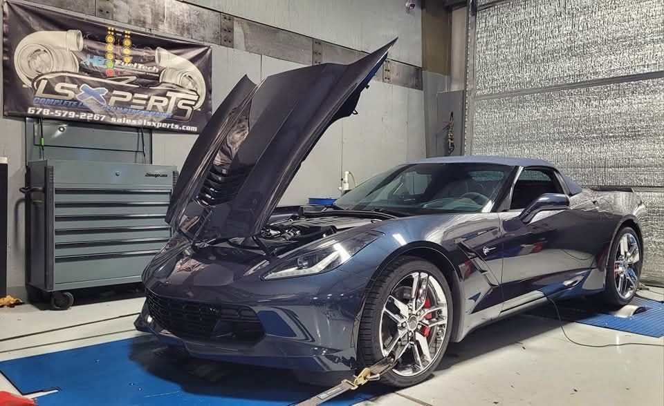

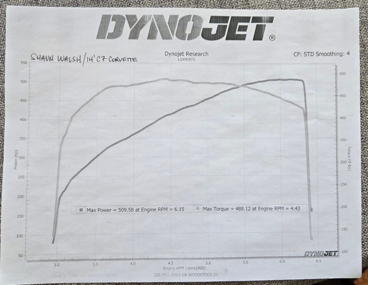

As promised, dyno report! I couldn't be happier... 509HP and 488tq!
