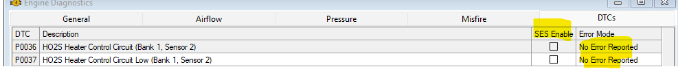

Any cheap OBD code checker can clear them. Based on your other post, as soon as the PCM runs the O2 test and it doesn't see the aft O2 sensors, the code will just set again. Since there's no CEL it's likely the tuner forgot to turn off the test.
This is stock....
This is with them turned off in the tune and no Check Engine Light....
This is what the Tuner likely did....

  • The other codes are not being thrown because they were tuned out. As shown previously, I'm pretty sure the Tuner made an error and forgot to turn off the tests that throw the codes you currently have. The Tuner only turned off the CEL

As mentioned above, I doubt you have aft o2 sensors installed ergo there is nothing to replace. The Tuner failed to turn off the test routine in the software. In addition, there will be no sensor bungs after the high-flow cats to install the sensors into and the factory wiring harness will be too short to reach the sensors if you add bungs into the exhaust pipe so you will also need wiring harness extensions. After you do all this, the car still fails the CA visual inspection and it fails due to the tune unless you have that reflashed to stock as I've said before.
