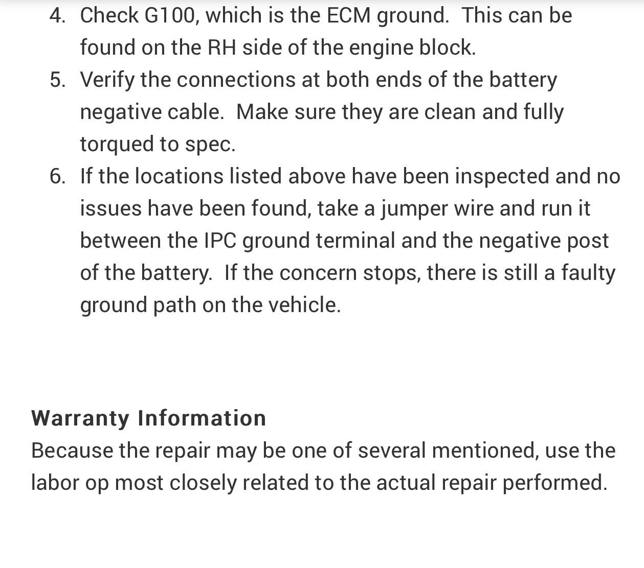

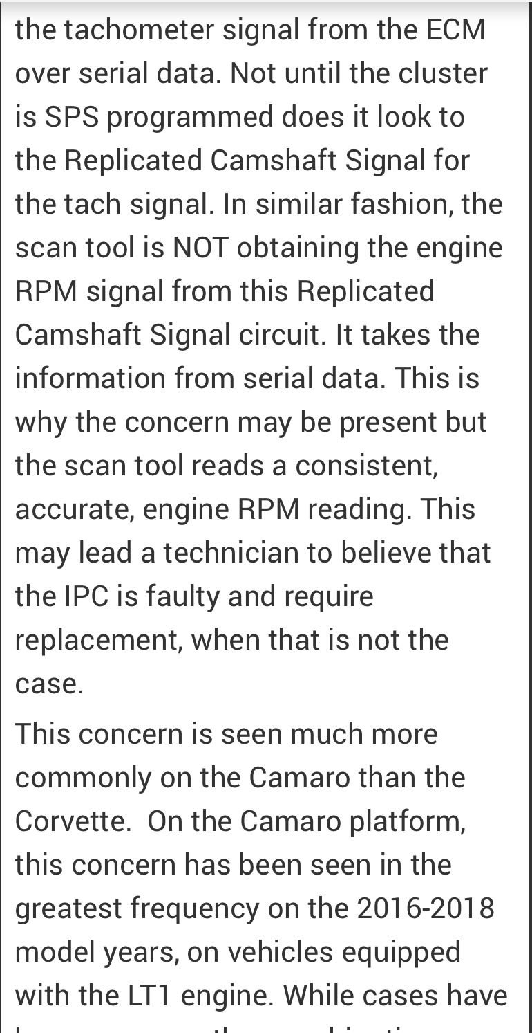

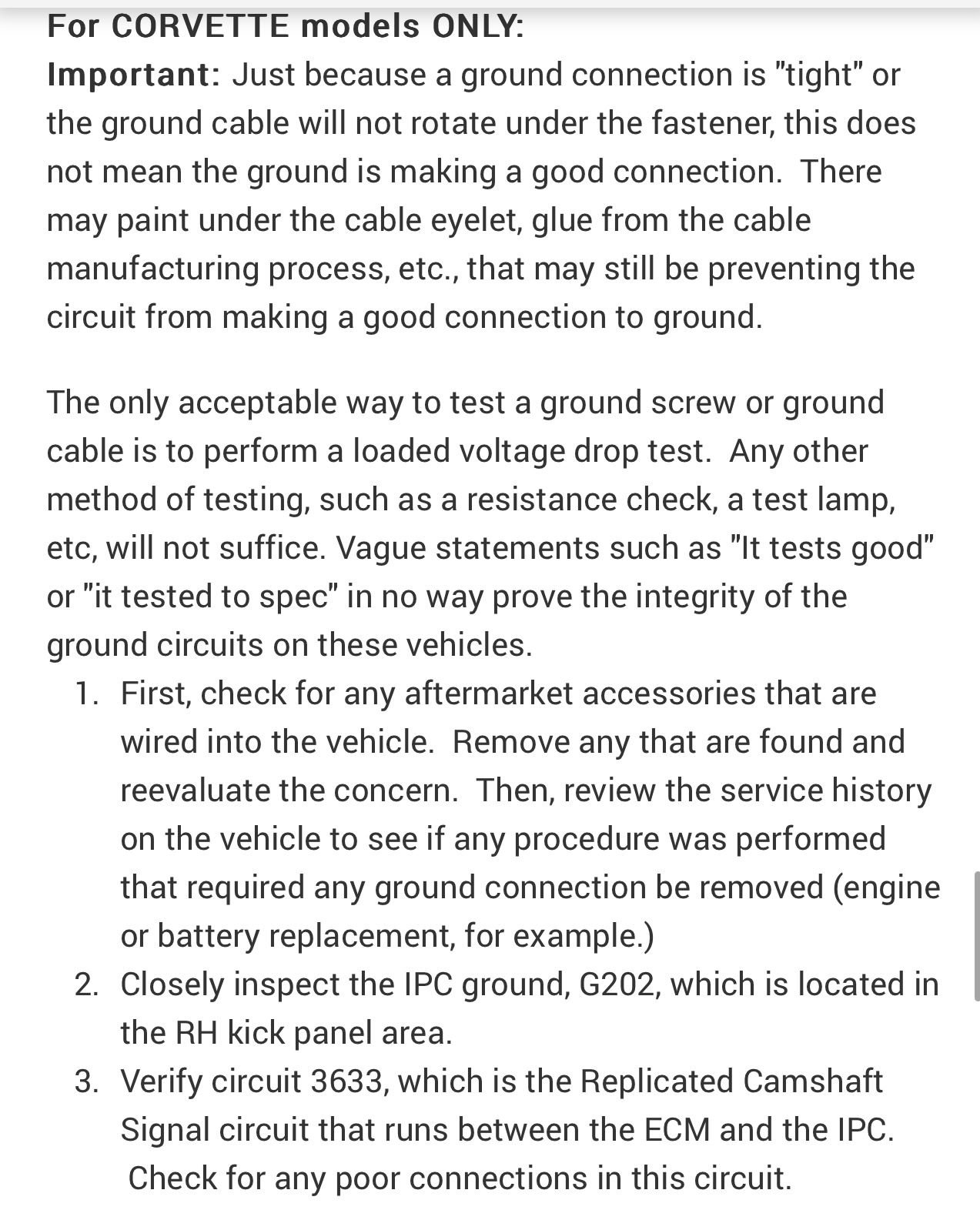

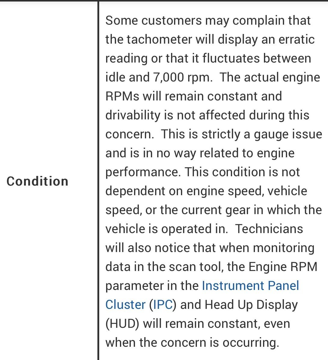

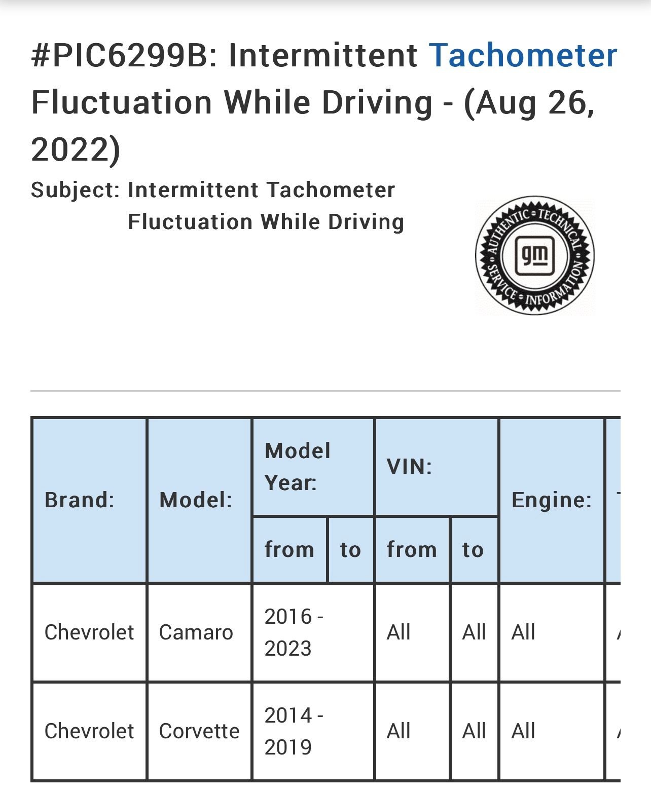

Don’t know if this is the exact cause of your concern but this TSB may help wherever you have your car serviced…most shops don’t read these so you might want to point it out to them.
