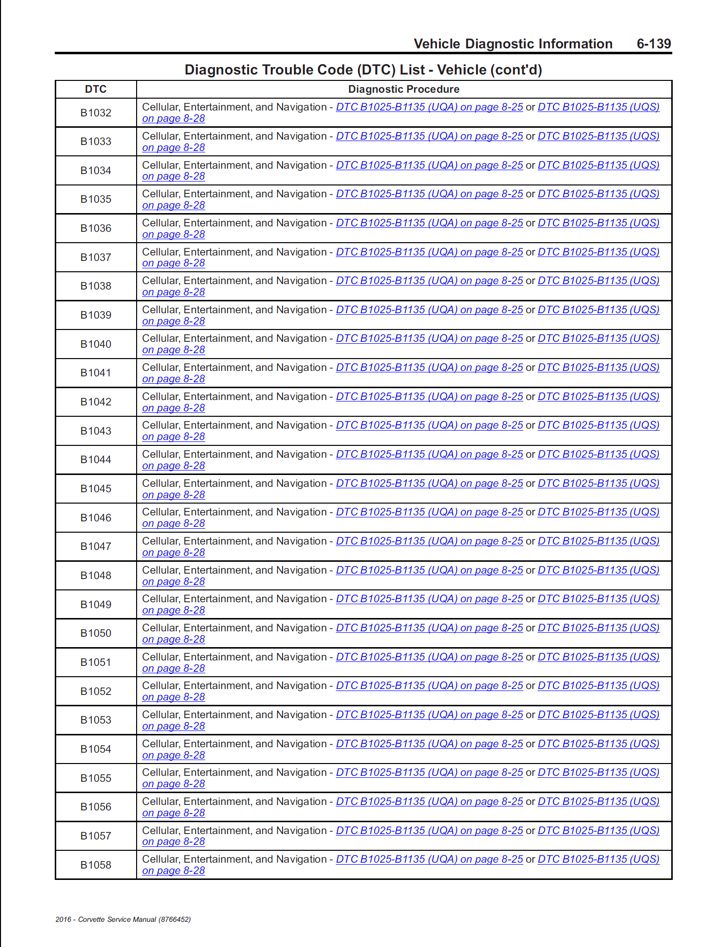

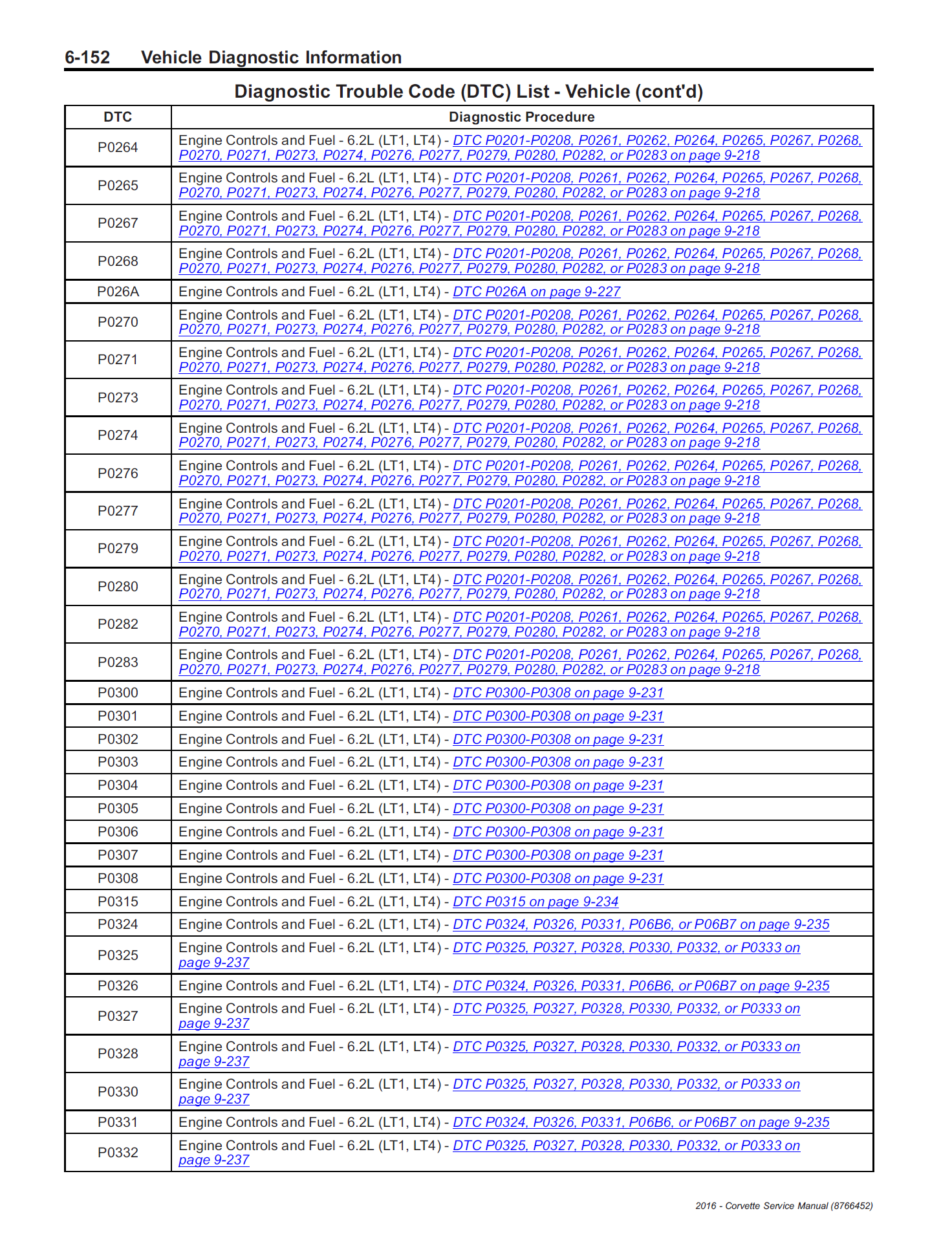

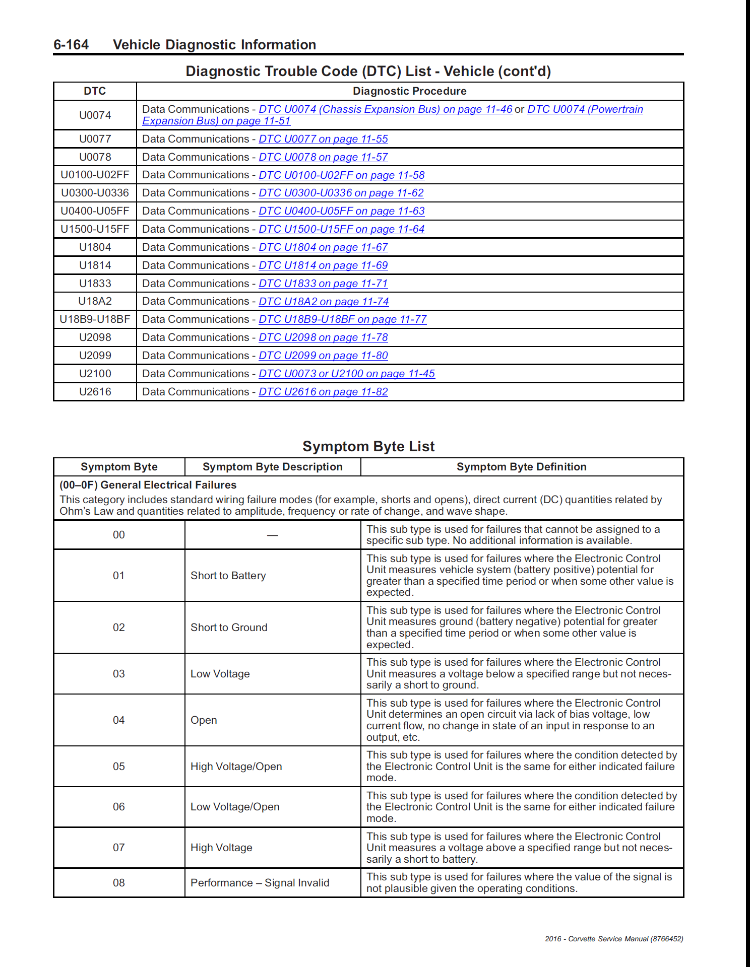

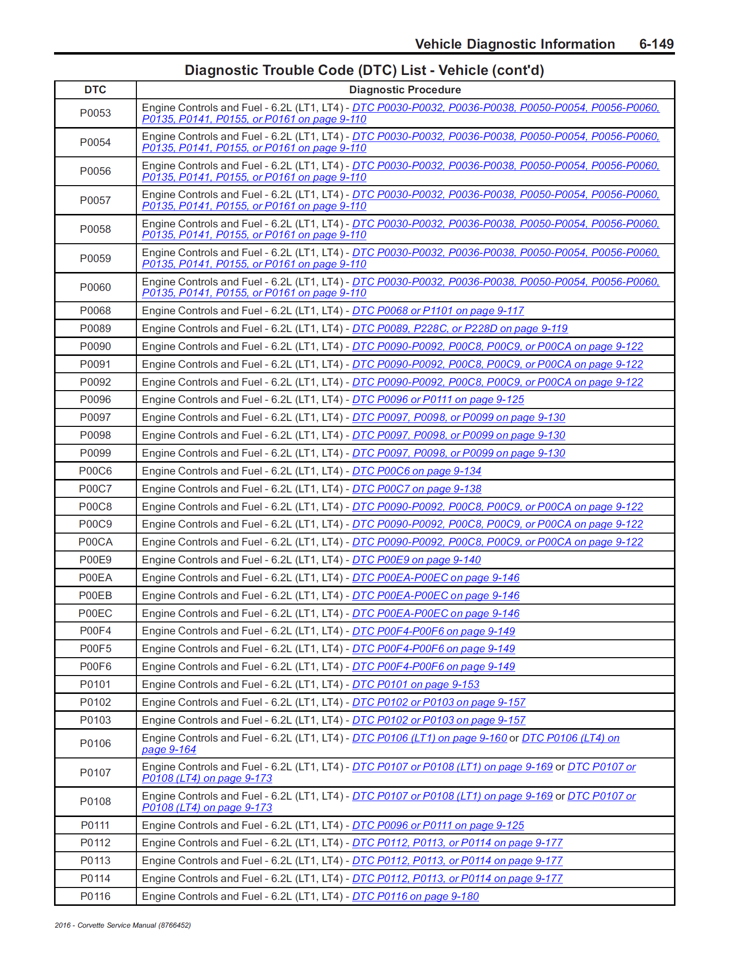

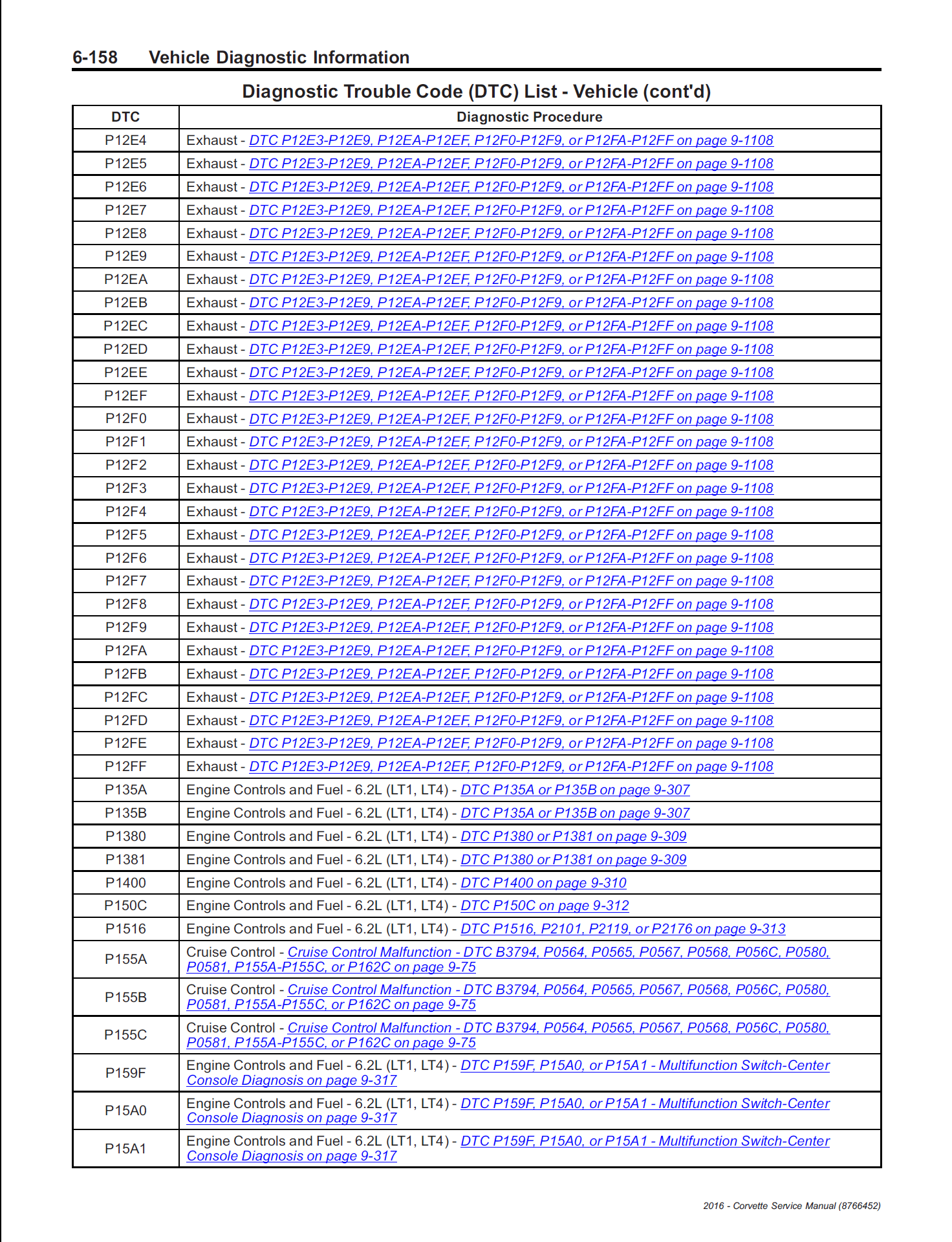

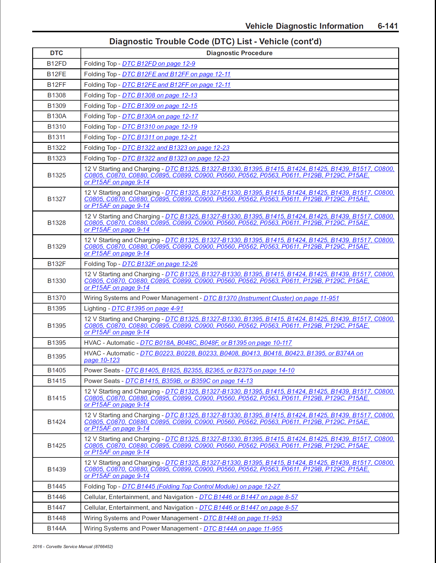

Bill Dearborn's Avatar
Bill Dearborn
Joined: Oct 1999
Posts: 41,058
Likes: 9,820

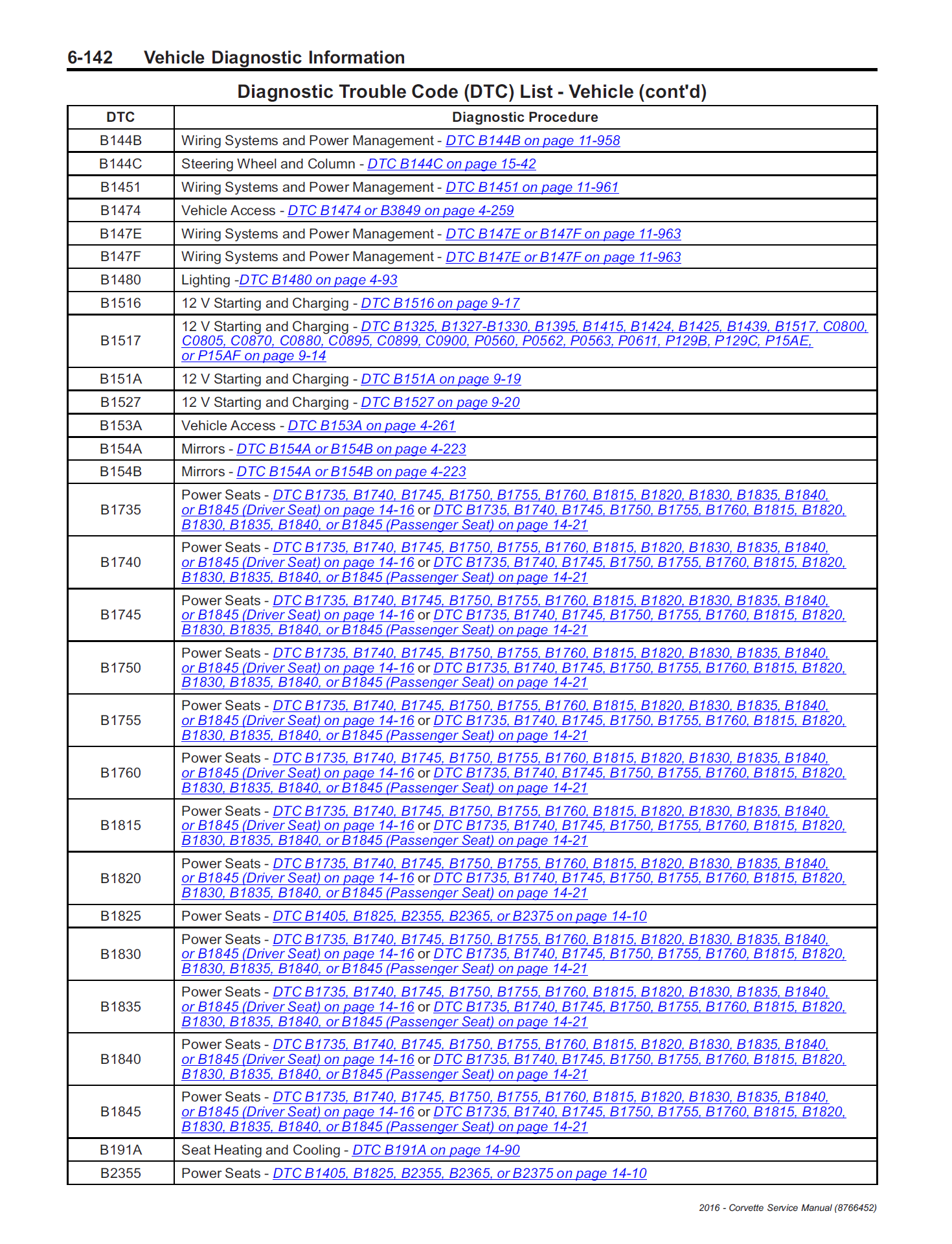

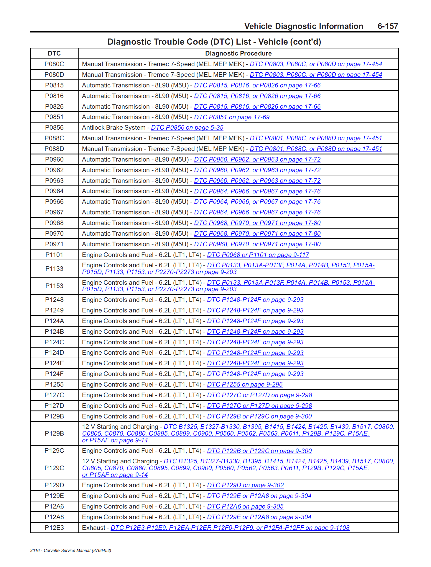

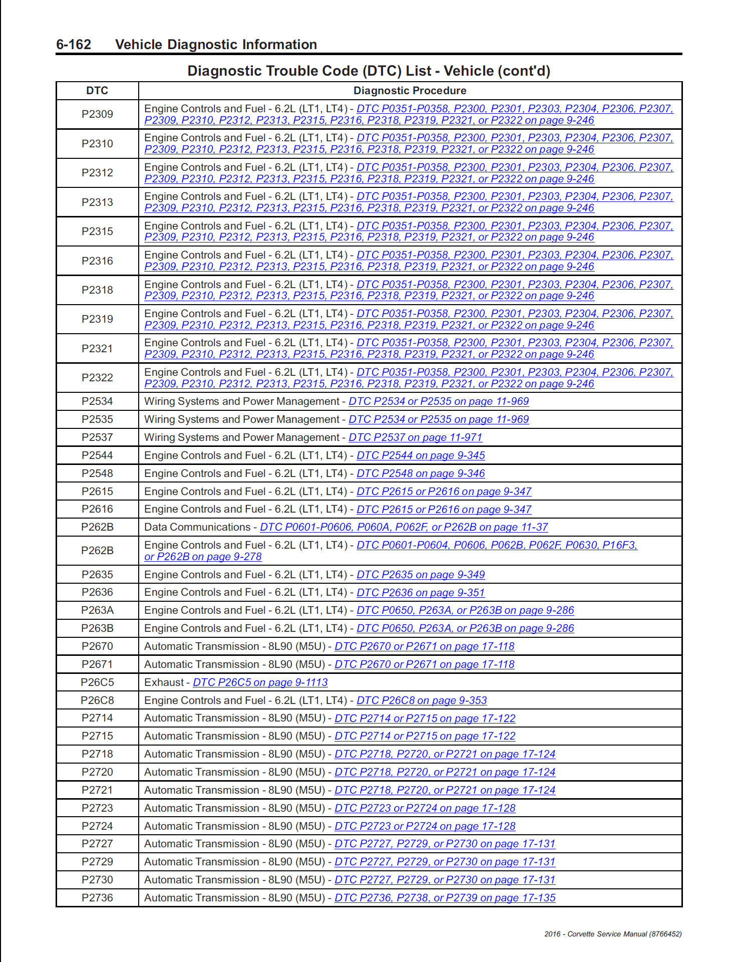

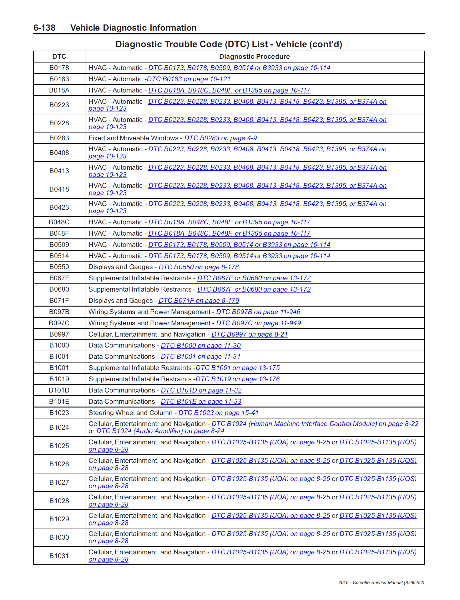

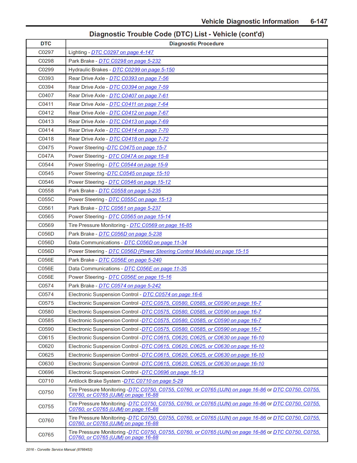

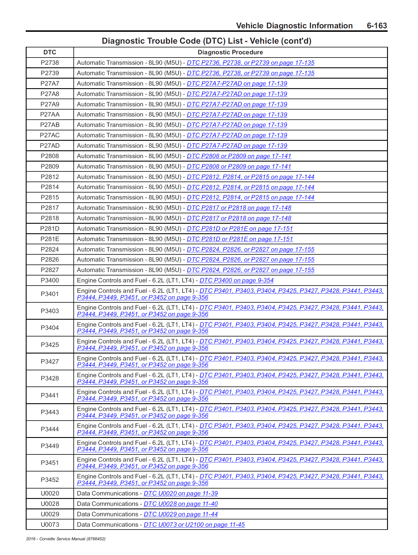

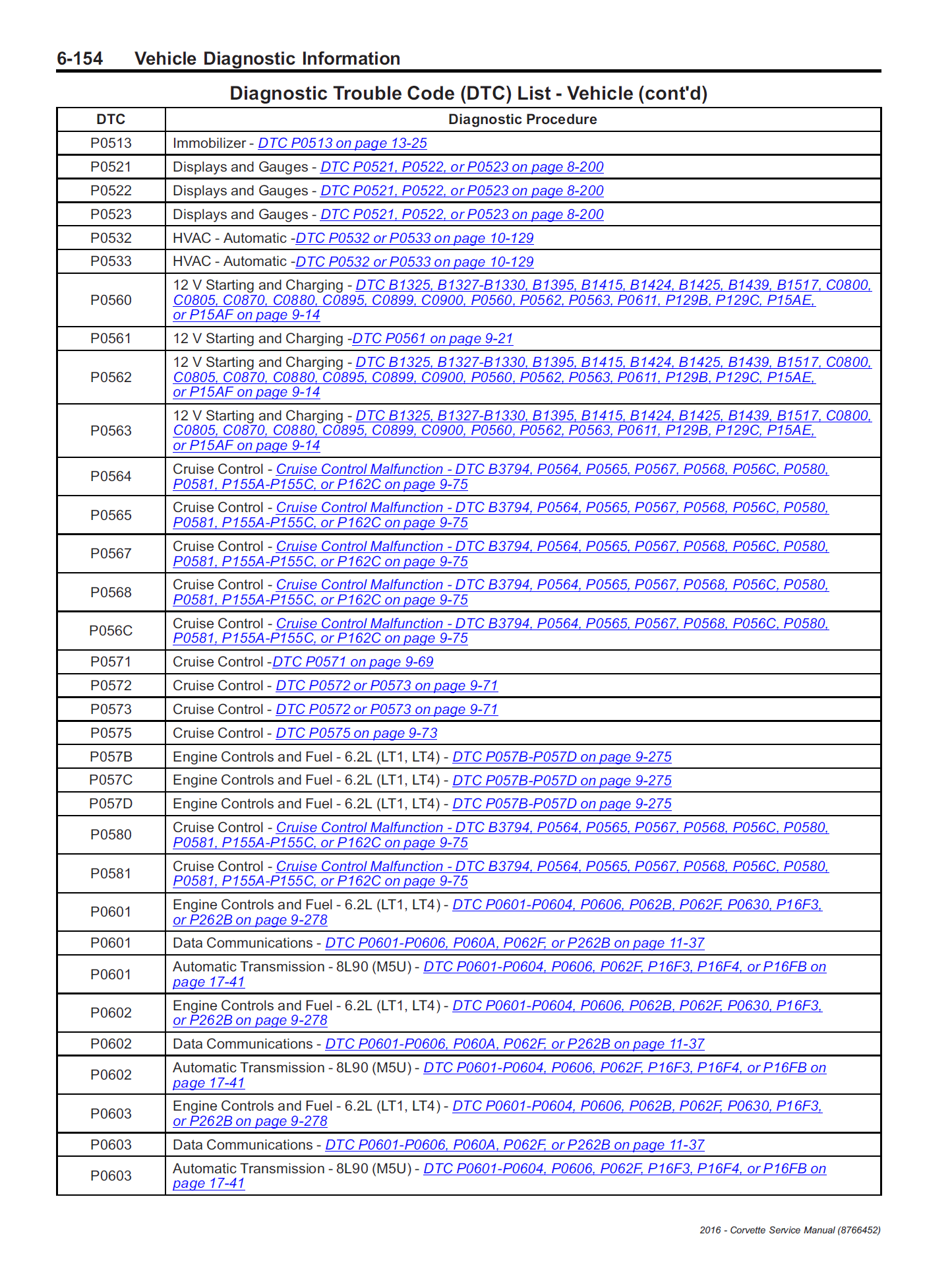

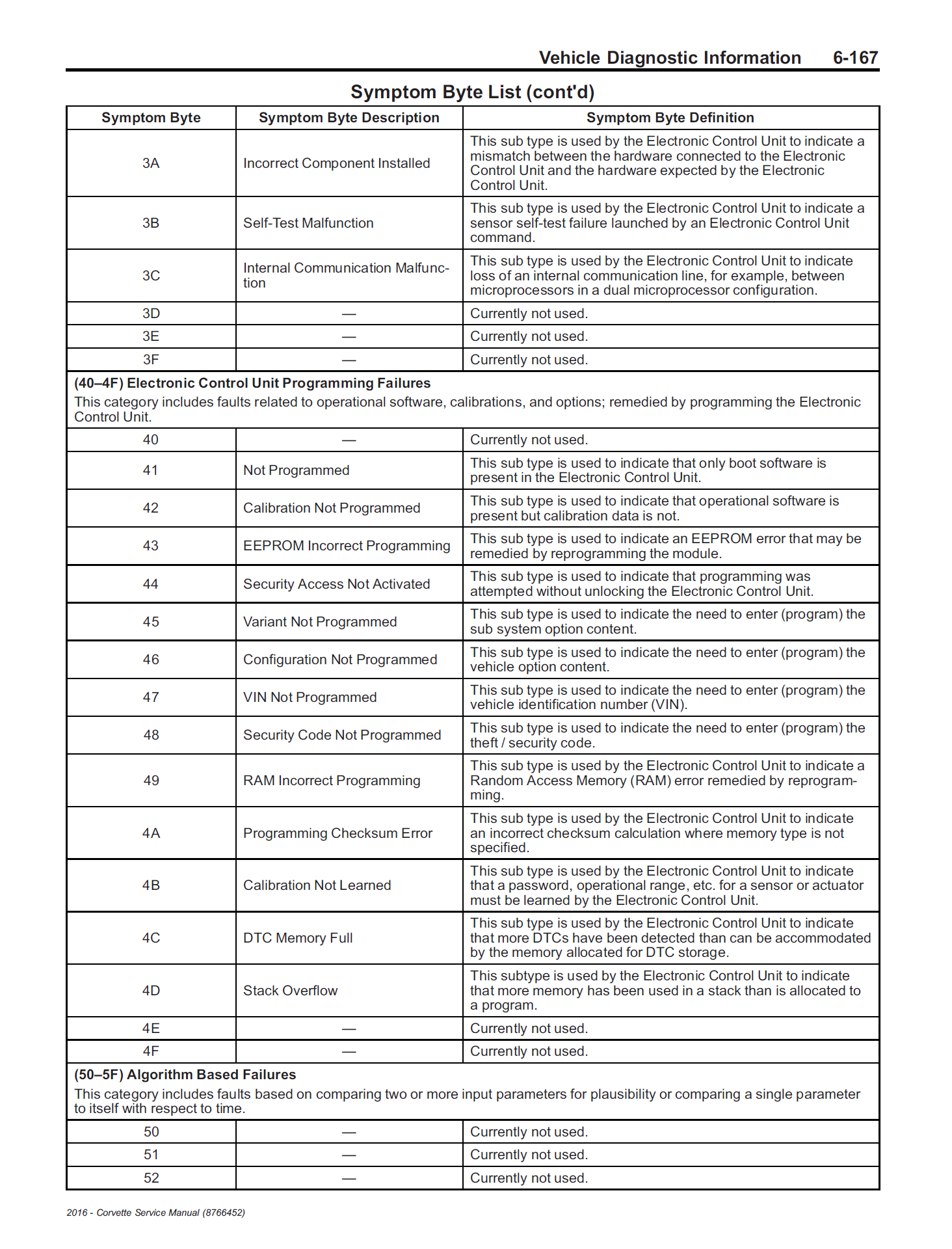

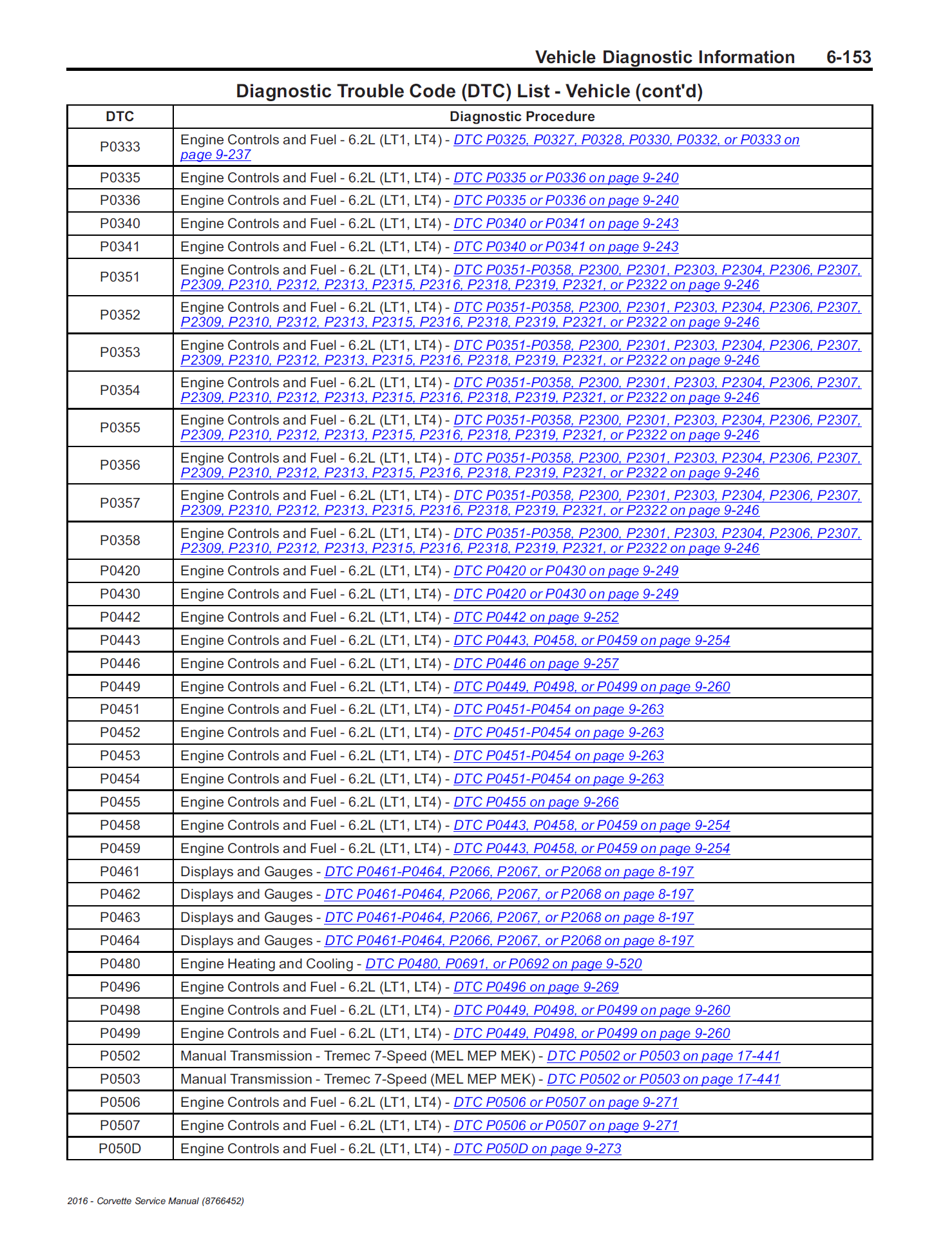

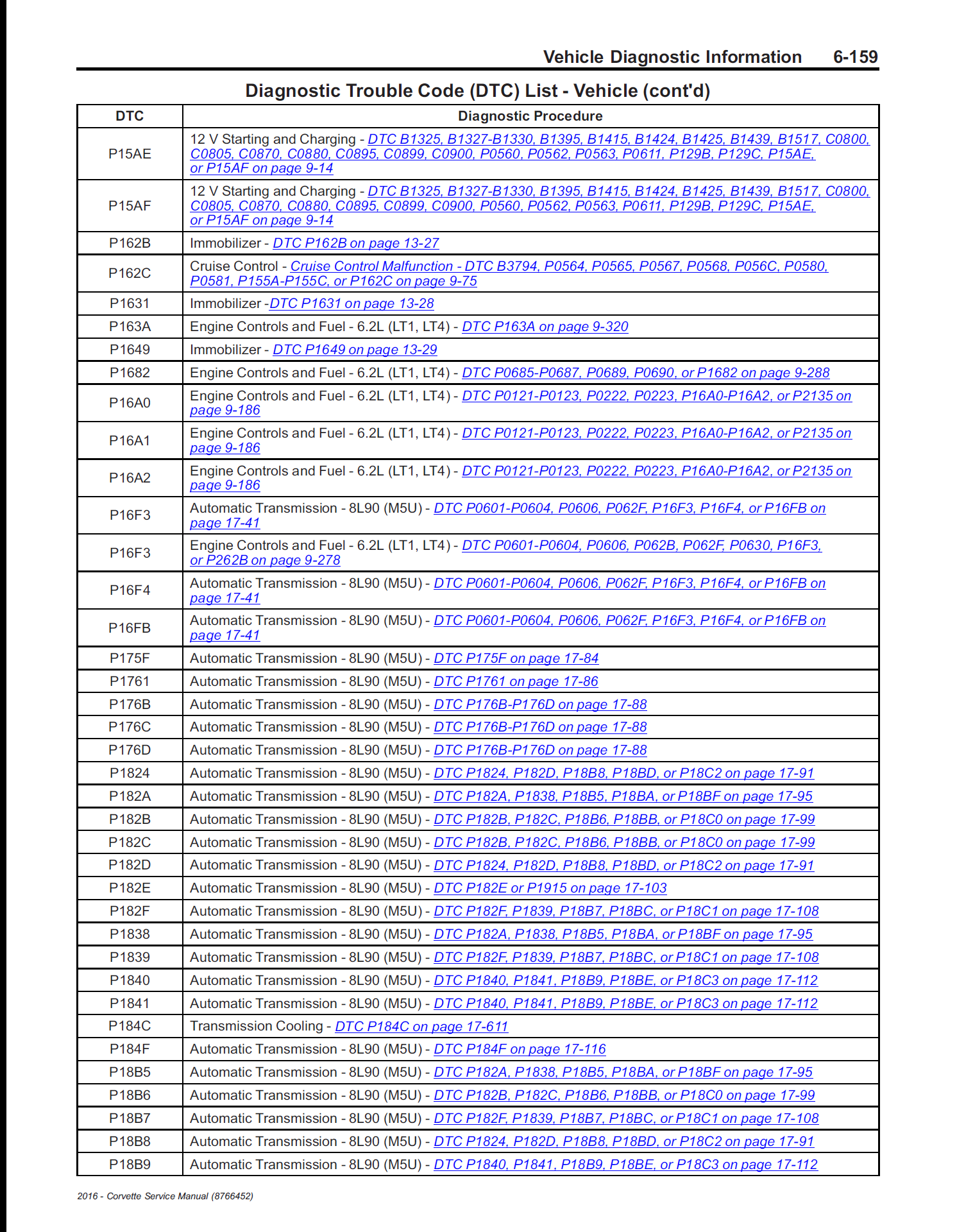

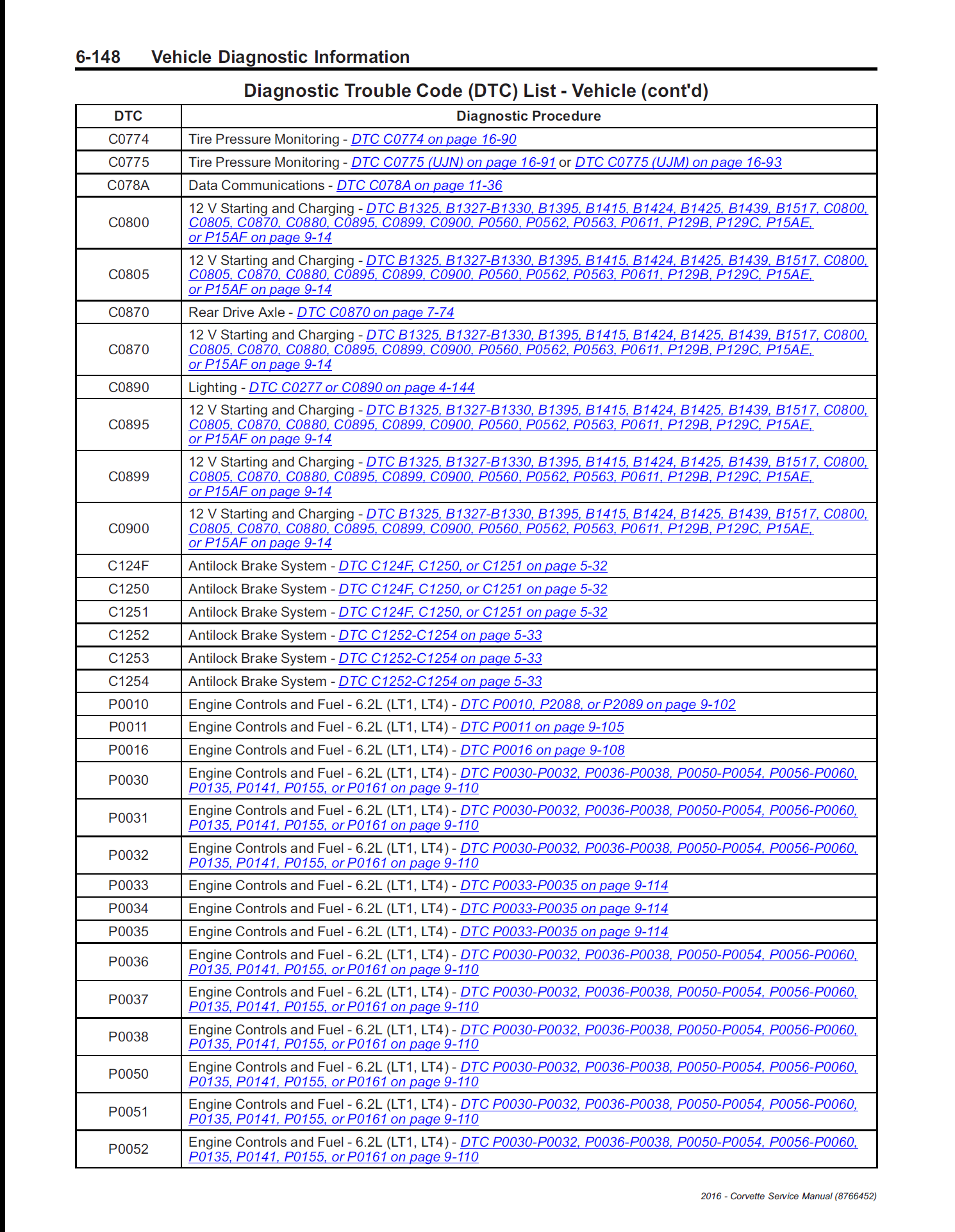

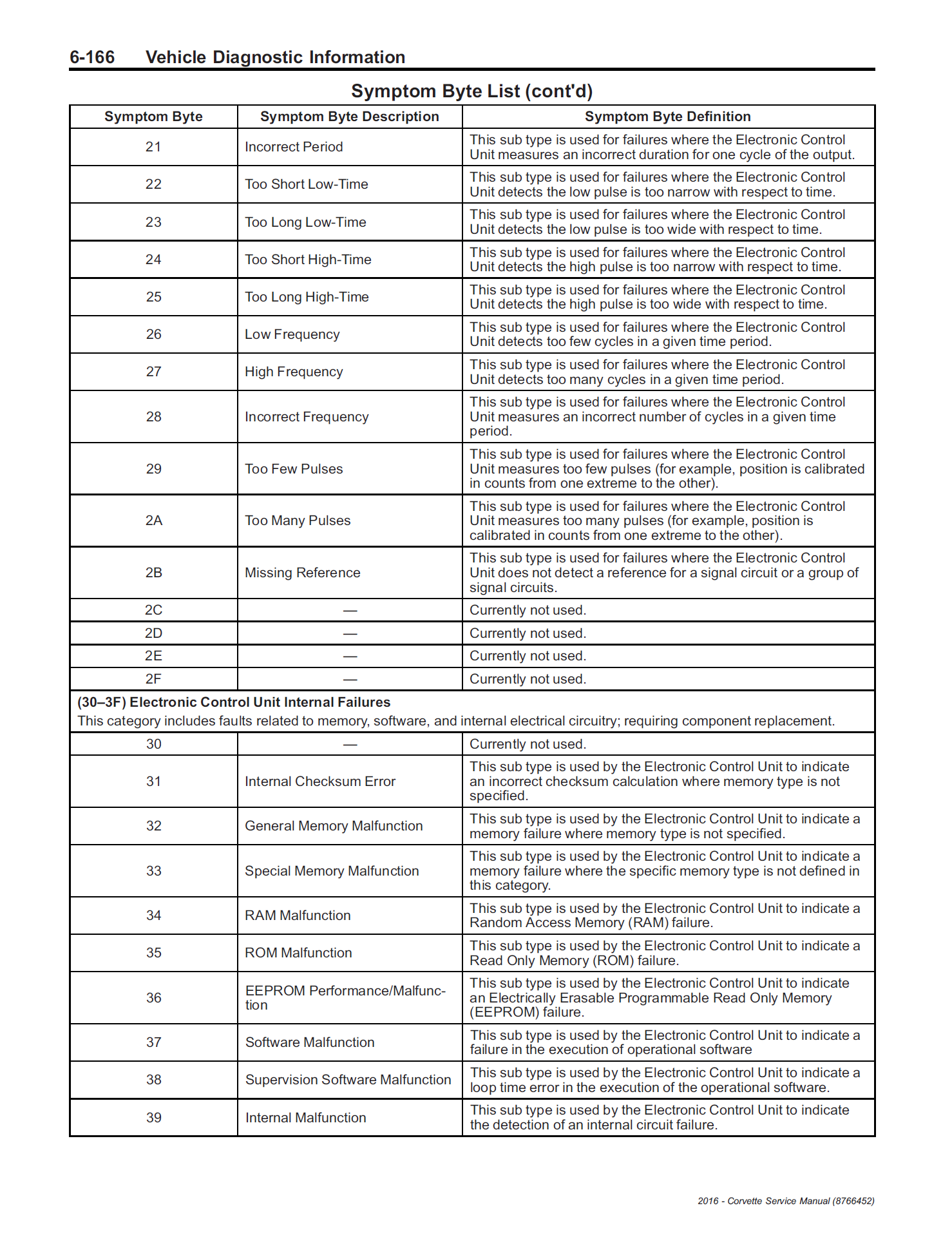

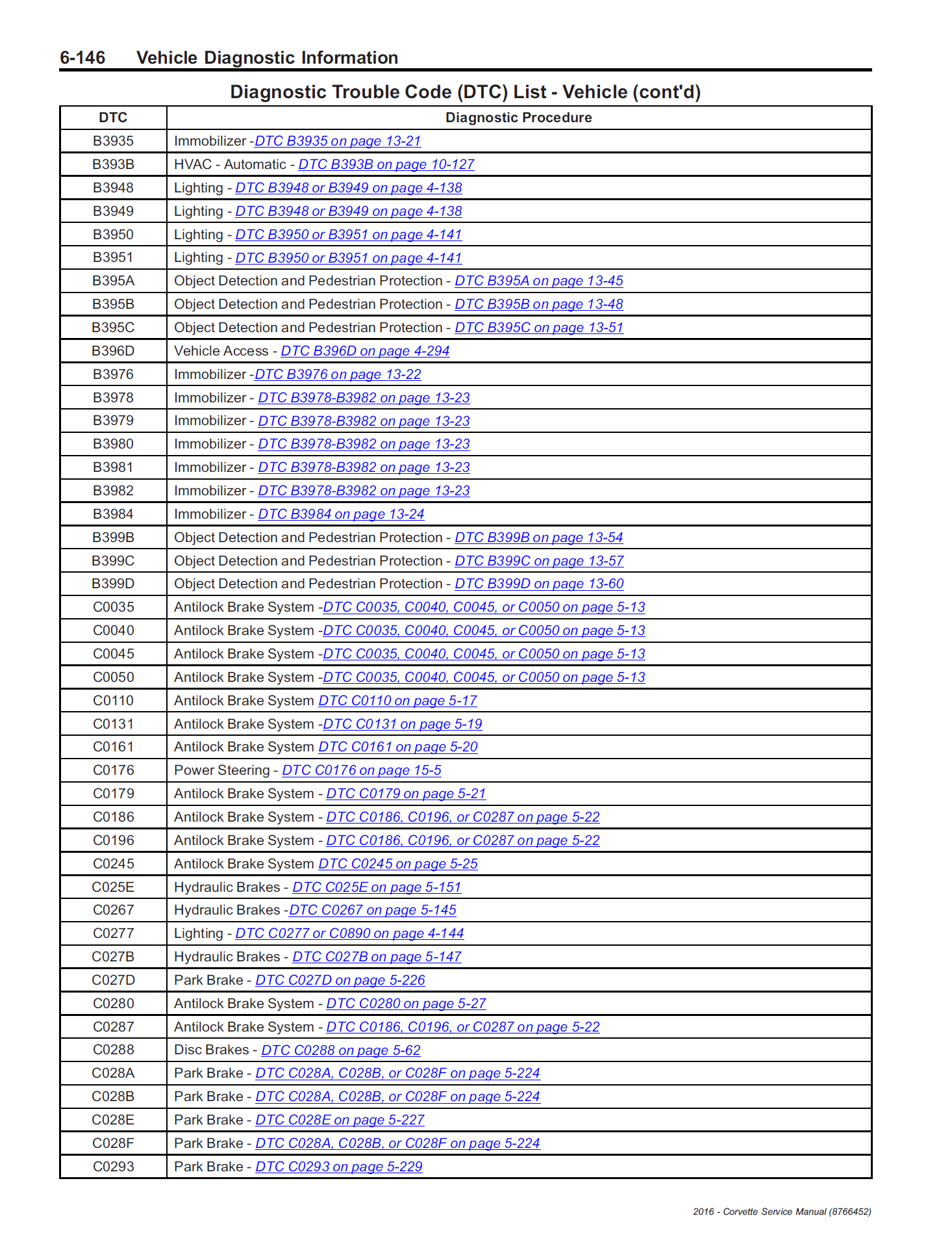

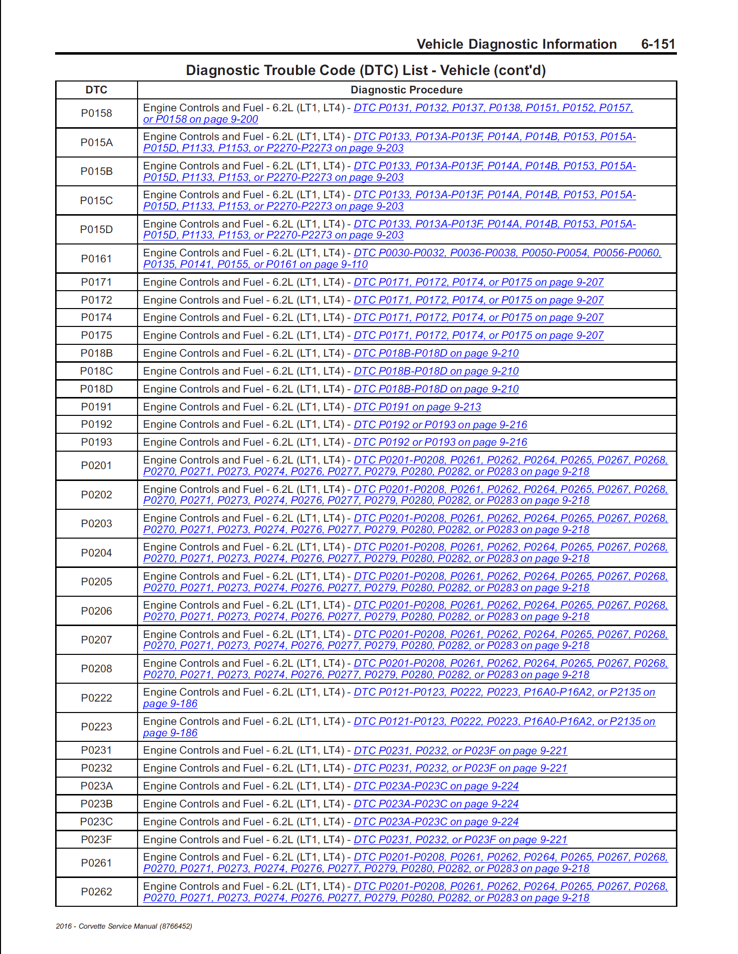

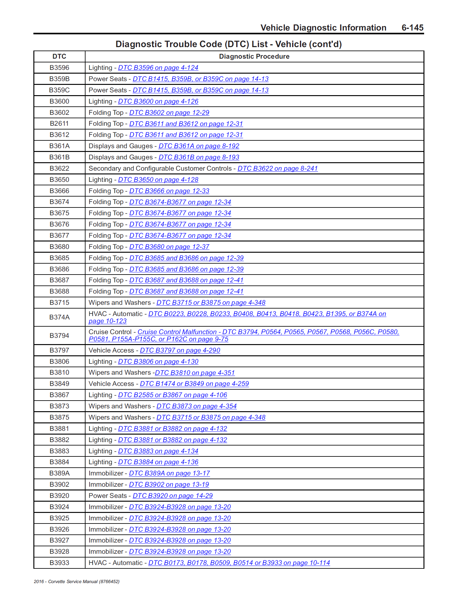

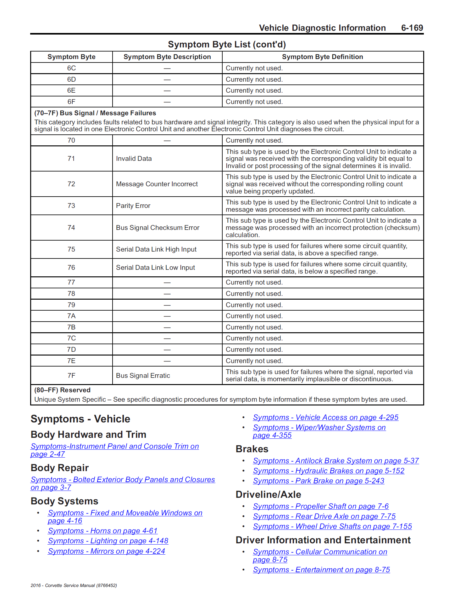

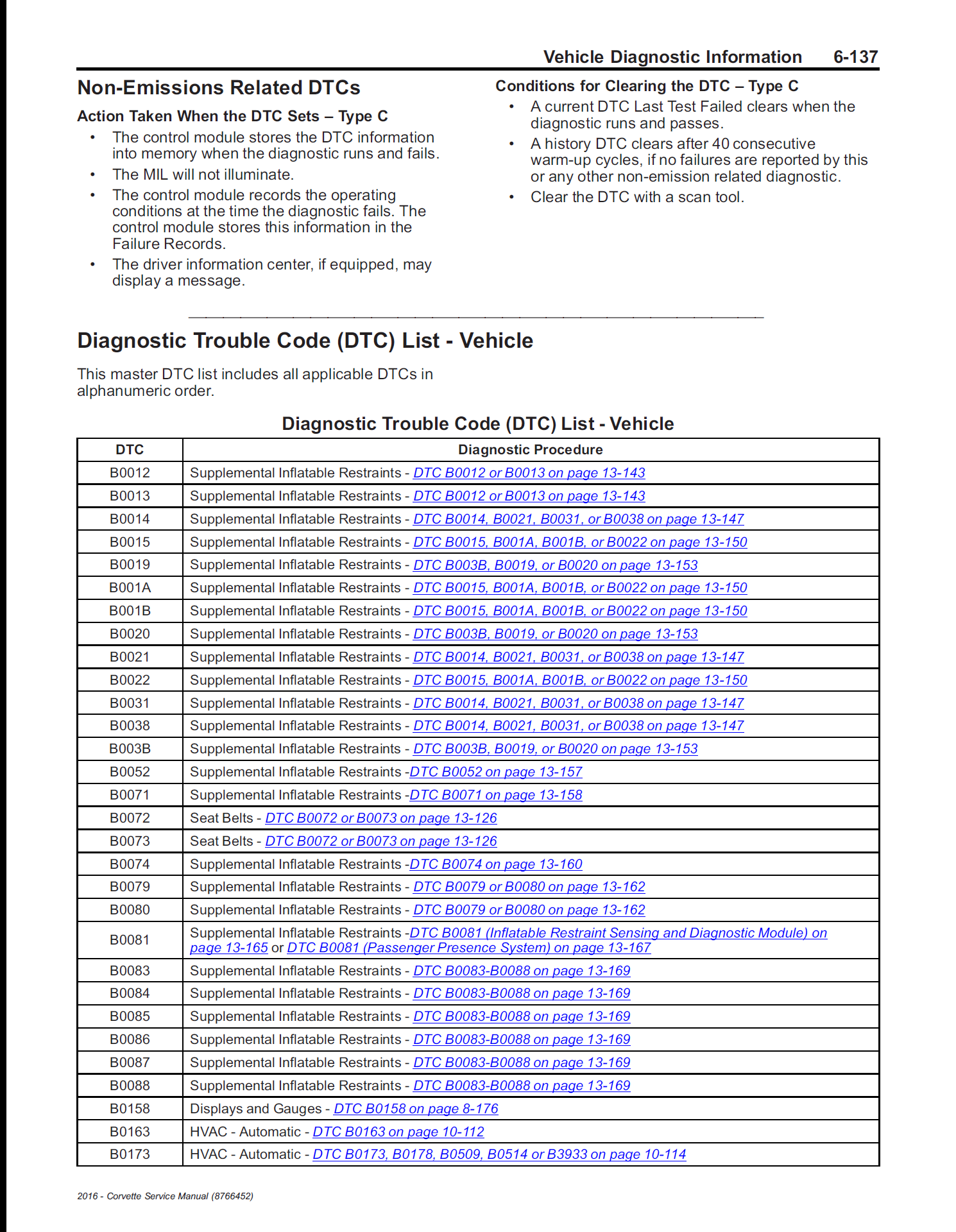

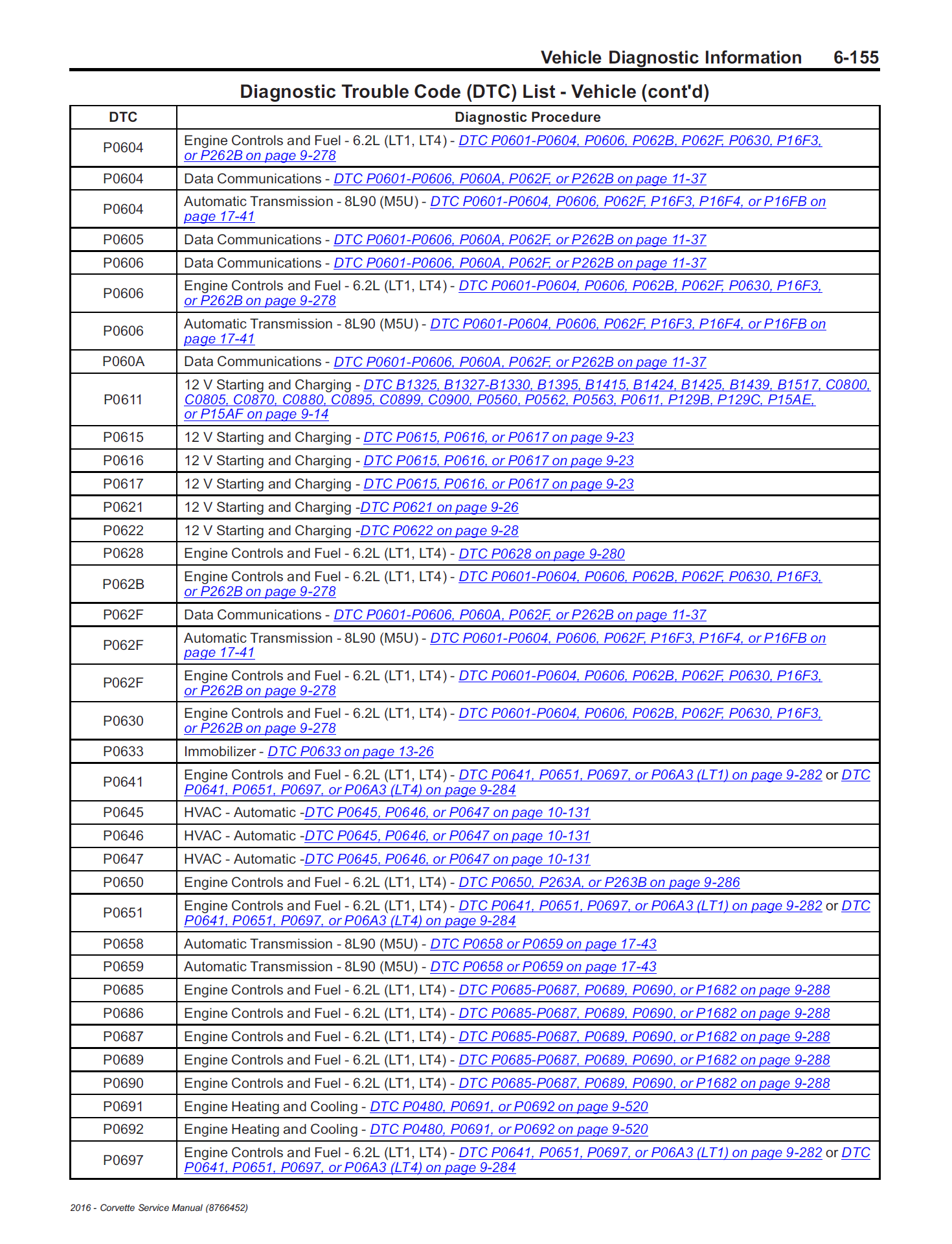

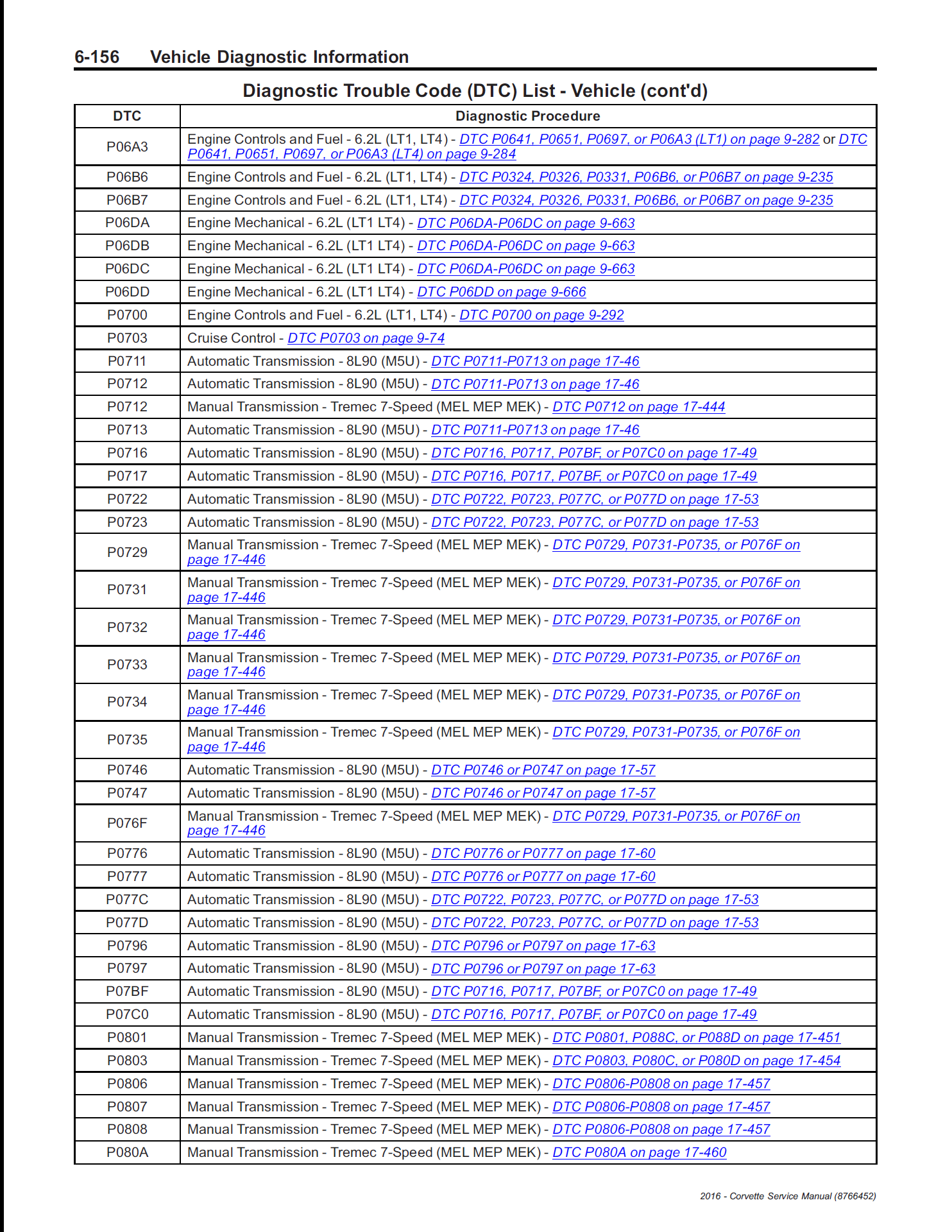

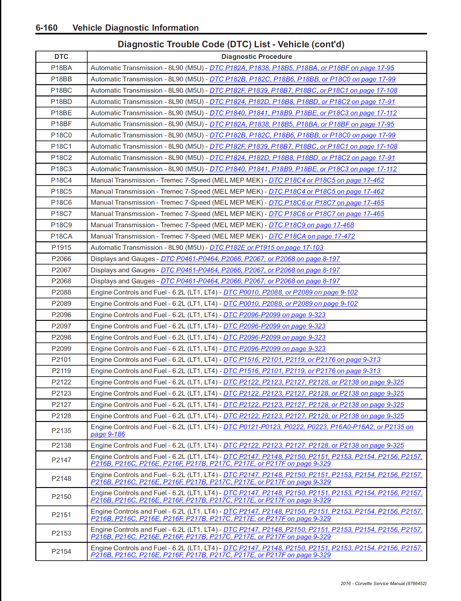

I searched my FSM and didn't find any of those codes, you may want to recheck them. Here is the list of codes for the 2016 model year. Most or maybe all of them will apply to the other years since there were few changes other than added features from 2014 through 2019.
Bill
To C7 Diagnostic Codes
